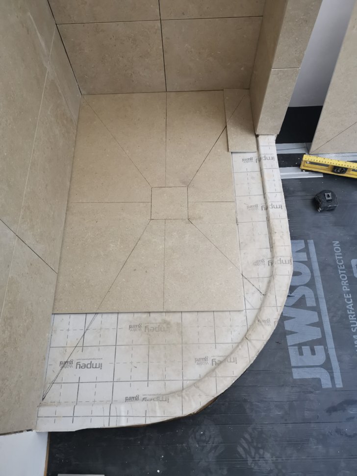

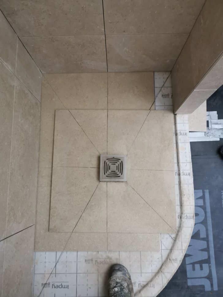

Hi All,
I've not been doing this for too long, so still a little unsure in a lot of things! Was on Ana architect lead job last week into this coming week and would appreciate your opinions on the setting out of this shower former.
One option is mine, one is the architects, so which is best? I'll not say which is which. Just picture 1 and picture 2 (ignore the tiles underneath this image) Better than that though, what would you have done completely differently? I think what I'll end up with will be nice but am also sure it could be much better both for the finished looked and for the time and effort it might save me!
Cheers all
[automerge]1579985971[/automerge]
Hi All,
Cheers all
Sorry just to be clear, the tiles in picture 1 are not fixed in place. So could end up as picture 2 if needs be, everything on the floor is dry laid only
