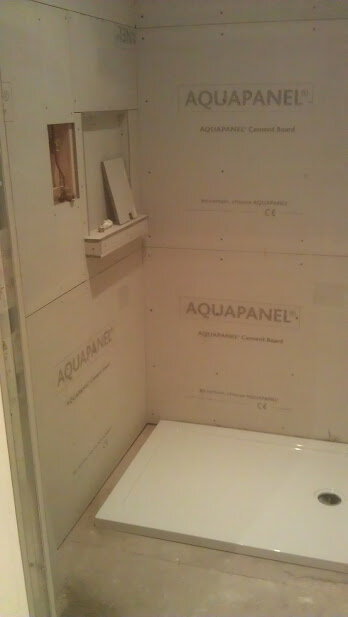

Got any pictures? It may inspire an alternative.

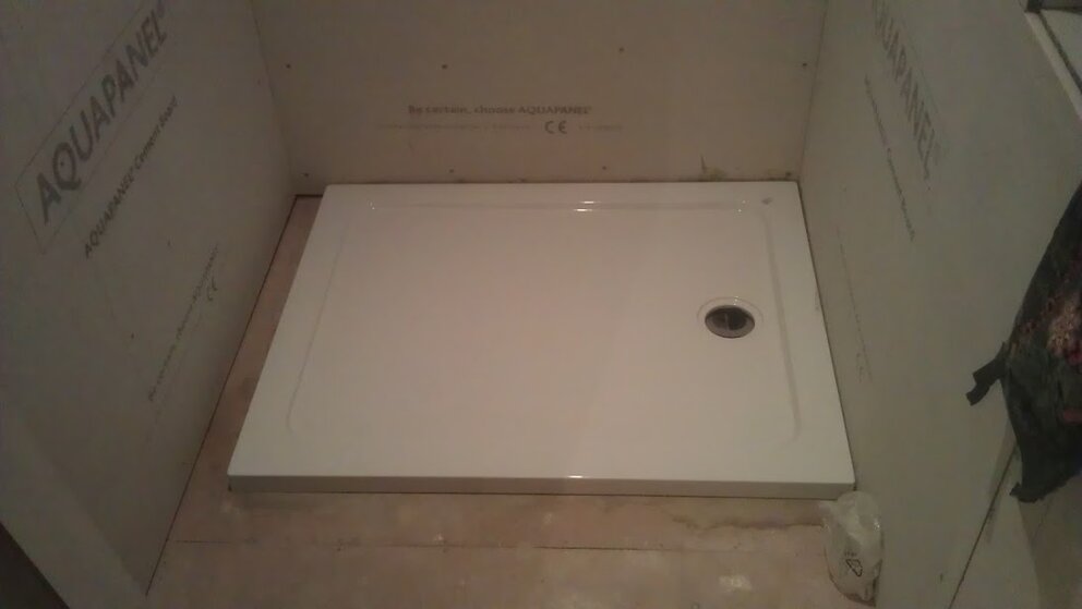

Anyway, images (the tray is not yet fixed in places and probably isn't pushed all the way up to the walls)...

That sounds bad.
The main shower head is actually a cloud head, the plumbing you can see there is the hand shower.
The waste is running under the floor and pretty much can't be moved from where it is.
The sink (a skinny one) will be on the left wall so to move the shower door to left, even by 60mm, would make it almost prohibitively narrow to get in and out of.
Although it is plumbed in, I could build out the wall on the left if I absolutely had to but I'd rather avoid that at all costs as it will push the project back and spoil the look we're going for. That said, I'd rather nothing leaked.

How about building out the wall below the shelf only? You would then have a horizontal shelf all the way across. Or even better, inegrate the wall with the shelf so its' all one shelf all the way across. You fill your 60mm missing area below and make it look like it was on purpose. Otherwise, I'd just ditch the pan and make your own using concrete
Matt123
How about build out the wall from the floor up to the existing shelf. build it out as far as the shelf protrudes and make the whole horizontal surface (i imagine 32") a shelf. Now the reveal can be tiled and the protruding wall from floor to about 40" high or however high that shelf is looks like it was intentional
