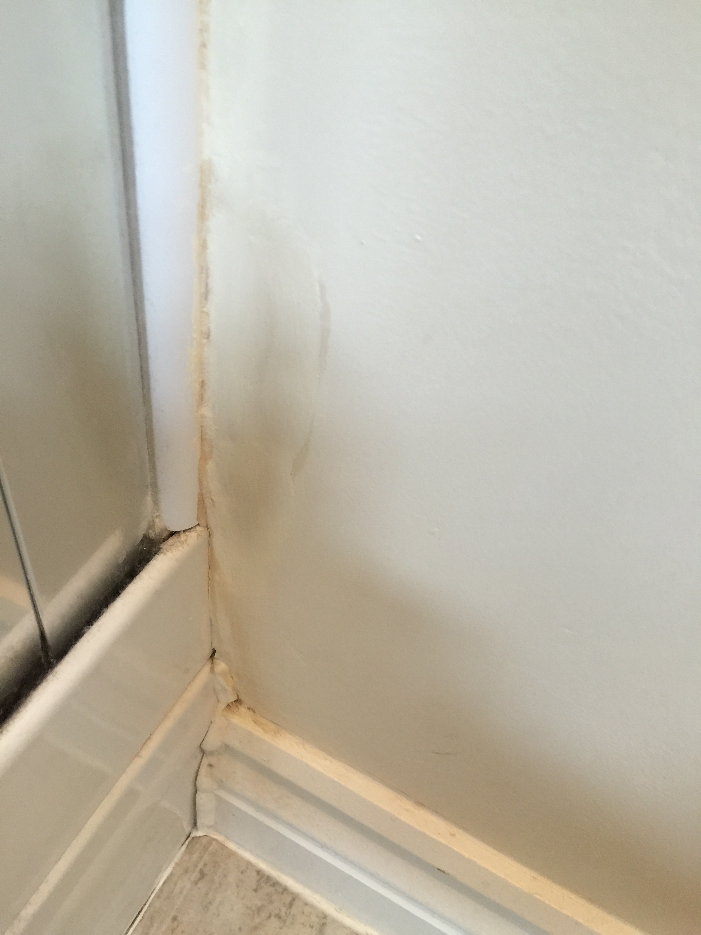

Hi,
See attached for a photo of the stain. You can see it coming through. (This shows the stain from the outside of the shower door inline with the bottom row of tiles)
I have no idea if tanking was done. I don't have spare tiles either.
Any ideas where to go with this?

Alan.P
That doesn't look good, I'm guessing that it's a plasterboard wall, if so the damage is going to have travelled behind the tiles as well, you could be looking at a full rebuild at worst, if it were me, I would want to know what damage there is behind the tile, 2 or 3 ways of doing it, remove some of the tiles, or remove a section outside the shower or a section on the backside of the shower wall. Probably not the answers you were looking for.

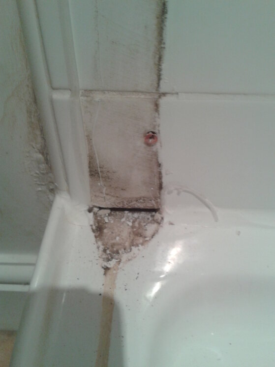

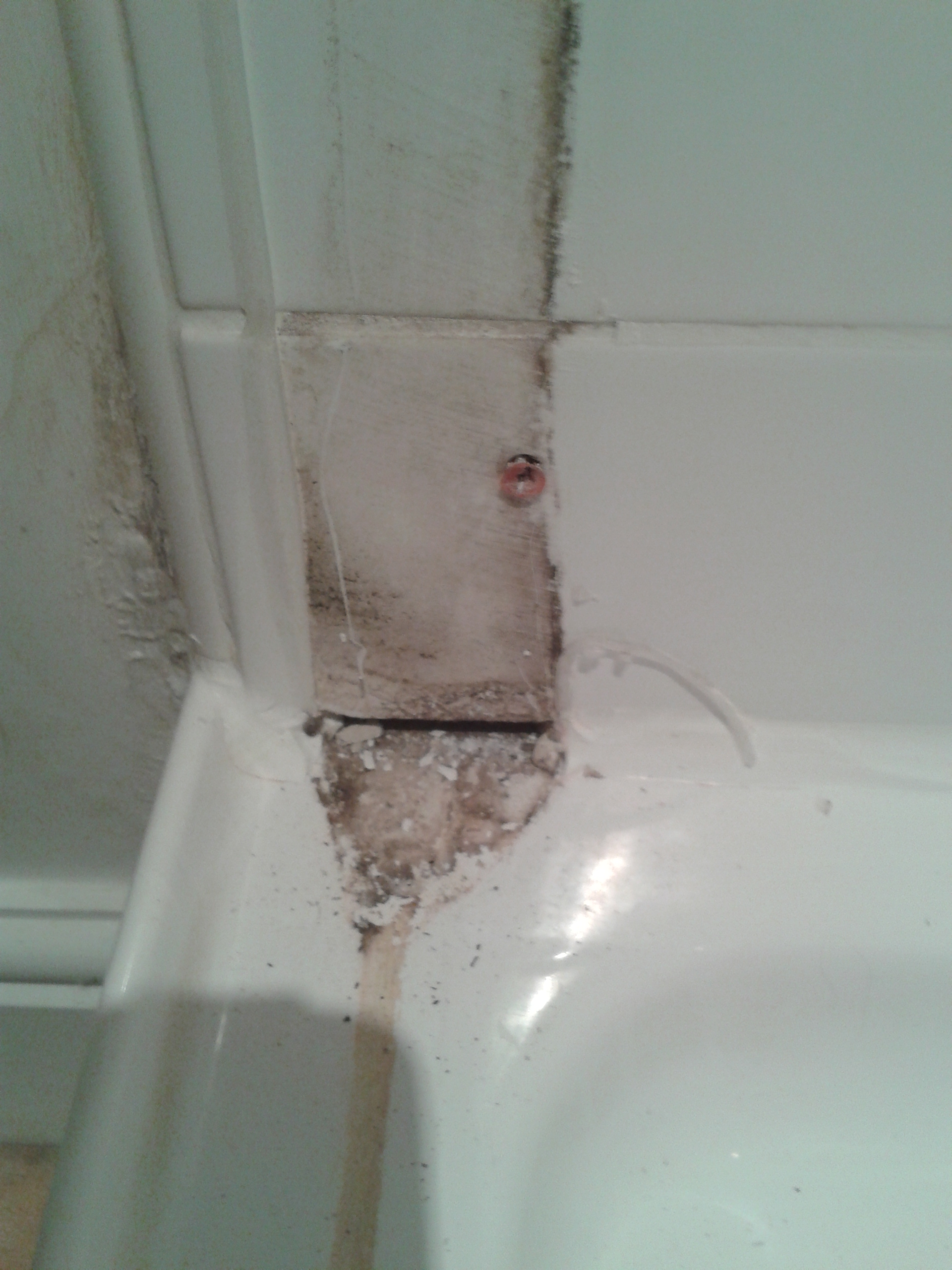

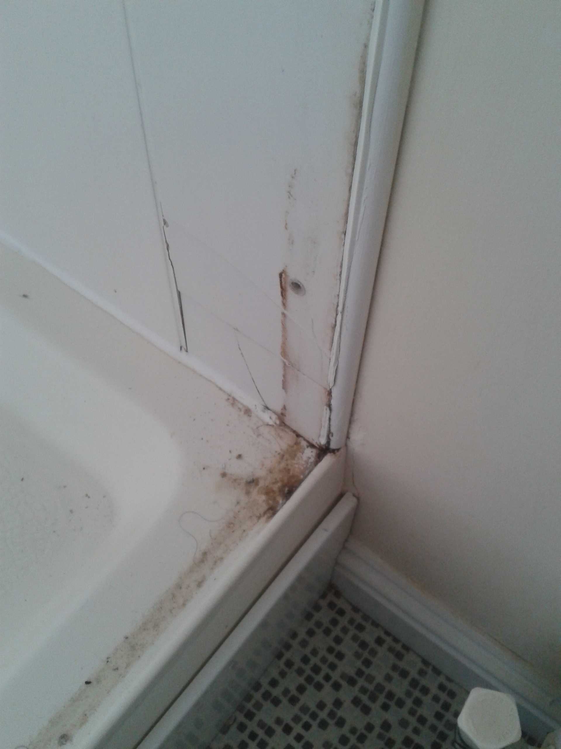

one of the most common newbuild house problems I see (pics are of 2 I have done this year, done 3 showers in one house end of last year) look at the pictures, they fit the screen THEN they silicon it no silicon at the joint under the screen and no tanking
believe me when I say the only way to fix this is to rip it out and start again, the damage is done the water will eventually find its way to the ceiling below

typical; new build problem usually caused by the drying out process and your timbers in your house shrinking causing the shower tray to drop and the lower course of tiles being pulled down usually by being Silicon to your tray.
get some one to stand in the tray I bet the tray dropps causing the grout to open so water will.pass through.
like above there never tanked and even that wouldn't help as by the luck of it your tray has an internal upstand these trays are well favoured by most national housebuilders
you may need to remove all the tiles reboard and apply a waterproof membrain in the shower.
done dozens of these over the years for a local property company who work only for insurance companies
your nhbc policy isn't worth the paper its written on imho .your builder will probably do a patch up which will last a while till it happens again
