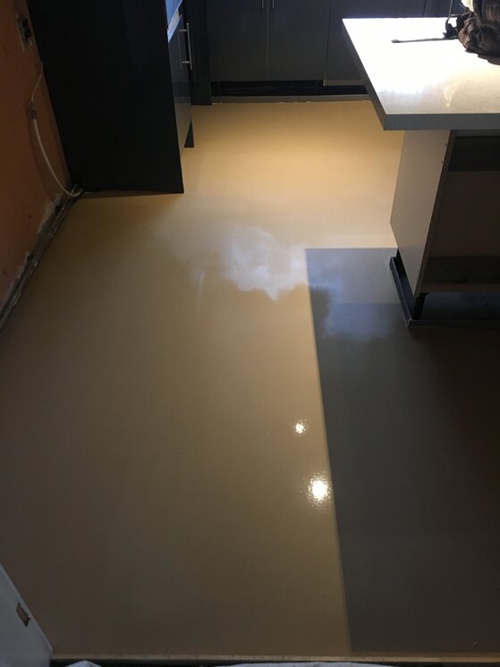

think that's the problem with the world nowadays, always speed, speed, speed, rush, rush, rush.
seems the way people are going , this goes off this quickly, I can fix this many in a day, I can earn enough to be home for a nap by lunchtime ;)
it's all wrong, :)
Julian, u know me and speed don't mix! Haha
It's not about that for me, it's just how it flows and levels, it's excellent!
That's why I like it.
It's so very rare for me to need an area levelled and dry the same week let alone day! Haha
Stef
The last thing I worry about is speed on a job but the job I'm doing today needs heat mat fitted & slc so the kitchen is usable again as they have 3 kids.
I used to use a lot of Weber but it's a 10mm min on wood substrate.
I still use a lot of renovation screed & Eco from Mapei as TM isn't readily available where I live.
