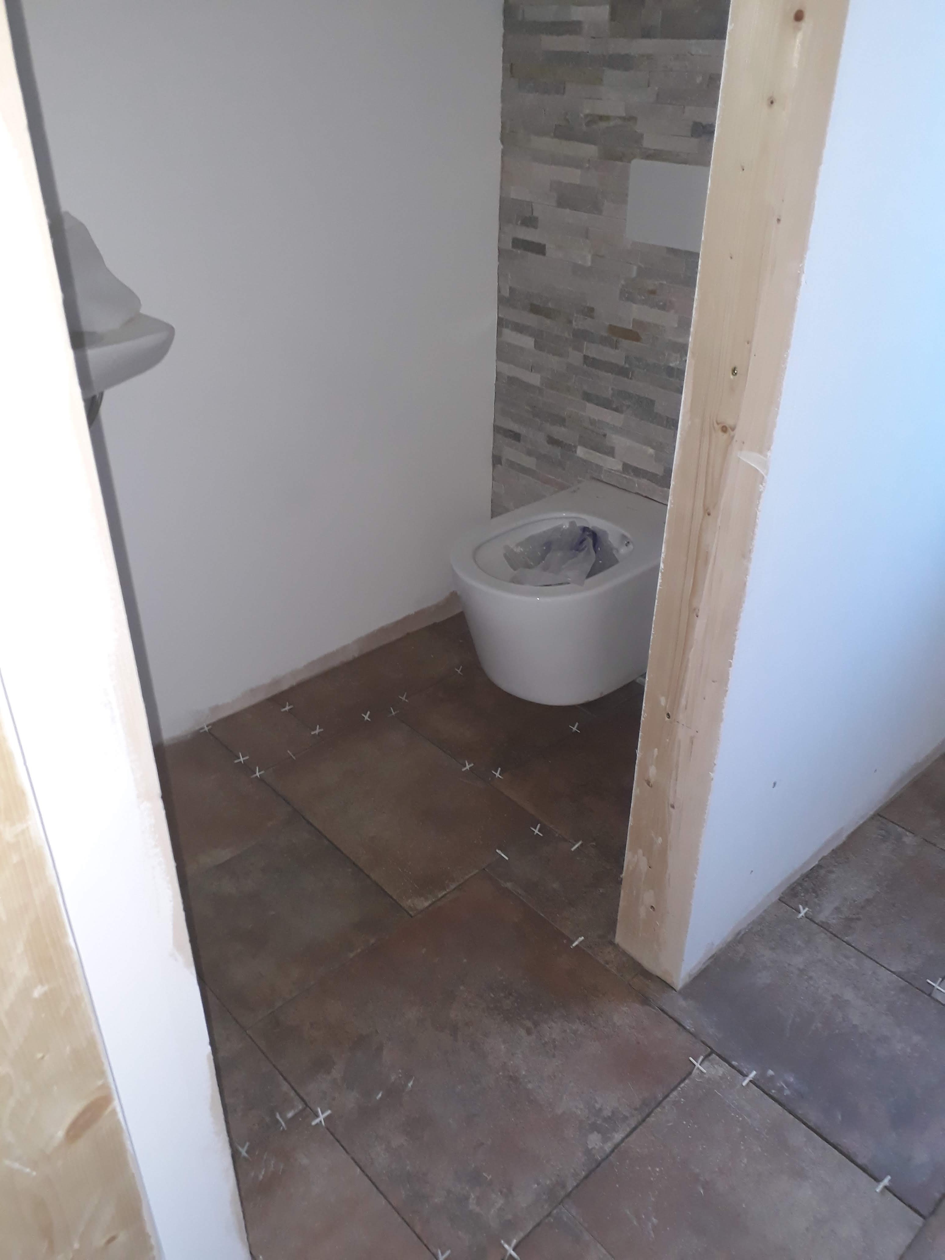

These need tidying up as the tiler didn't give em the attention he should have some unsightly gaps can these be grouted if so what would be best to use. Cheers kop
Bill
sometimes split face tiles do not tie in close together - the product is notorious for misshapes.
The 1st photo, the tiles and plasterboard should been cut closer to the waste, flush inlet and bolts. Apart from that - it doesn't look too bad.
One more point - I never understand why folk have difficult to clean surfaces in wet areas.........
Spare Tool
I thought that about the board and tile gap round the pipes too, don't think the toilet will cover that?
