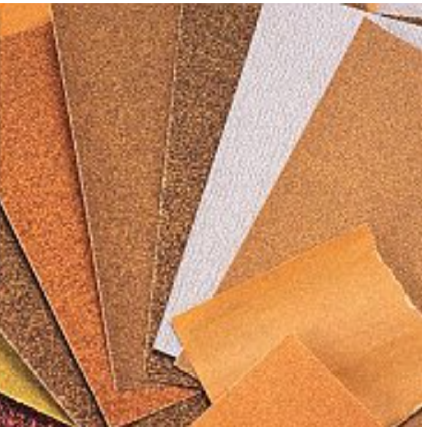

Tiler mate up here had similar with Mapei 112 mid grey in ceramic tiled bathroom. CTD gave him numbers for Mapei support. Spoke to him a few days later and was telling me they told him to finely sand the blotchy areas with fine grade sponge sand block as was only on surface, they said they've had similar enquiries. Mate said right enough it worked.
Italy
Yes, I confirm, I often use sandpaper, with these problems. (True @Andystiletiling ?) :).
One of the problems, with some ceramic tiles,
Have some tile edges
With enamel and some edges no.
Spare Tool
you can get help for this sand paper fetish you have Andy:)
Mmmmm... ;)
