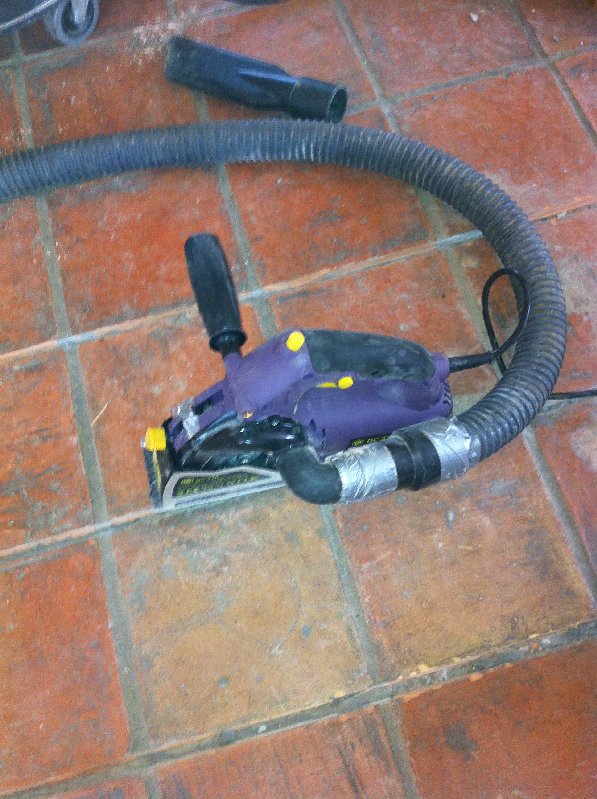

Tools to remove grout can be either a hand tool (New Blackspur Tile Rake Tungsten Carbide Blade Grout Remover DIY Tool 5017403027430 | eBay ), A grout removal tool like this Electric Grout Remover | eBay
A fein Multimaster Tradetiler tilers Fein Multimaster
An Exactsaw DC270 Deep Cut Exakt Saw with Wooden 5 Blade Case | Exakt Precision Tools | eBay
Or an angle grinder with either a standard diamond wheel or a grout removal wheel like this TradeTiler.Ltd

Here you go.Exakt saw. Glendale Manor Farm 009.jpg Glendale Manor Farm 008.jpg
I would very much doubt they are 8mm joints and a 3mm dip, I'm sure That's just a guess, as said pics would really help in this situation for the right advice to be given! I wouldn't rush into getting any power tools on the job just yet. If the joints are really that low they can be 'topped up' as for the poor cutting etc again pics would help us to see if it's generally acceptable or just how bad it is.
