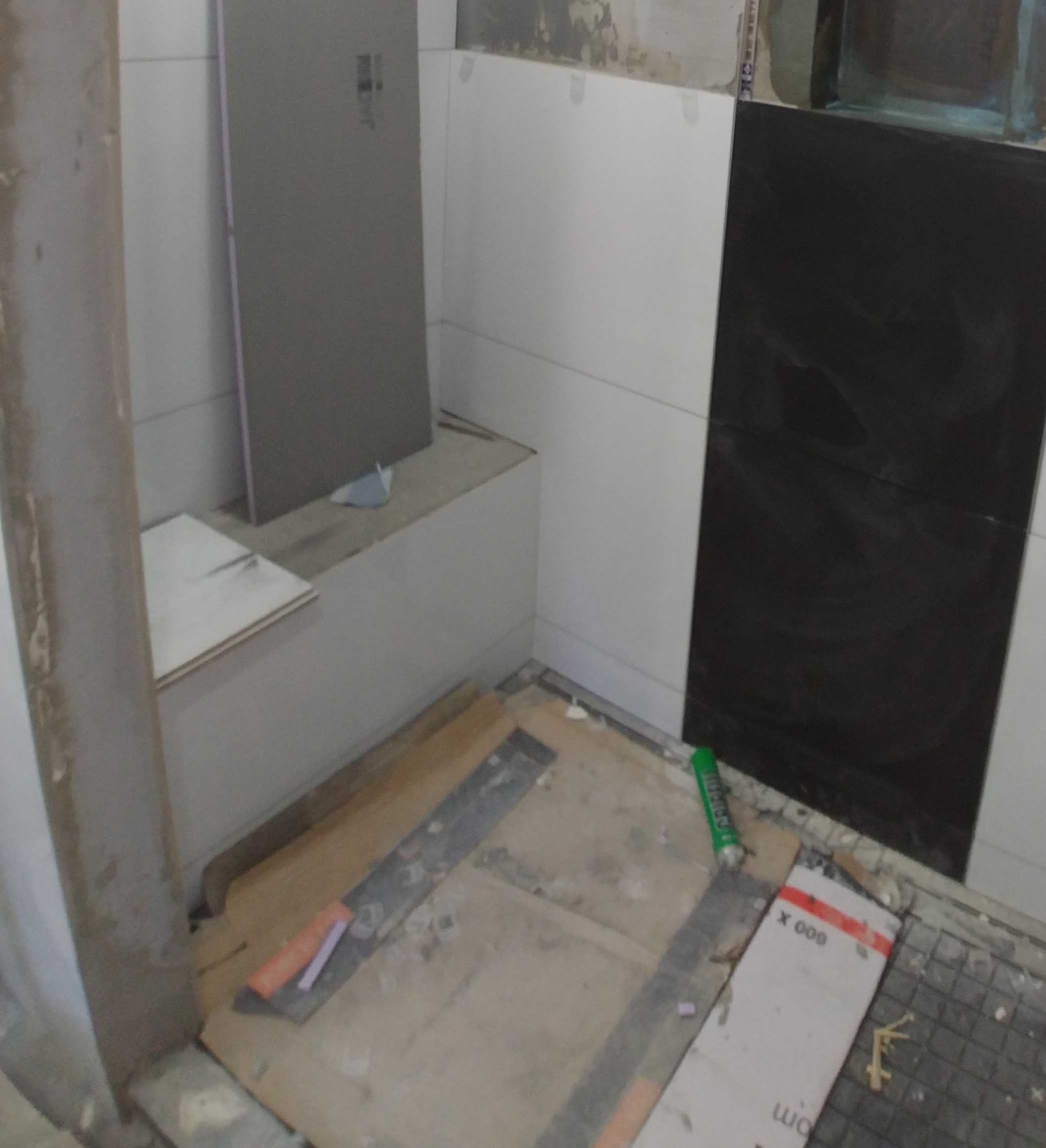

Whats the floor made of timber or masonry? Theyre easy enough to custom build, Ive done one recently that was on masonry... Just built it up with some blocks, covered with jackoboard, tanked where needed, then tiled with a slight fall so no sitting water..
