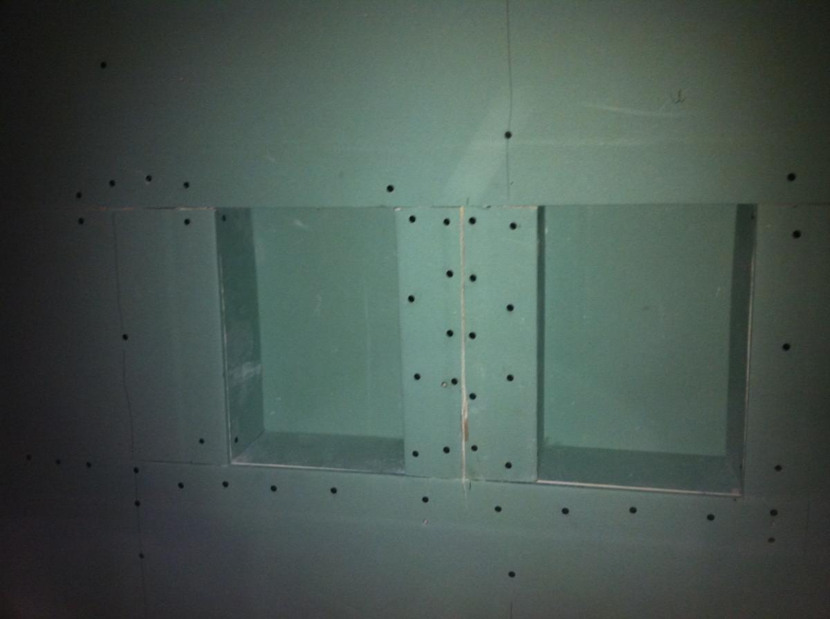

I have recently re-boarded one of the en-suite bathrooms, using moisture resistant plasterboard and plastered the ceiling, and the upper quarter of the walls (for painting). We are installing an offset corner bath, with mira atom shower bar above, and shower screen. The plan is to tile around the bath area up to the painted level.
I really want to make sure that the whole area is protected from leaks so I intend to tank the plasterboard that is to be tiled with Mapei WPS.
My main question is regarding some niches I have installed into the stud wall. The stud was doubled up 3x2, so 6 inches deep and seemed to be a good use of the dead space. I built these using ply and then lined using MR plasterboard. I also built into a slight downslope on the ledge so that water will run out.
My understanding is that I can tank these using Mapei WPS and Mapeband to fill edges. I will then tile using mosaics.
Will this be effective in sealing the board and stopping water passing through and into the wall? Any other things that I need to consider?
Photo attached.

David Dudley
Just had another thought. Would it be a good idea to silicone all the joints before I tape and coat with mapegum?
There are quite a few gaps (2-3mm wide) that need sealing where the boards meet.
I could replace the board with tile backer or marmox if really necessary but that would be a hassle I don't really need and the tile weight isn't going to be an issue so I'm not sure if I would gain anything.
If the mapegum is effective at waterproofing plasterboard then I guess the board doesn't actually matter for such a small niche?
My only concern is water proofing it all as the bathroom is directly over a living room.
My plan is to:
Silicone round the boards,
mapegum wps
tape all joins
then re-coat with mapegum
tile using bagged adhesive
then silicone all corners
Is this the best way to go?
PHG Dave
Thanks alot guys. Does the tanking solution stick to the silicone ok?
Should I be using acrylci silicone or normal silicone?
Thanks again.
Nothing much sticks to silicone (Acyrlic and silicone are two different materials)
Personally do not see the point in silicone in the joints, if water gets through the membrane then it can go through the boards as they are only water resistant not waterproof.
Your original plan of Mapeband (or Dural's DURABASE Flex sealing tape) and Mapegum is perfect for the job
