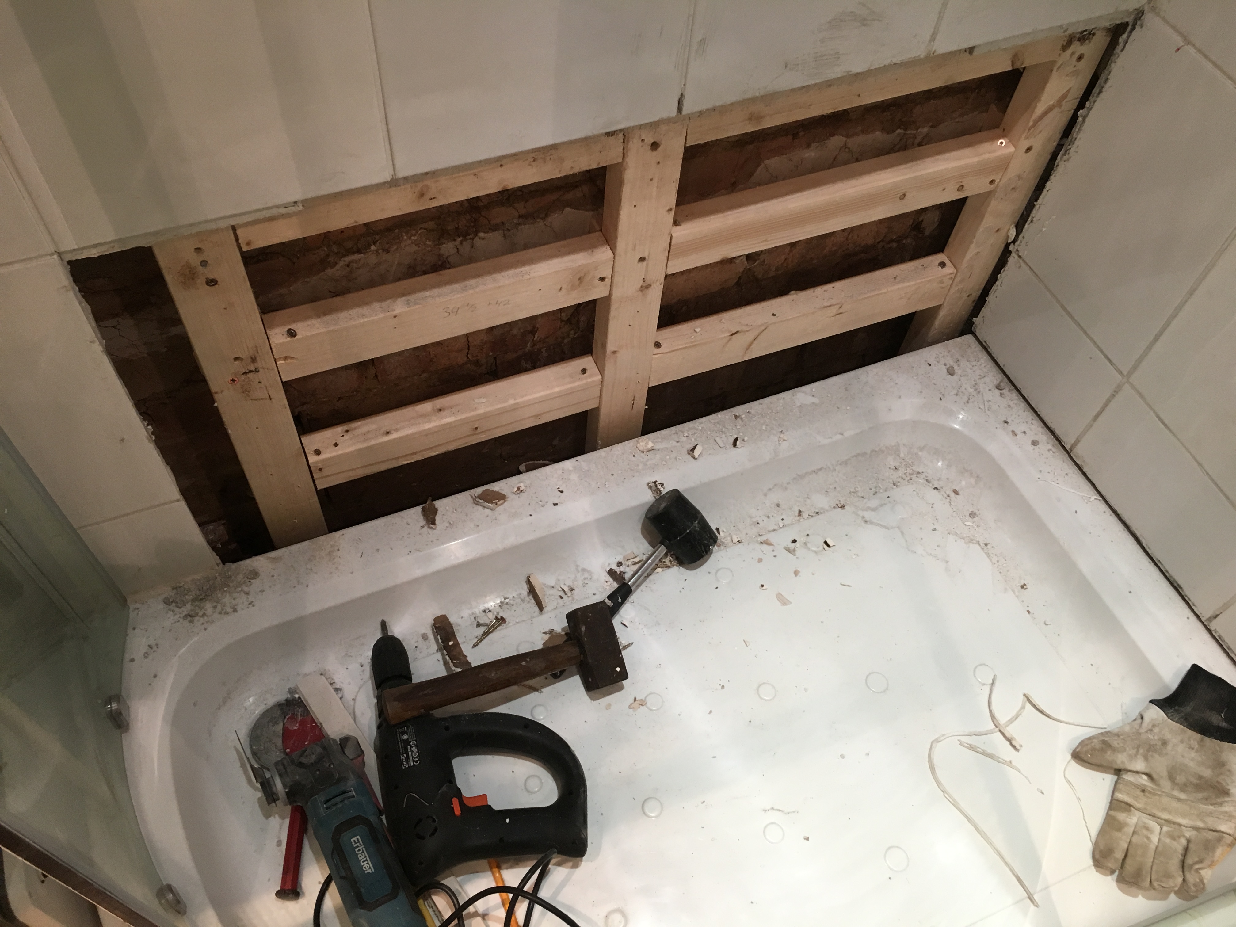

We're in a first-floor maisonette that was leaking (not loads, but a small drip, drip) from our shower into neighbour's flat below. Having initially re-applied sealant, the shower tray dropped as it's on a completely rotten base.

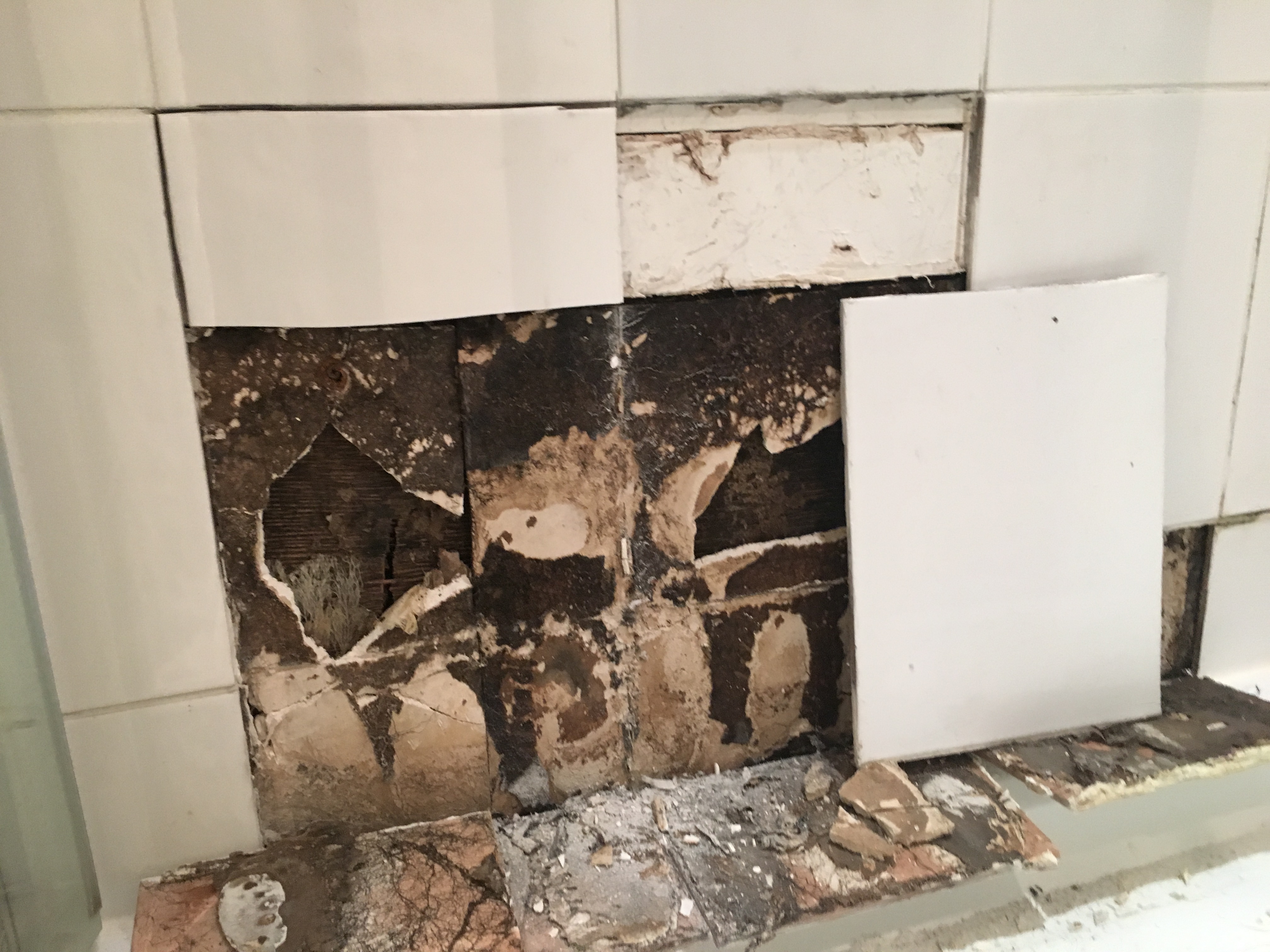

This weekend, I cut out and removed lower tiles within the shower enclosure, hooked out the rotten substrate and then put in new stud and cement board. This has been with the intention to buy us more time until we have the money to rip out the shower and retile the bathroom.
Because I've cut along the existing grout lines and popped new board in there, the tiles are going to be edged on the edge of the board, which (despite my best (but mediocre) efforts), has resulted in there being gaps exactly on the grout lines to each edge of the board.
I am asking you if I can fill the gaps around the edge of the board in order to lose the gaps and then prime in order to get a chance of waterproofing?

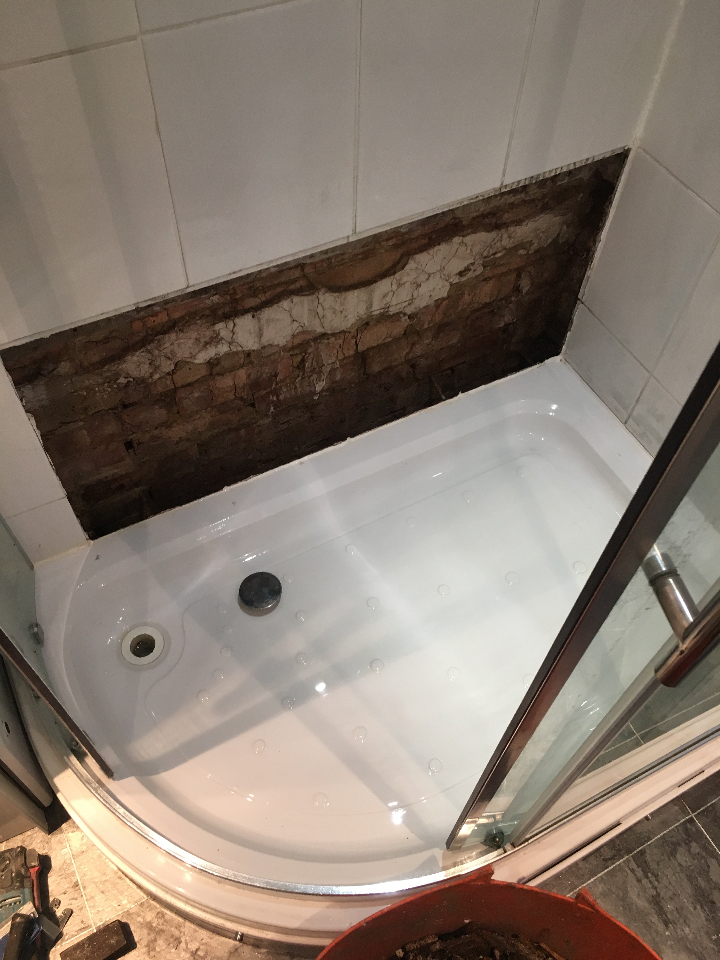

Having removed the old gear, the brickwork is dry, so seems (to my mind) to be a case of failed grout, plus sealant, and water being drawn all over the place.
It's all pretty dry having hacked off the rotten sh*te.

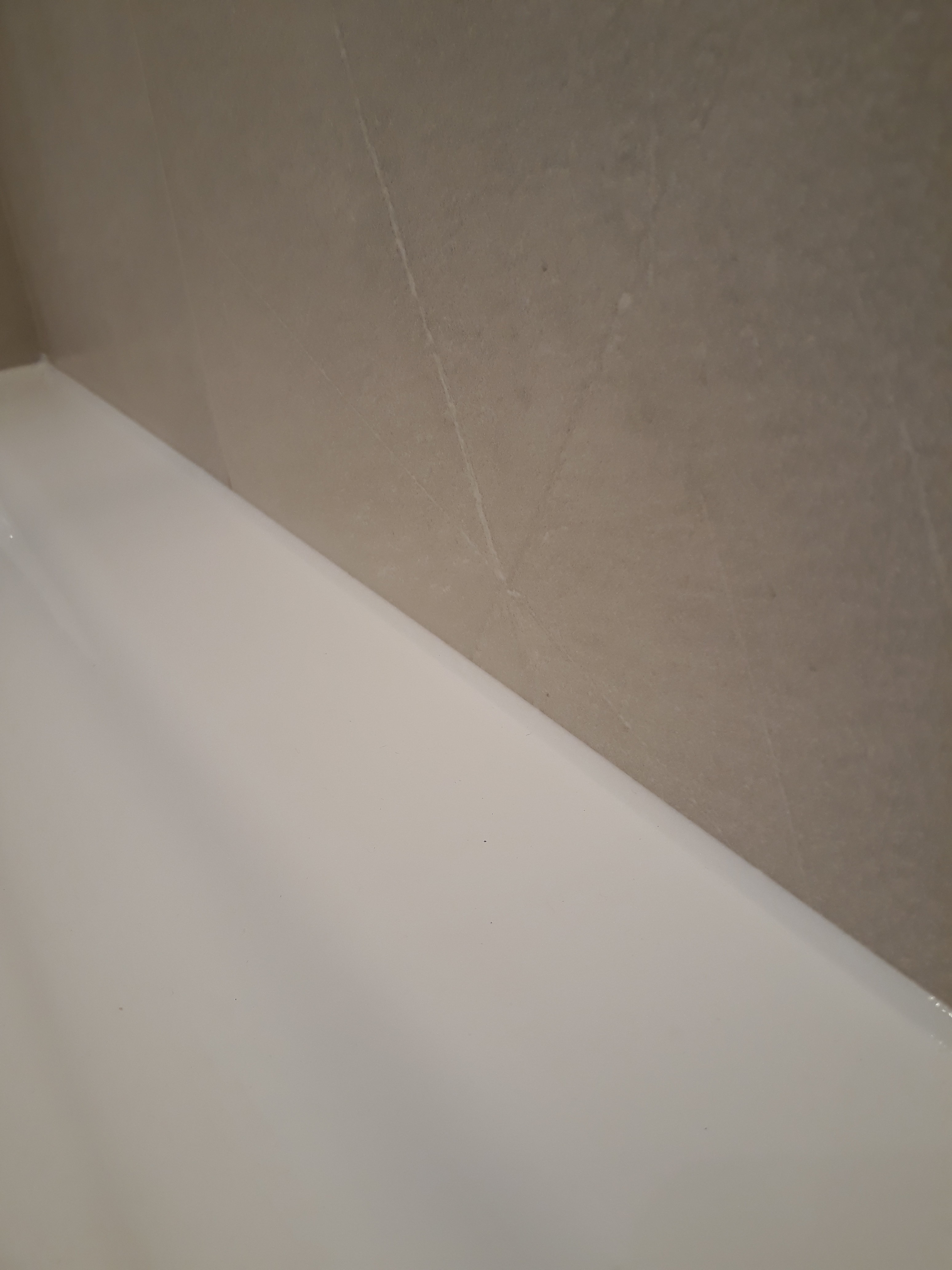

It's taken 5 days but I've now put tiles on the wall and grouted, followed by putting on Mapei's sealant, something which I just cannot do well when using a thick layer. I had bought my second finishing kit from Screwfix (comes in the green box with a variety of applicators), which were great on areas that needed less sealant though I struggled on the larger beads (seemed to be more suited to right-handers, when I am not).
Anyway, job is done, though still need to get additional support under the base to prevent further slacking of the base.
Tiles on the right are tarnished by the multitool used initially to remove old sealant.
I'm not happy with my application of the sealant, so would like an idea of what I would expect to pay for a pro to make it good?

As above, and dip the tool into Fairy liquid before using it ( just the normal green stuff ). Probably be better taking that lot out, a good clean up with CT1 Multisolve ( other Silicon removal sprays are available ) then do it again. A common mistake is cutting the nozzle too small. IMG_20190430_163722_439.jpg 20190506_180855.jpg
Thanks Tony. Your comment reminded me that I've bought the Fugi in the past - no idea where that is now, having moved house since. I then bought the remover and applicator set from Screwfix with which I was not getting results I wanted, so this time around I bought the Screwfix No Nonsense set, using the flat edge on the base of the shower tray. I can do a small bead with a soapy finger but really struggle with anything else, despite my using Fairy in a spray to work the Silicon and clean the applicator after each go.
Drives me nuts!
Cheers pdc. I was using Fairy, and for the first time, I didn't cut the nozzle as started the sealing to slowly ensure that I was filling the entire void beneath the tile. I made sure it was proud to allow there to be enough for the applicator to smooth.
I hear you on starting again, which pains me as we've not had use of the shower for a week and we've held off doing so and tomorrow going away for a couple of days to allow it to all cure before using the shower!
View attachment 106856 View attachment 106857
Not to sound silly here but are you using the Fugi (i'm assuming this is the sealant kit you bought) the right way? it's quite an easy mistake to make. You pull the complete flat edge to create the edge and not the side with text/numbers and bevils on
Tony - I was pulling bevelled side on the kit I used, not the straight side! Argh!
Whoops! like i said it is a pretty easy mistake to make, hopefully you can get the finish your after now :)
Just do it in small bits at the time as the excess Silicon will eventually build up on the tool and just smear up and over the tiles then you can go over the full length at the end. soapy water will stop the excess sticking to the tiles and tool but I personally don't use the soapy water trick but that's just what works for me. It's definitely a love/hate task. more hate from me
Just do it in small bits at the time as the excess Silicon will eventually just smear up and over the tiles then you can go over the full length at the end. I personally don't use the soapy water trick but that's just what works for me. Its definitely a love/hate task. more hate from me
Good man - thank you very much! I dread the end of a job when a thick bead is needed - I know it's going to make me start muttering obscenities as I try, claw out, try, claw out, ad infinitum!
