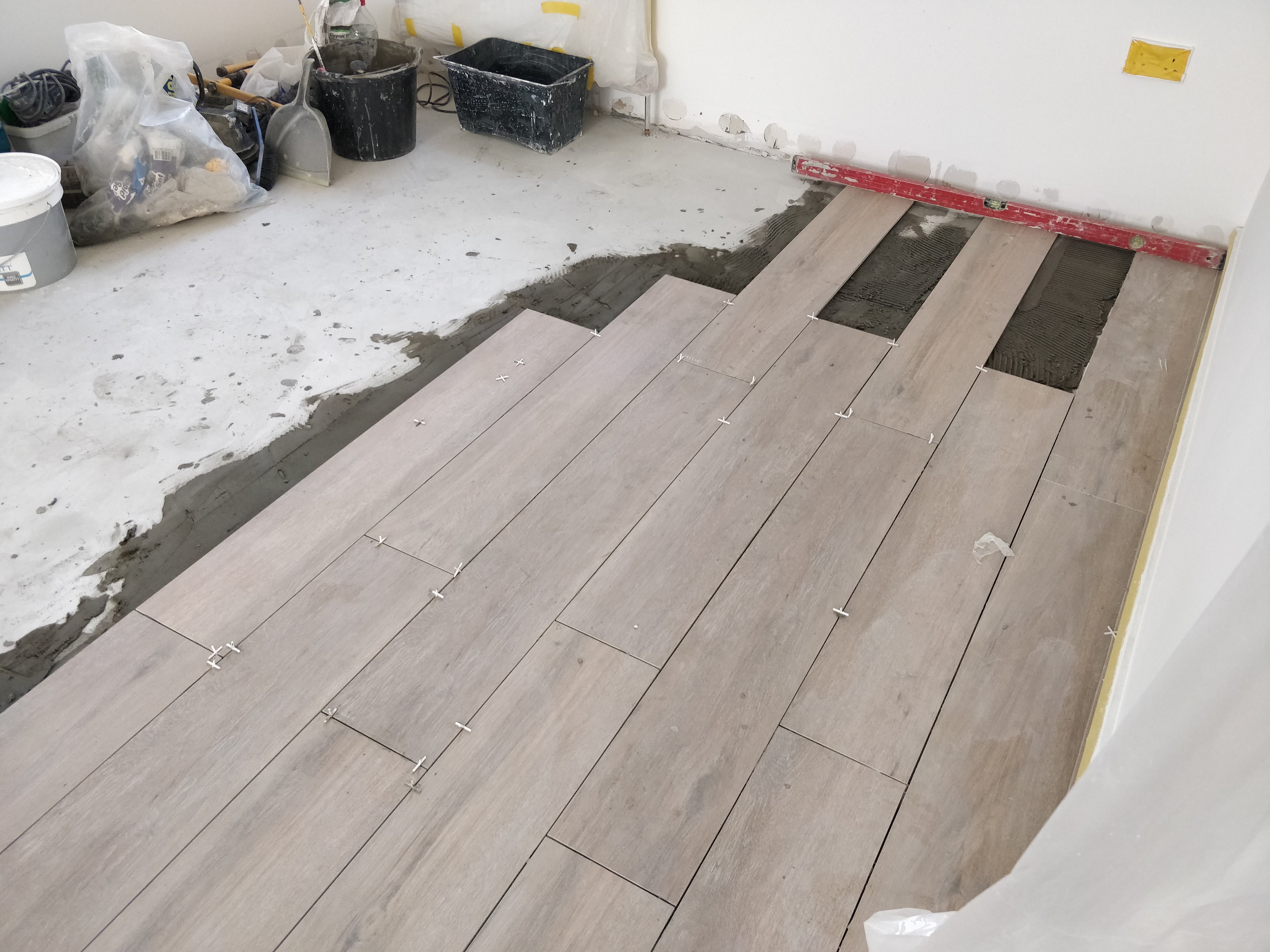

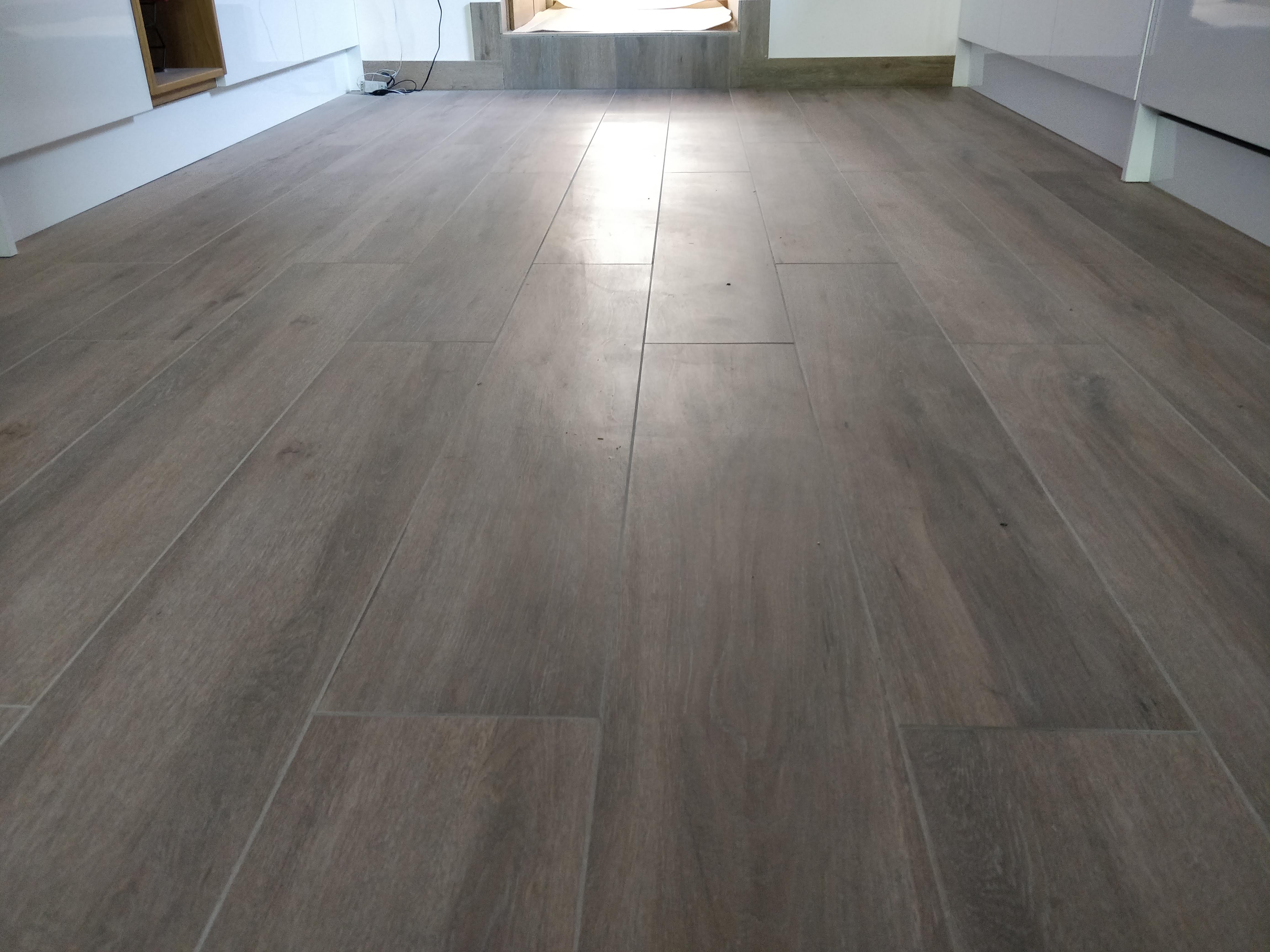

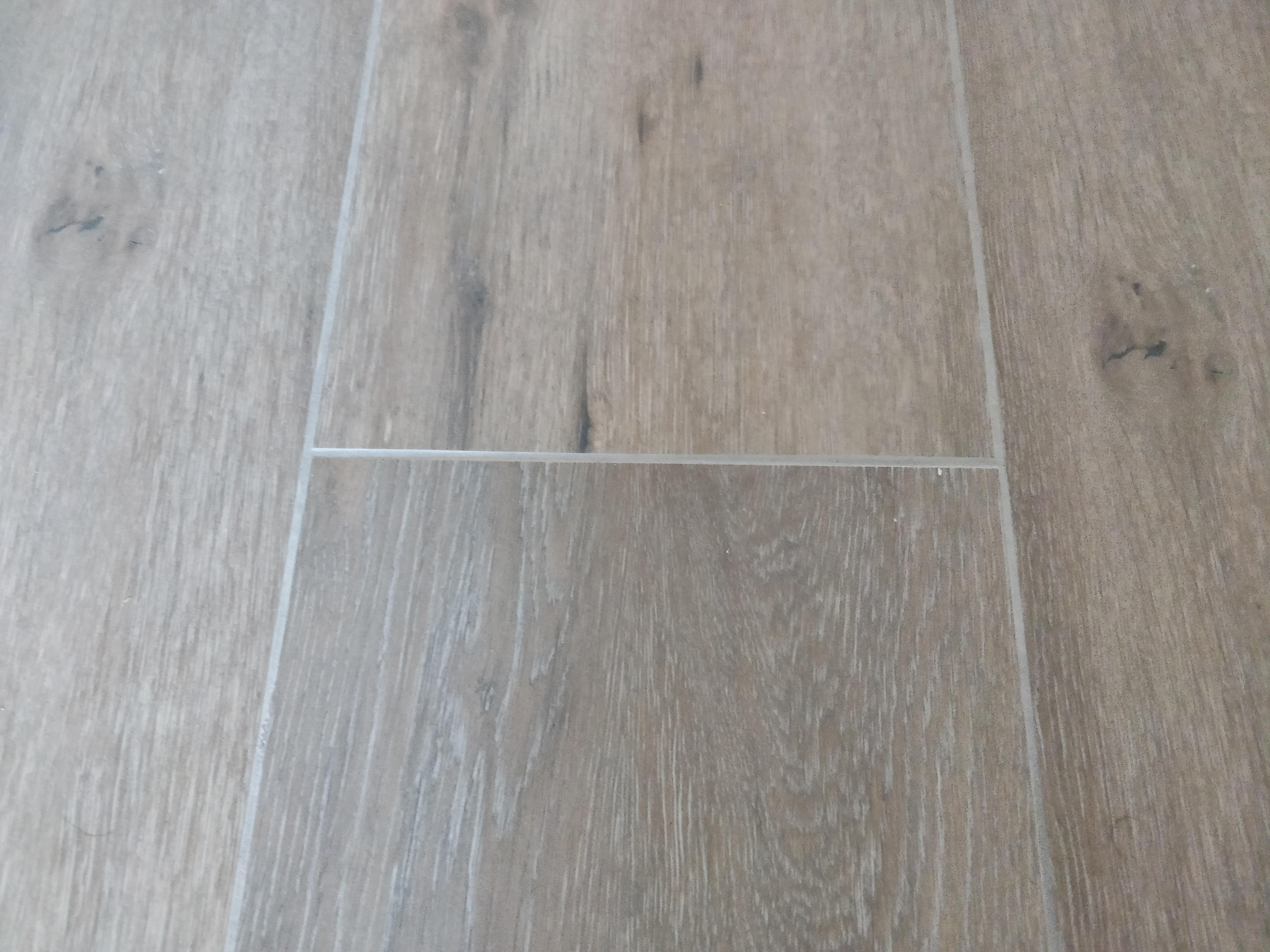

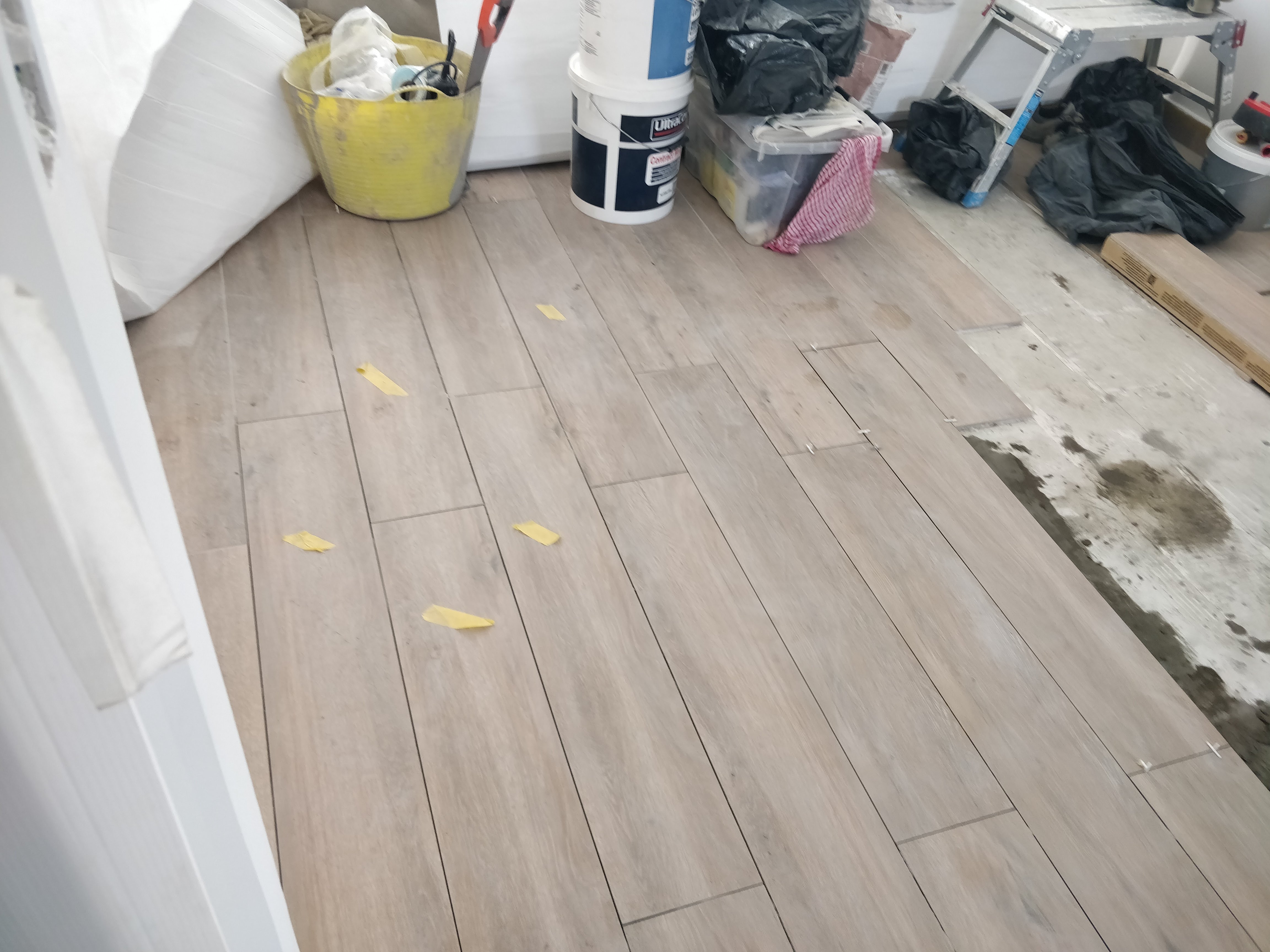

All the tiles have been removed, except few of them.
I've attached 2 pictures of the same tiles in the kitchen, 2 pictures of the work in progress before they removed the tiles (the lippage is not evident in these photos but these were taken before I noticed the issues) and a picture of the gap between two tiles they left.
The work will resume in a couple of days.
IMG_20180521_164402.jpg IMG_20180522_181536.jpg IMG_20180522_181635.jpg IMG_20180522_181601.jpg IMG_20180521_164358.jpg
I'm puzzled by that photo too. I thought the floor had been levelled but that looks like a fair bed of adhesive which I'm not convinced the trowel used to make those serrations would give.
And the fact that it’d been trowelled with no tile placed down. I wondered if that’s what it looked like after their removal! :eek:
