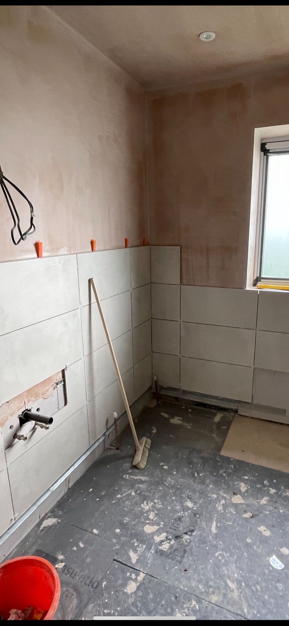

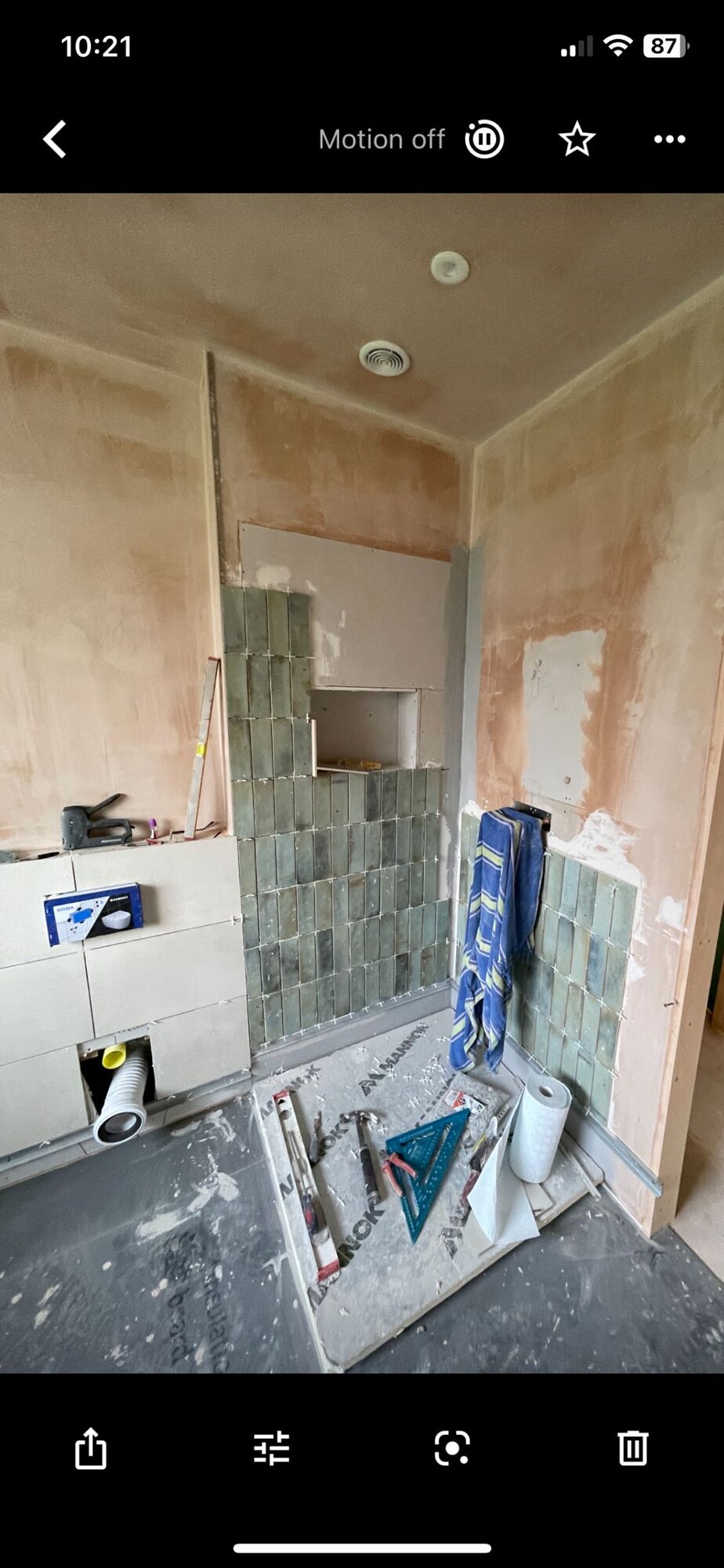

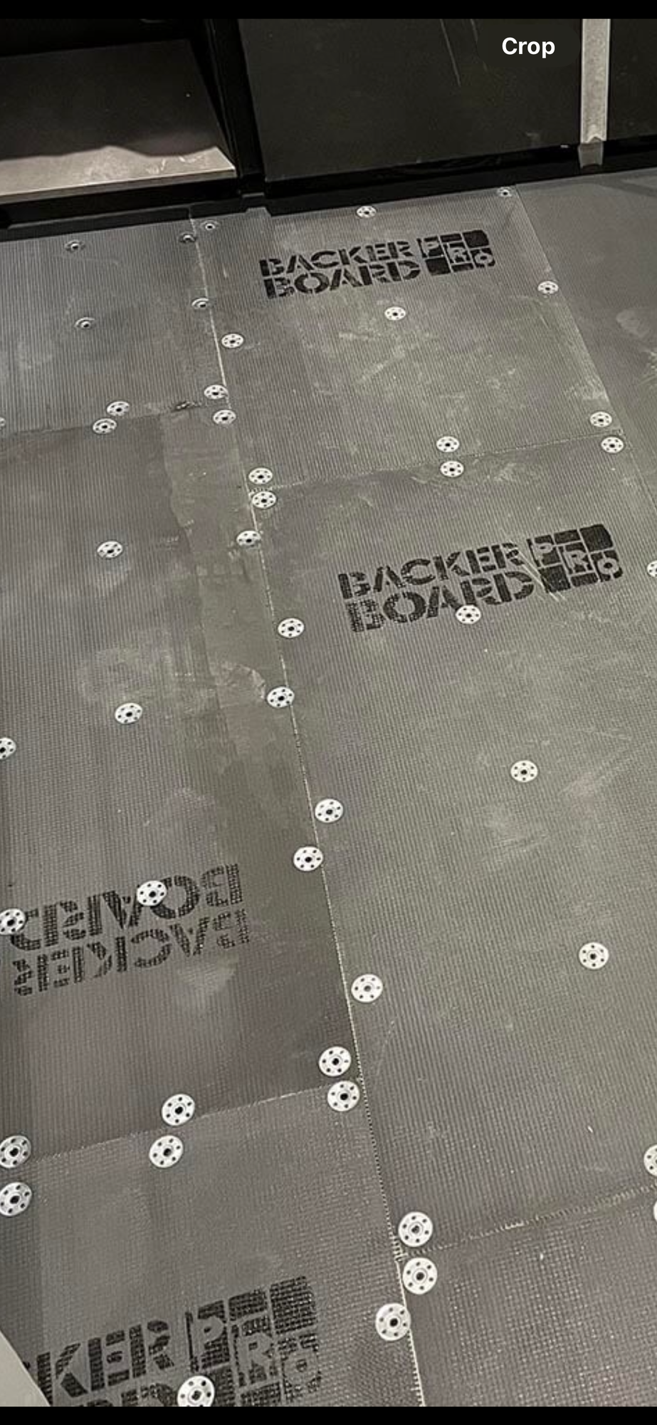

It looks like the insulation boards are not bonded to the substrate. How were they fixed ?
If I understand correctly the insulation boards are actually the bottom layer that we can see and the electric matting is sitting on top of that.
I've found another couple of photos that show the insulation board, but unfortunately we don't know how everything was fixed together.

There doesn’t appear to be any fixings in the insulation boards. They should be adhered to the floor with adhesive or the recommended tubed adhesive. Then fixed with screws and washers. Nothing like that appears to be in those pics. Speak to your installer and see what they say. But you definitely have a failed installation there.
