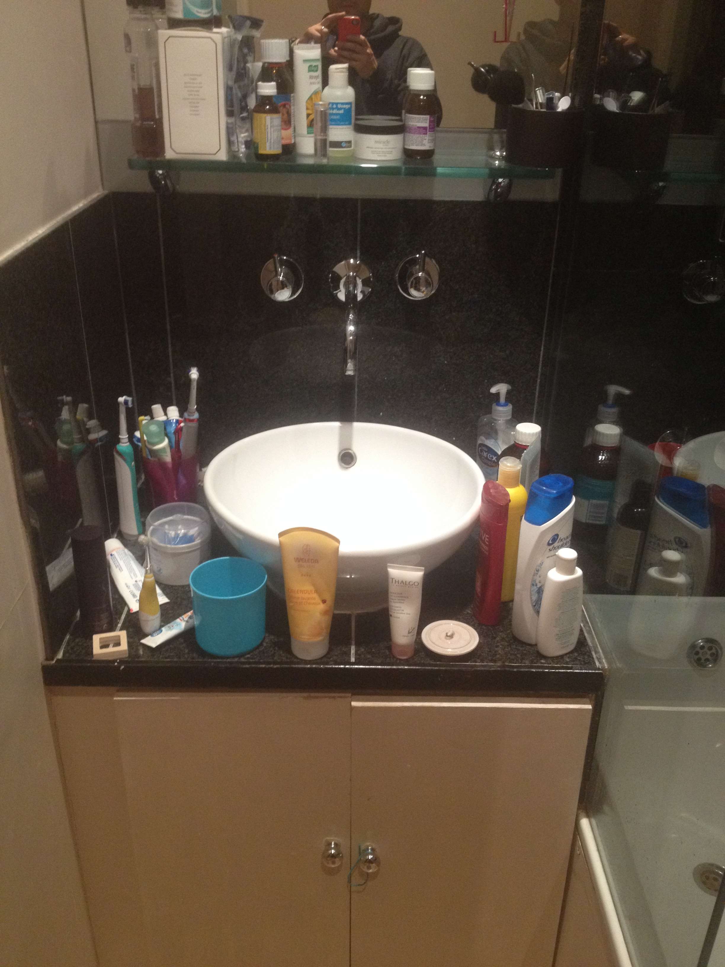

Anyway, I have a job where the basin tap is concealed behind some tiles, they've tiled onto ply. I need to remove the tiles, preferably in one piece, to be able to change the tap.
I was wondering if I could get some expert advice from you lot as to the best course of action. I was thinking I could cut out the grout and then cut through the ply with a multitool, slip the 2 tiles out still on the ply and change the tap. But I went to look at the tiling tonight and I don't think it's feasible.
Here are some photos:
The wall tiles have been fitted before the tiles the basin sits on.
Any help would be grand.

Go in from the other side of the wall.
I thought about that. My next question then is this? If the tap is on a stud, am I to cut off that section of stud and screw in a new piece once the tap has been fitted to it? Sorry for the ignorance but I've never replaced a tap from behind (wrong forum I know, but since you brought up the subject ;) )

That is possible yes... Just i think the disturbance might be less .. Cut a small inspection hole and investigate..
I think that might be a plan. I have an inspection camera I can put through the hole and have a butchers and if it's a no go then I can just plaster the hole and wash my hands with it, only not with the leaking basin tap :p

I may be barking up the wrong tree here, excuse me if am - stone scrubber not even a tiler
Are the cartridges similar to a shower double valve- I had leaking cartridges which were seized when moved in my house, mate plumber said he would remove whole valve from back.
Salts had formed which may have led to this, I dabbed combinations of a light dilute acid on a cotton bud and then some wd40 on to cartridge. hour later they shifted.
This may be completely wrong for the tap.
