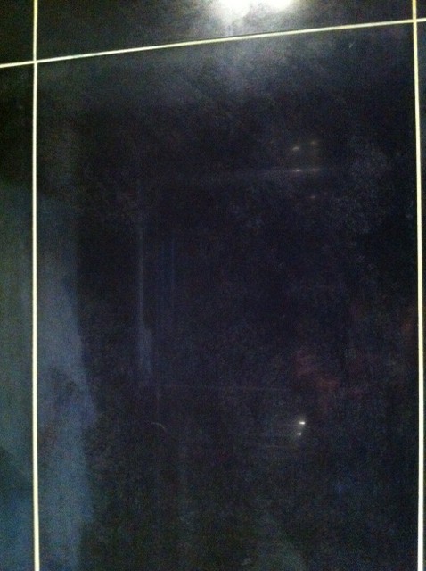

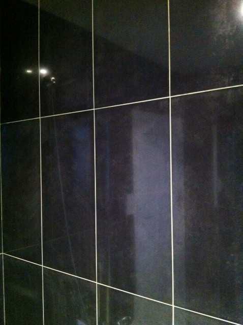

Hi there
Here are the pics...
photo2.jpg and...
Was a bit tricky to get pics becuause of the light reflecting, but you should be able to see how hazy they have become as a concequence. I appreciate they arent high gloss tiles but I was hoping they would look blacker.

Firstly you must break down any polymers that may have risen to the surface of the tile then you need to remove the Haze with a Diluted acid or perhaps a strong Alkaline cleaner then your grout Haze will disappear then you may not even need a Colour enhancer but if you still feel it needed then perhaps you could apply it. Unfortunately I am not familiar with the whole of the LTP range well there cleaners anyway and feel that if I were to suggest alternatives it would just get removed anyway but shall have a look at the LTP range in a bit more depth for you and see if there is a solution.
