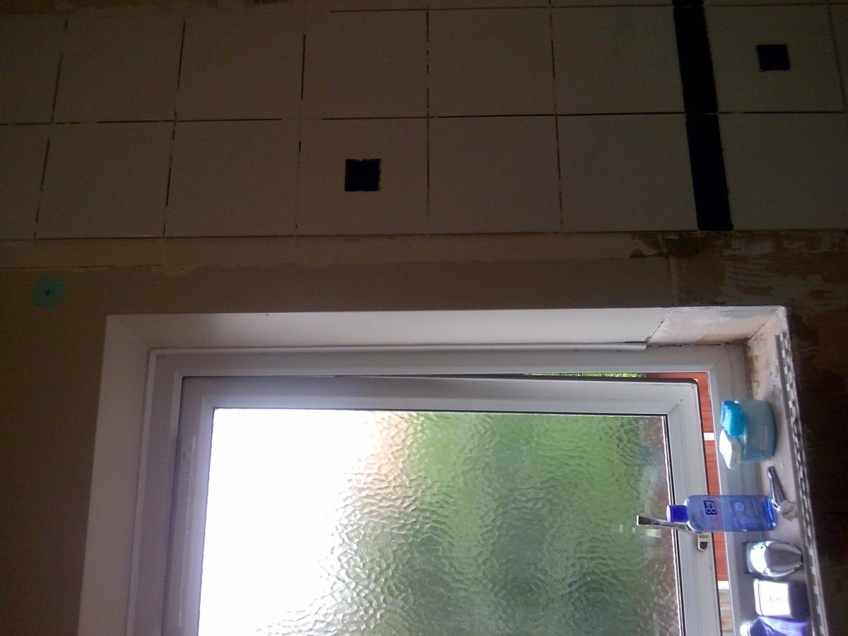

Ok, I've attached picture of the area of the window I'm trying to do, so I'll try and explain myself a bit better.
The right hand side needs to be tiled up to the celiling because this is where the shower is, however the left hand side I am only going as high as one tile above the border as the whole wall doesn't need to be tiled, so this is why I don't want to tile the entire recess.
Basically, I want to tile the next row up to the window recess, but tile the recess itself up to one tile above the border as mentioned. So what would be the best way to fit the trim to enable me to do this?

I don't think the step down from 1 side to another would look wrong, the alternative would be just trim the tiles from halfway point, and feather finish flush the reveal to hide the cut edge of the top ones, and paint the plaster to the face of the tile, therefore hiding the cut edges not trimmed....

Ideally I would want either side balanced.
GazTech I think your solution is quite a good one.....only other option I have come up with is to stop just short of the window line above the halfway point and that way I can use trim on all the edges using a series of 45 degree mitres. Has anyone tried this before I do it and it looks ridiculous??

I don't think it can be done with trims.....Gaz
