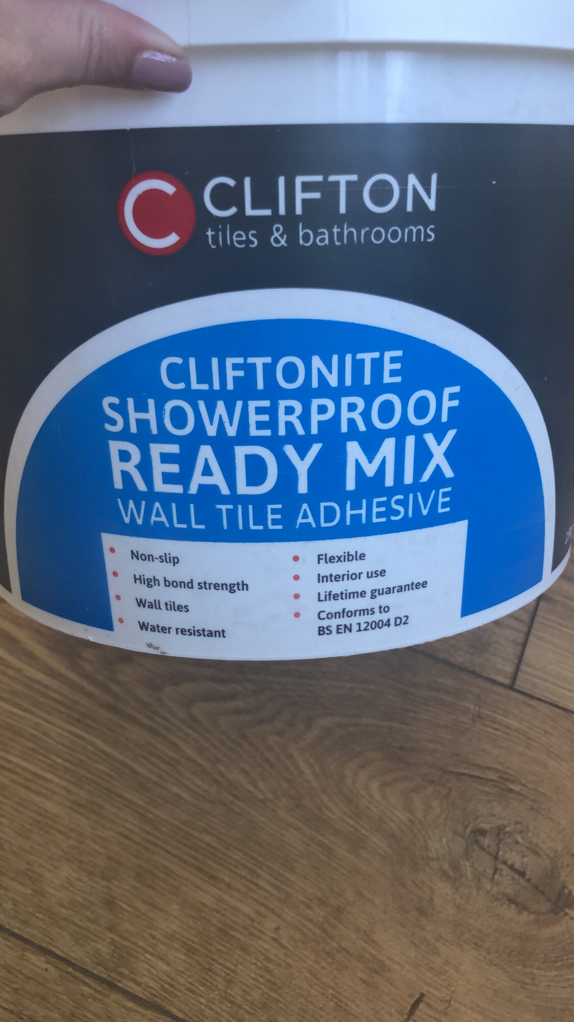

Thanks for messaging. I’m not sure what he’s used. I can ask the question. Is there a type where it’s usual to do dot & dab?
Its not a recommendation to D&D , just if its tubbed adhesive then failure is more likely and the adhesive won’t fully dry on that size tile and grouted as well.

Busted, I found 4 tubs of this in the skip! So he has used pre mixed. We went to the tile shop this morning and they said exactly what you’ve just said. It even clearly states on the tub that dot and dab shouldn’t be used. He’s offered to charge us half price so we just pay for the floor tiles but we don’t know if he’s done those right and wether to pay him a thing. I knocked on the tiles and there is defo hollow spots on the wall tiles but didn’t seem to be on the floor

My worry about the floor is that he’s also used the ready mix which from what I’ve read shouldn’t be used on floors and I couldn’t see any other adhesive packaging in the skip. We’ve got an underfloor heating mat. He’s trying to insist on 50% payment for the floor as he said he didn’t use D&D on the floor. Is it unreasonable for me to refuse to pay him?

Thanks for replying. That’s exactly how we feel but he’s so adamant there’s nothing wrong with it he’s making us question if we are being unreasonable refusing to pay. The tub even says on it that it’s not suitable for tiles the size of ours and states d&d shouldn’t be used but he just keeps brushing me off
