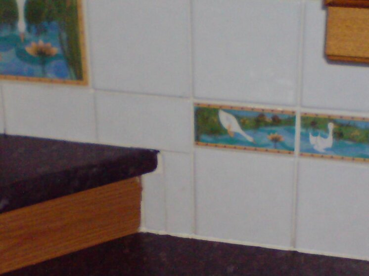

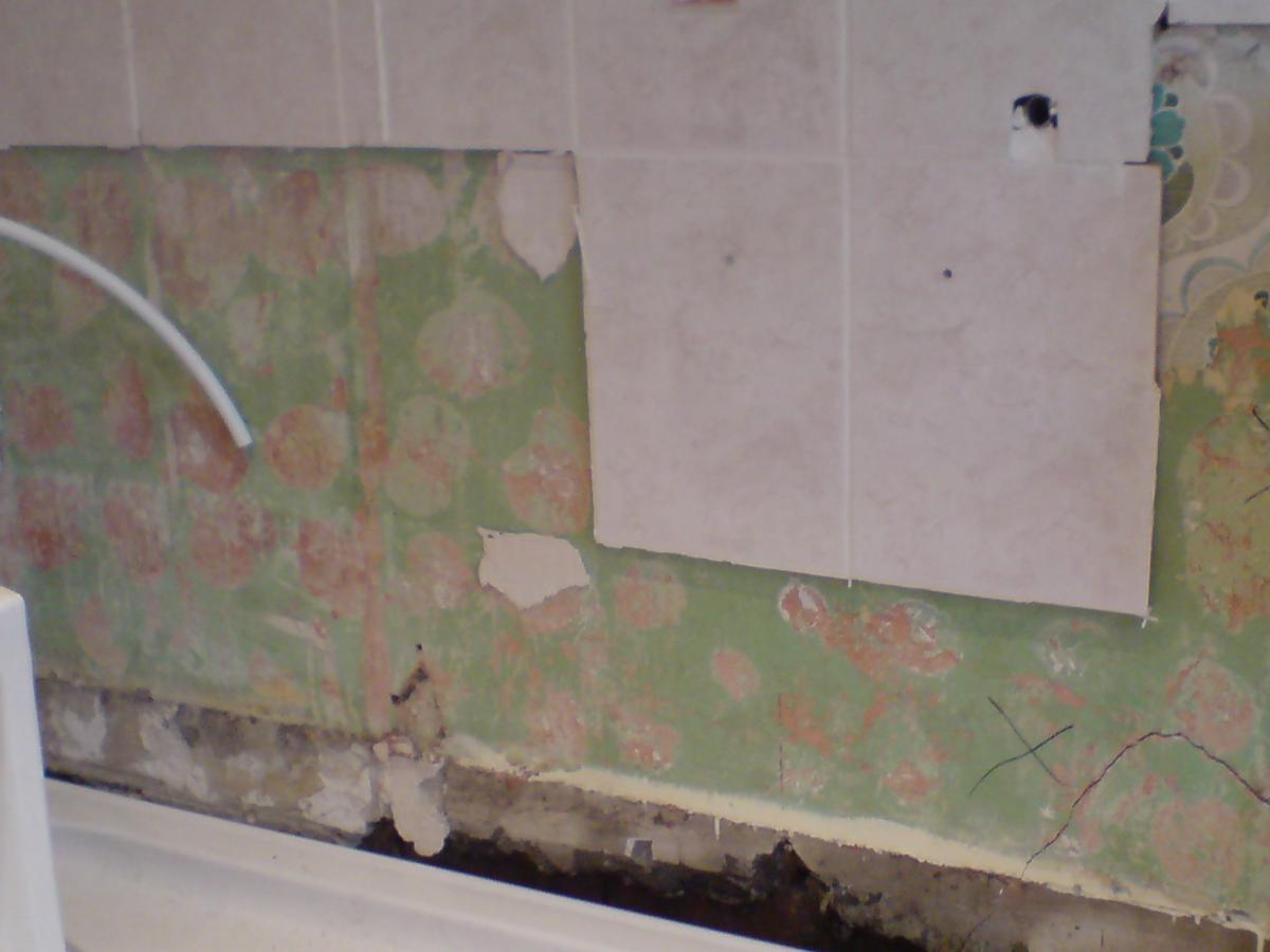

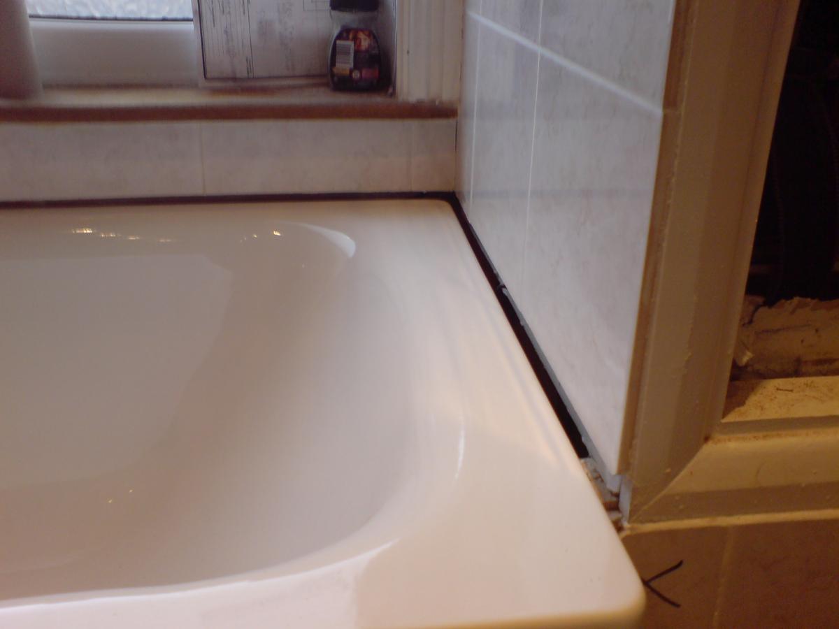

These are from a bathroom i got called to repair, there were big holes in the walls behind some tiles where boards werent big enough and the fitter could be bothered to cut them to fill gaps, there were slots cut into tiles filled with bits of wood to screw the shower screens to, which had been done in the wrong place and so left exposed, dot and dabbed tiles falling off all over the place, the void between the wall and shower tray some 8" wide and 4" deep by 2' long had been filled with expanding foam then tiled over. Areas of grouting missed completly and badly lipped tiles. Afew tiles had been stuck on with no more nails!
tilersforums.com | Tile Forums | Tiling Forum - Oli's Album: Rogue Trader
http://www.tilersforums.com/members/oli-albums-rogue-trader-picture1207t-no-Silicon-where-floor-meets-wall.jpg

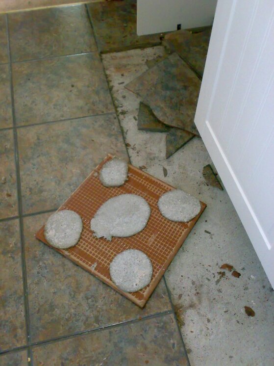

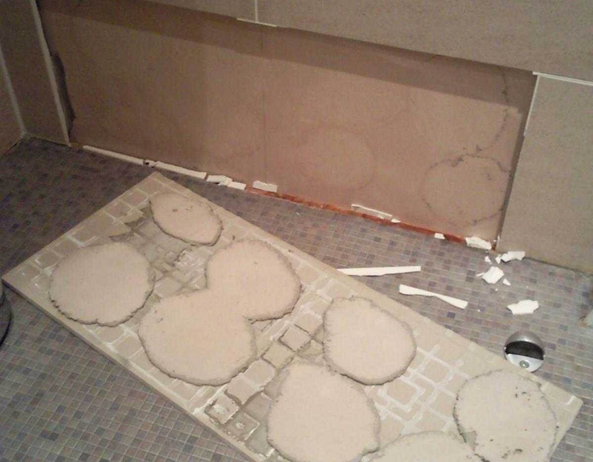

Kitchen floor tiles...virtually zero percent coverage. My guys demo'd about 600 sq ft with a shovel and a wheelbarrow in about 2 hours. The entire floor was like this...I don't think we found one tile that was well bonded to the concrete.
From the little I can see there it looks like the grouting wasn't too bad. Such a shame they didn't stick them down properly before grouting.

Hi CC,
Some of the grout was so soft that it could be scraped out with a plastic scraper or something similar. There were a lot places where they grout had holes in it or was otherwise not filled for a flush and solid joint. These guys had used muriatic acid on the slab in an attempt to remove glue from a previous laminate floor, and all it did was ruin everything in the condo that was metal-the window frames, all the appliances, the locksets, the ductwork, etc.

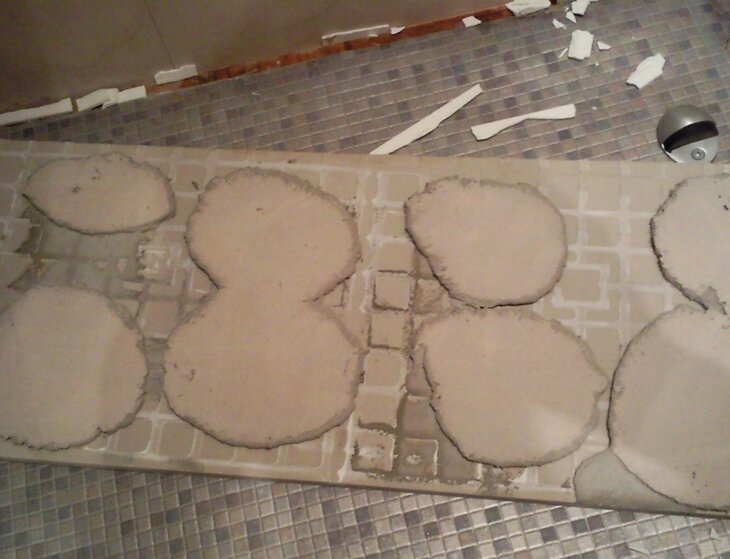

Here's one I started today....

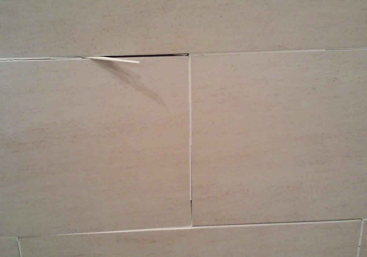

Oddly enough, it took all day to get the floor up - only 12sqm.
I managed to get about a dozen off cleanly like this, the rest fought back, slicing my wrist and sending splinters into my arms :11:
The customer said she thought something was wrong, as the tiles "sang" when she swept them.
Floor lasted 12 years with no breaks - spot fixing: it's the future!
