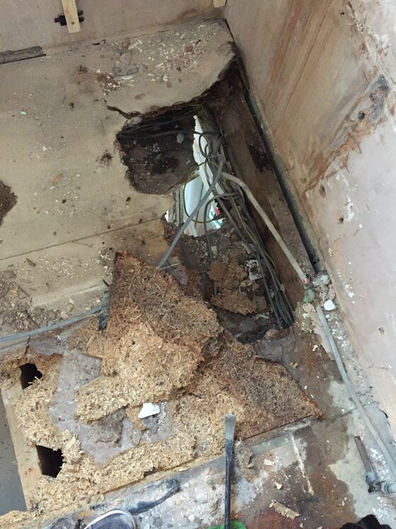

Here's a bathroom I ripped out recently, the floor was chipboard and hardboard, completely soaked through and leaked through causing a huge hole in the ceiling below. Why do people do it?!
Ended up replacing the entire floor with 25mm WBP ply.
