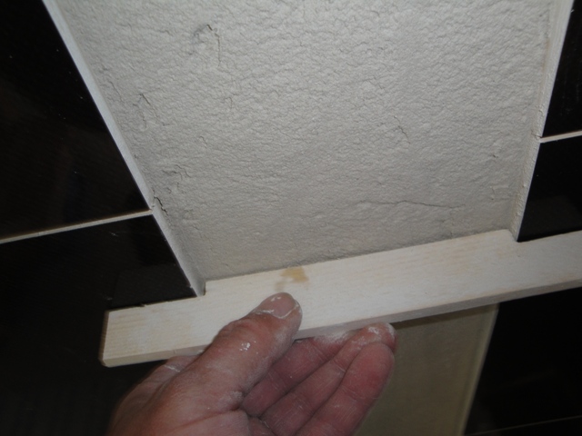

As TJ above for me, the template John refers to is like this, but horizontal instead of vertical, same principal.:thumbsup:
