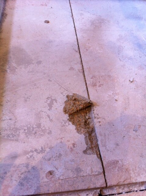

am doing a job for a customer whos builder made a **** up on a massive scale by getting a tiler to tile directly on to an anhydrite screed having not sanded it and used cement based adhesive , it failed i had to re-tile it also the same builder tiler tiled in a separate part of the house onto (loft board, partical board )its tongue and groove greeen in colour 22mm thick as a waxy coating ( see attached ), now a tiles also cracked on there and i've taken it up to change it reviling this board , now i have always been under the impression you can not tile directly onto this board and always over plyed . am i right if so the whole floor is doomed .
thanks looking forward to your comments
