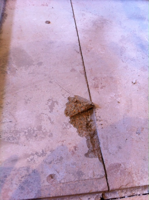

Following on from my question yesterday i have now found out what correct name for the the green wood chip looking boards in the pictures attached (partical boards )
the builder still says that these can be tiled striaght onto please can anyone tell me there thoughts on these boards
thanks shaun

shaunylocks
as it happens its already tiled theres part of a60+ grand kitchen sat on it,i tiled a separate part of the house and got asked to look at a cracked tile , when i took it up i found it had been tiled directly onto these partical boards, i raised my concerns with the builder , who obviously would not want to admit its wrong as this would mean havin to remove part of a kitchen to get the tiles out ,also overboarding would mean raising the hight of the floor its level at the moment with the 50m2 floor i've just tiled on the ajoining room , which i may add as been re-tiled by me already cos he got the same muppet that tiled onto the partical boards tile onto an anardrite screed without sanding and using cement based adhesives ,it failed and the builders already out of pocket putting it right , which means hes not going to want more cost coming his way .
shaun
DO NOT tile on to this board Shaun. Disaster waiting to happen. It needs covering with a relevant backer board prior to tiling otherwise YOU will be going back to sort it and not the builder
As John said, it needs over boarding, any movement and they will blow...
