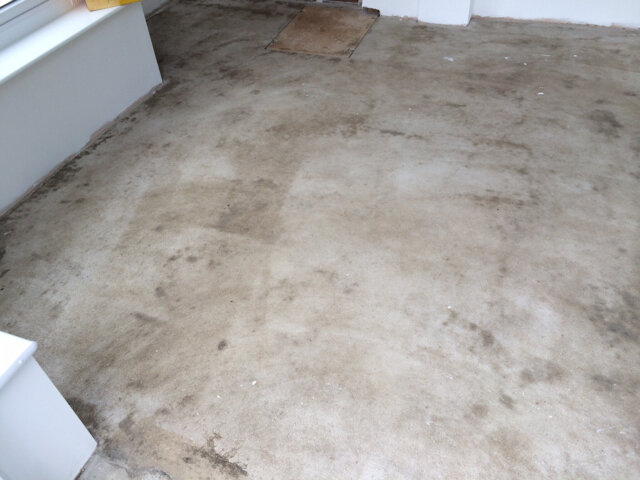

I had a conservatory job last week where the builder had integrated a manhole cover in the screed.
The floor I laid consisted of marmox, UFH, SLC then tiles so as you can imagine the height was soon increased somewhat!
Here is what happened....

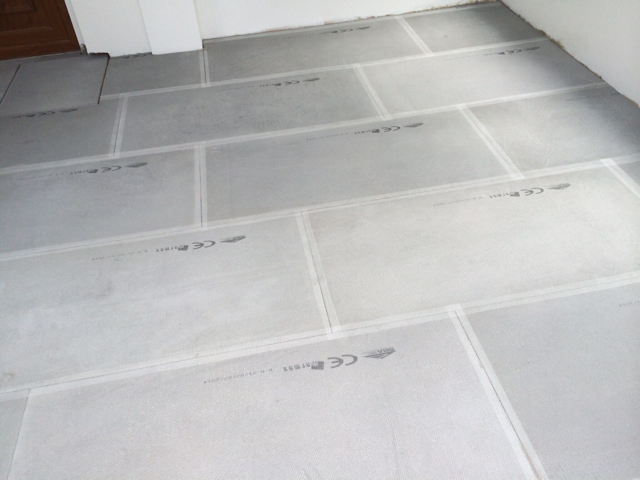

Marmox

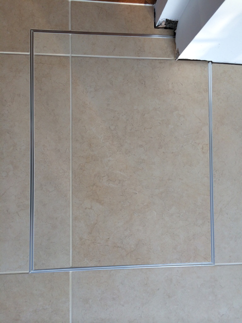

Genesis 12mm square edge trim cut on external & internal of drain
Grouted (& silicone around perimeter of drain)
The whole panel is then easily removed by slicing silicone in between the trim and attaching a suction lifter and pulling out whole tiles cover

Marmox

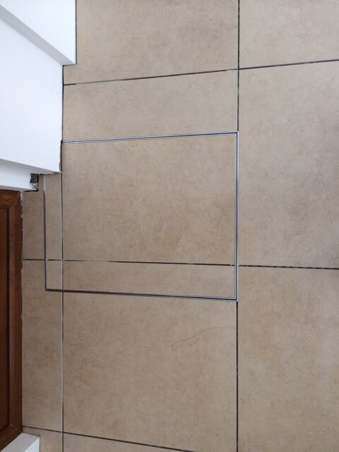

Tiled
