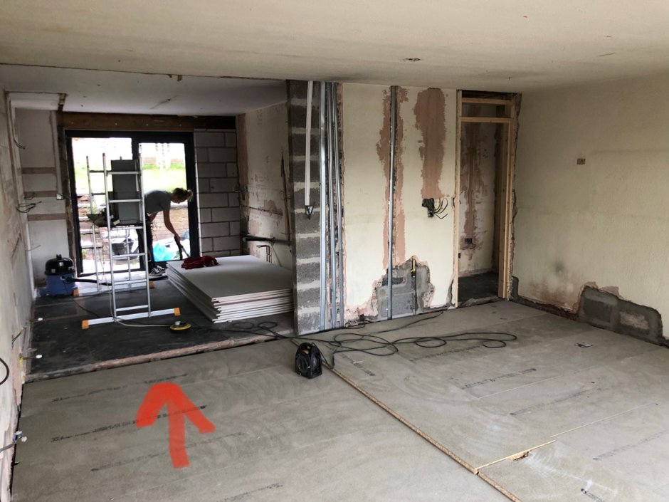

Im tiling my kitchen and lounge, the lounge is 5m x 5m and is a wooden floor with a RSJ support in the middle and the kitchen is 3.8m x 2.7m but is a concrete floor. (Pictures below)
The joists in the lounge have been reinforced by sistering the joists and installing noggins.
The kitchen is 25mm higher than the lounge with 22mm P5 T&G particleboard installed.
I want to tile the whole lounge and kitchen with 600mm x 600mm porcelain tiles.
The water-resitant particle board hasnt been installed yet, it has just been laid down for the plasterer so it can be changed if needed.
My plan was to:
Install the particle board
Use a cement board backer board on top
Use self leveling compound with a wire mesh to bring the lounge to the height of the kitchen
Install a ditra membrane for both the kitchen and lounge.
Use a flexible tile adhesive
Then tile
Does anyone have any suggestions on what I should change or how they would do it differently?
Any help would be much appretiated!
Many thanks,
Ben

Install your p5 and the 6mm Hardie backer
In lounge fix an insulation board to build up height but keeping the weight down .I would think 30mm thick.
Understand 30mm of levelling weighs 51kgs a square metre .
Then level to take out height differential between rooms .
Make sure you have a movement or soft joint between the two rooms
Didn't think of the soft joint between the two rooms, good idea!
It's nice to know i'm on the right track then. Thanks JCR
