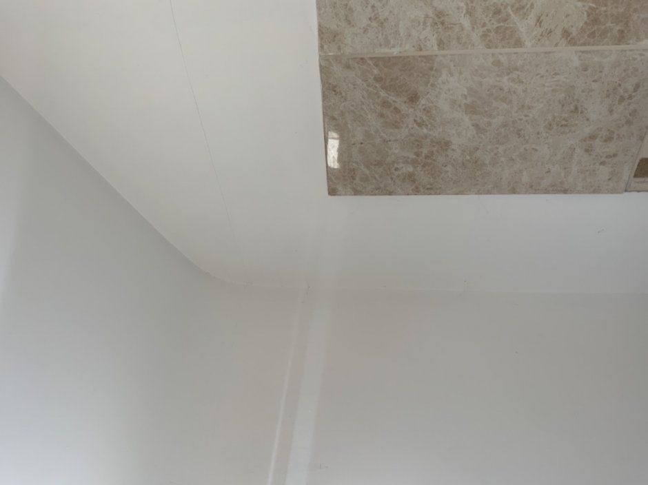

Hi,
I'm about to start renovating my bathroom, but I'm not sure how to join the tiles from one wall to the next since the join on one wall to the ceiling is curved, so I don't have a neat edge to tile up to. The picture I've attached shows my bathroom. The current plan is to tile to the ceiling on right wall and tile to just before the curve on the other. I'm just worried it will look a bit messy.
Has anyone got any tips, any help would be greatly appreciated.
Steve

You just need to consider it in the setting out and use a good wet cutter to shape each tile. Can use cardboard or something to get the shape right first then transfer that to the tile perhaps.
