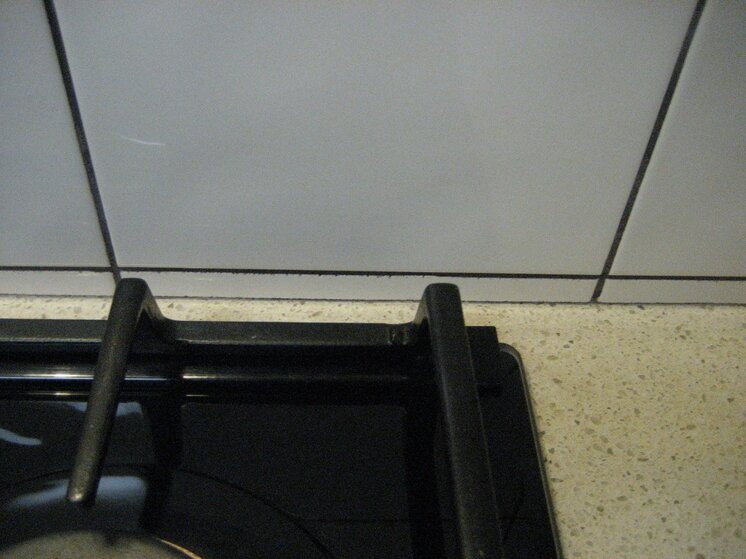

Those thin pieces along the bottom turned out to be more like 13mm than 19mm. Perhaps it's also easier to see why putting them where they are was the "least bad" solution. Also, I did need the tile saw to cut those. No way the Sigma currter was going to do anything that thin.

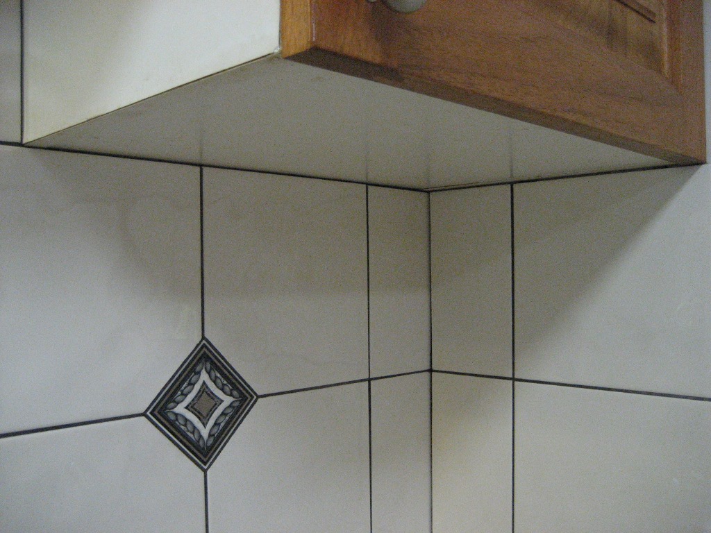

One thing that turned out well was my bevelling on an outside corner. This was tricky, but I am pleased with the result:
One thing I was less pleased with was the fine chipping on the top edge of my sliver cuts showing up the coloured grout. Originally, I had bee planning to use a light colour grout, but changed the plan to a dark brown after the tiles were up and could easily see what a dark grout would look like.
If I had known I was going to use a dark grout, I probably would have used only finished edges (would have meant I'd only get two slivers out of tile, but what the hell... they weren't expensive tiles.)
Too late now. Fortunately, the "customer" (my wife) doesn't think it's really a big deal:
Still, any cover-up "cheats" that people know to hide fine suface chipping in the glaze like this?

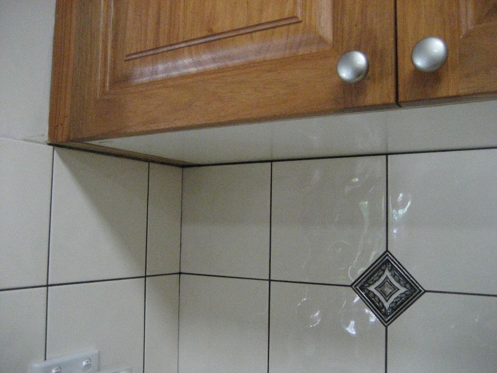

The other thing I discovered working from the bottom up was that the benchtop (inevitbly) was not perfectly square to the bottom lof the overhead cabinets --- it drops off a few mm moving from right to left. This resulted in a bigger gap above the tiles on the the left hand side compared to the right:
If I had realised, I might have tried adjust in the size of the slivers to get progressively larger moving left to right, but maybe that would have looked even worse, In any case, I'll try to disguise the discrepancy with silicone to some extent.
