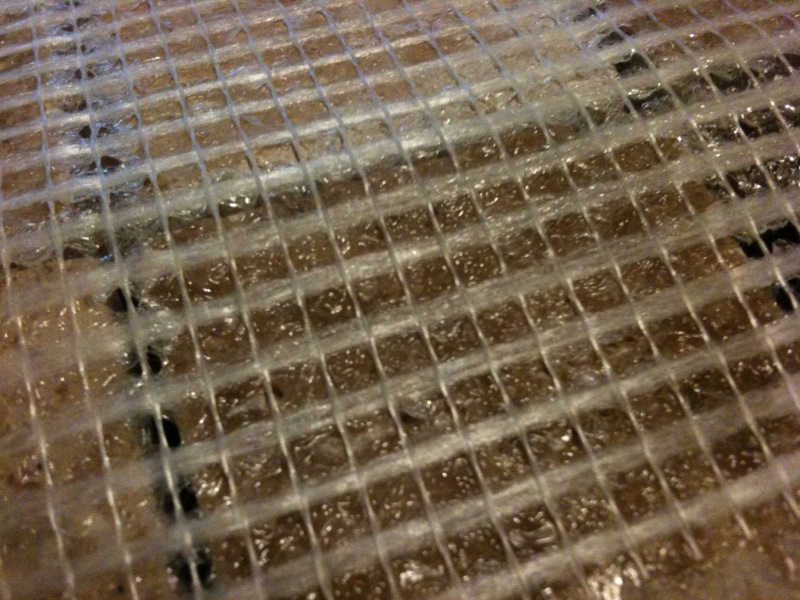

Thanks all for your responses. Please find attached a picture of the back of the tiles. As you can see (I hope) the glue glistening in the holes in the mesh. On the right of the picture you can just about see where I have pulled off a tile to leave the mesh and a fair amount of glue 'film' in the holes.
Thanks again,
Joe
Check that all the tiles are of the same batch ie if you have 35 sheets make sure the 5 loose sheets match the others.
This backing mesh glue is of a material that will hold the weight of the tiles and mesh together so use your cement based flexible white adhesive as normal -6mm trowel. If the tiles are easily removed from the mesh take the sheets back as they are not satisfactory for your purpose.
When fixing make sure all the joints are in line and it does not look like 30cm sheets of mosaic - run a plasterers trowell through the horizontal grout lines and pat flat with a mosaic block. You can either peg the joints if they slip or use a long panel pin type nail to take the weight until set.
All other points have been answered.
Enjoy!
