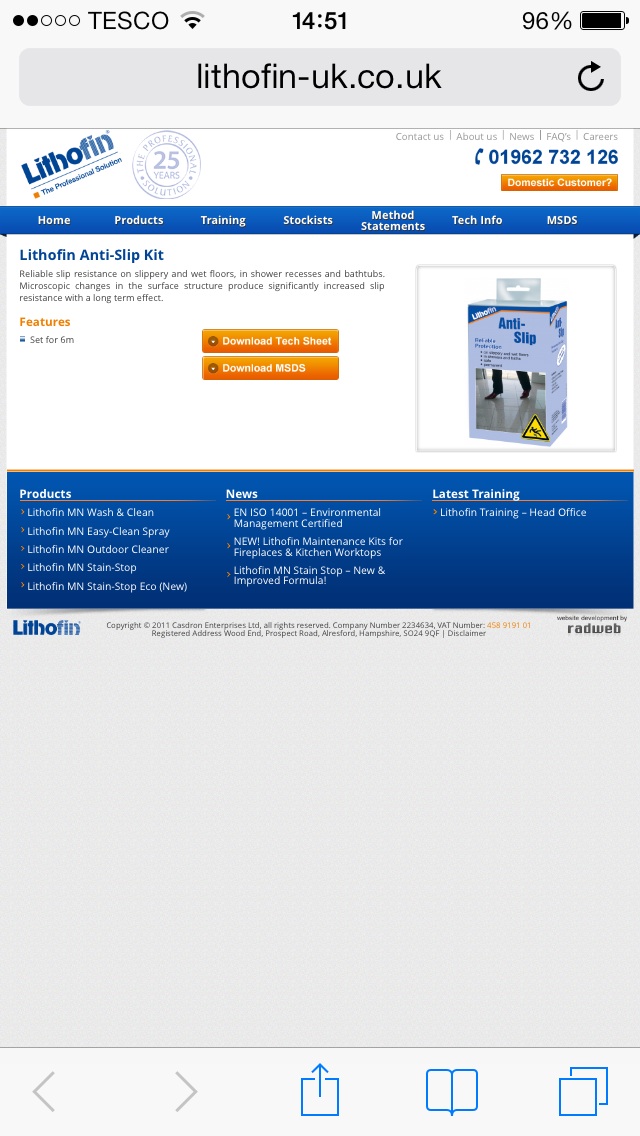

Not used it personally but might be worth a try..

It's a common misconception that all polished stones are slippery, most decent stone suppliers will be able to give you the slip resistance rating of their stones, on larger contracts I have had stone tested, you could do this if you have concerns. Their are also products on the market that will enhance the slip resistance of a stone, widely used over in the states, I haven't used them personally so can't vouch for how good these are.
I have seen some non slip products advertised but didn't know if they would be suitable and if they are really as good as they are cracked up to be. I am nowhere near as experienced in tiling as many of you fellas so I would be reluctant to try something that nobody on this forum has used. I also don't know if they are available down here in Spain anyway.
