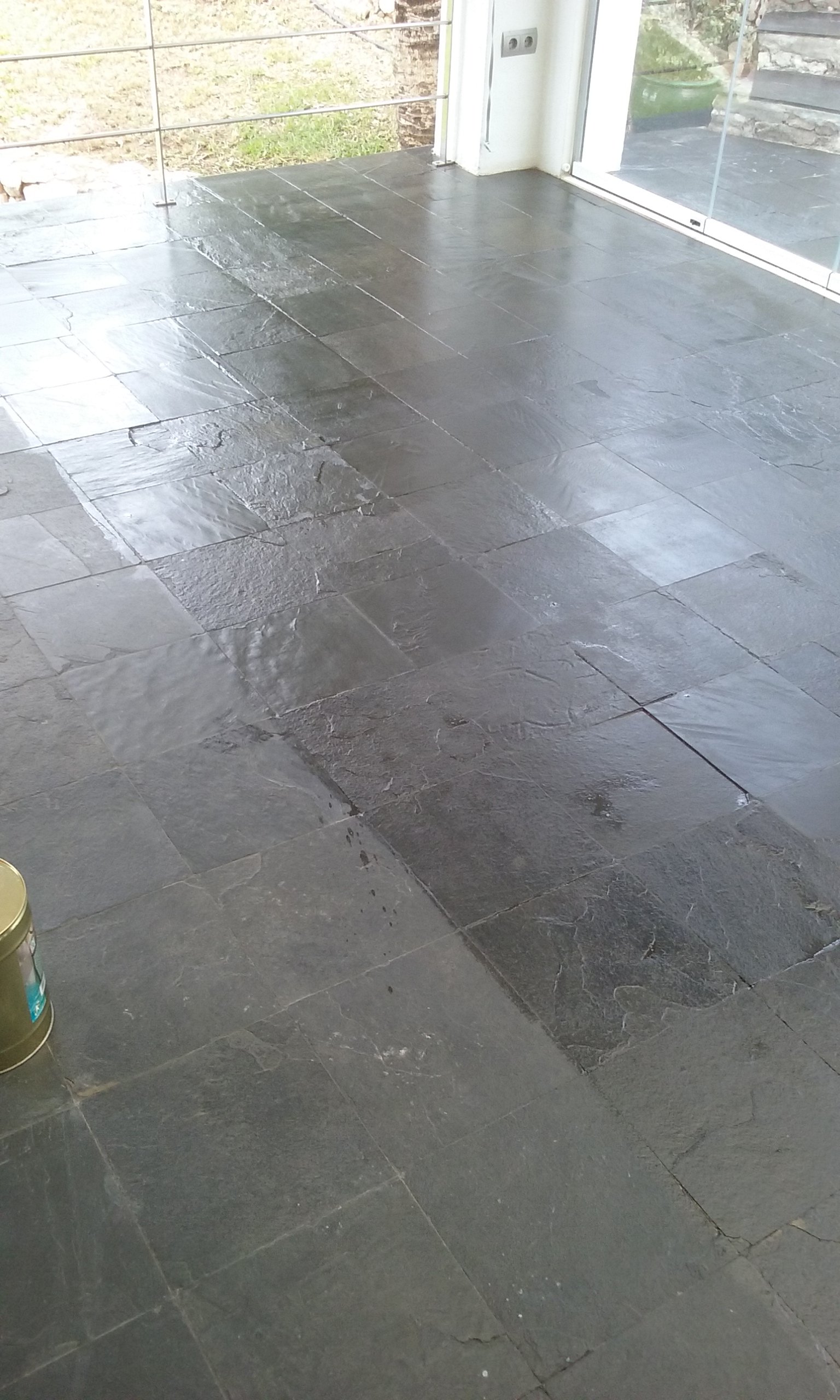

Can I get Lithofin here in Spain ( no my Google isn't working)
I've just sealed a slate terrace but it looks a bit "wet" for me 20150609_133832.jpg
