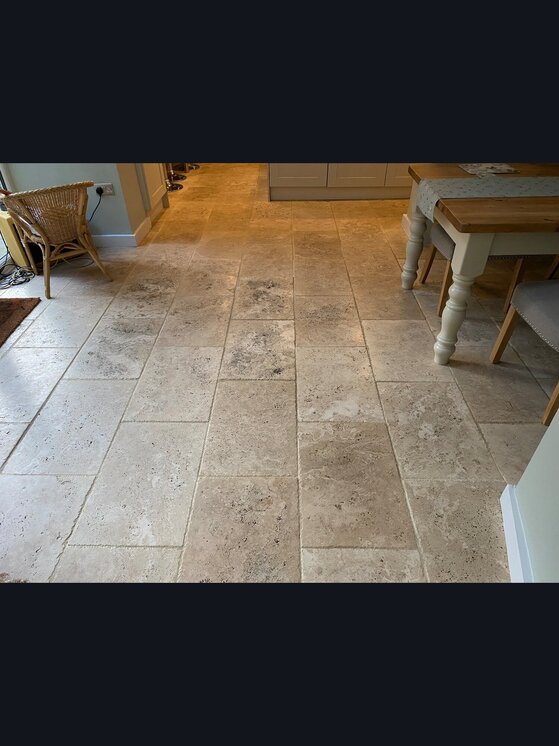

Hi. Can you post sone pics so we can see what you gave and type of travertine

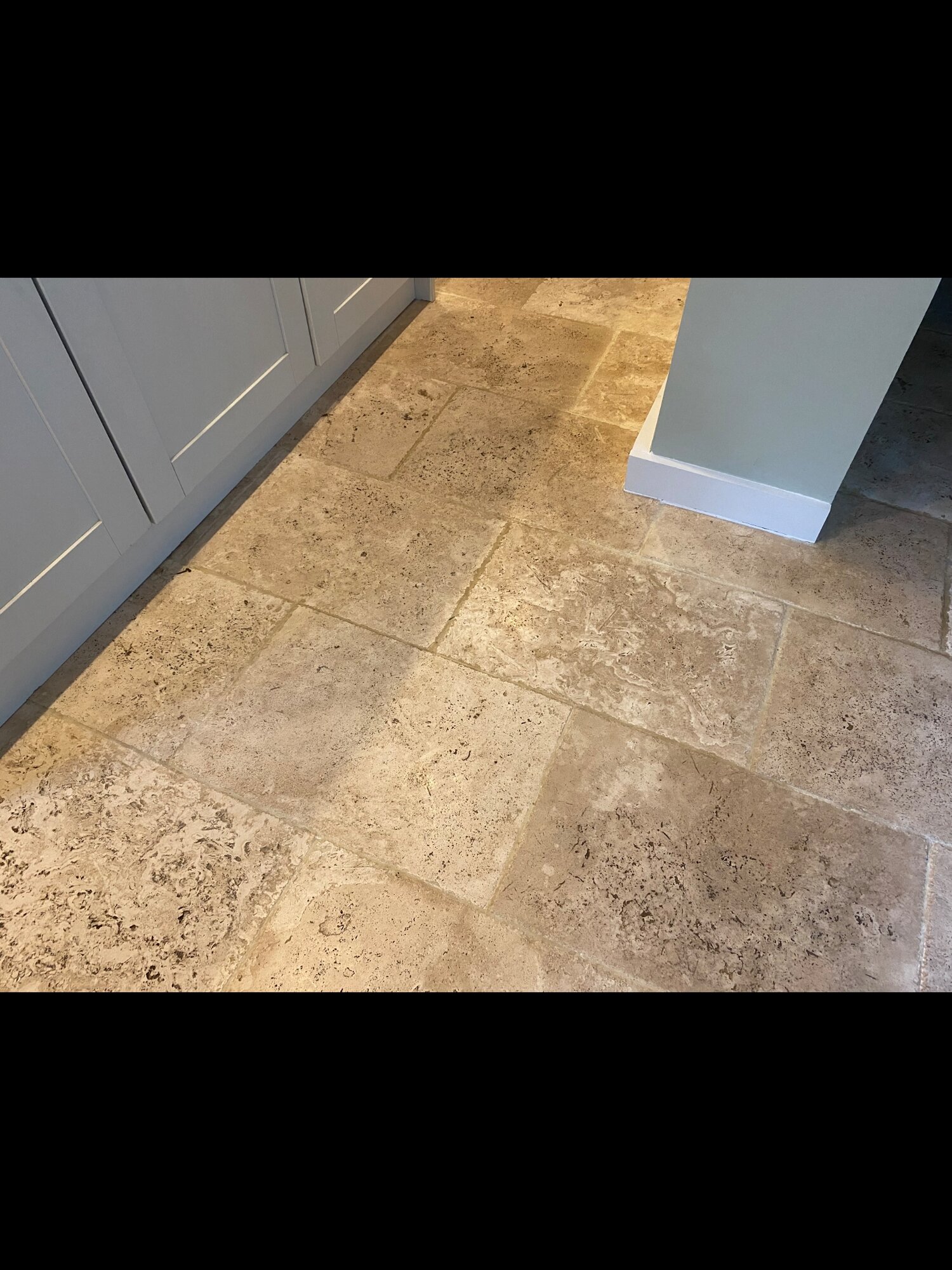

As you can see it's quite pitted in places. I intend to clean, grout and seal. Luckily I work from home so have more time than most to do it.
Cheers. Strip the floor back with Grimex. Use an emulsifying pad or soft bristle scrubbing brush.
Rinse floor and leave to dry and see if any bits need further attention. Then you can see if any grouting is required. Once clean and dry (48hrs). Seal with lithofin stain stop. I don’t recommend a topical sealer on high foot traffic areas.
Thanks. I plumped for LTP Mattstone H20 as it impenetrates and is low odour compared to others on the market. I'll get the Grimex.
There'll be plenty of pits to grout, the floor is full of them 👍
