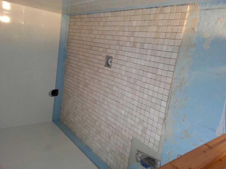

Hi All,
I was asked to fit these tiles onto the former and floor of this wetroom, being new to tiling formers I tried to work it out but always ended up with very small corners cut off...I think it would have been a knightmare, would anyone have attempted this one?
Customer is now going to buy mosaics! so hopefully they will be somewhat easier to lay...probably a stupid question but when using mosaics if they are the bigger ones would they need to by cut to lay on the former..I have read that the smaller ones do not as they 'mould' into the contours..Hope this is right, again any help very much appreciated..this room was fun to tile...not:lol:

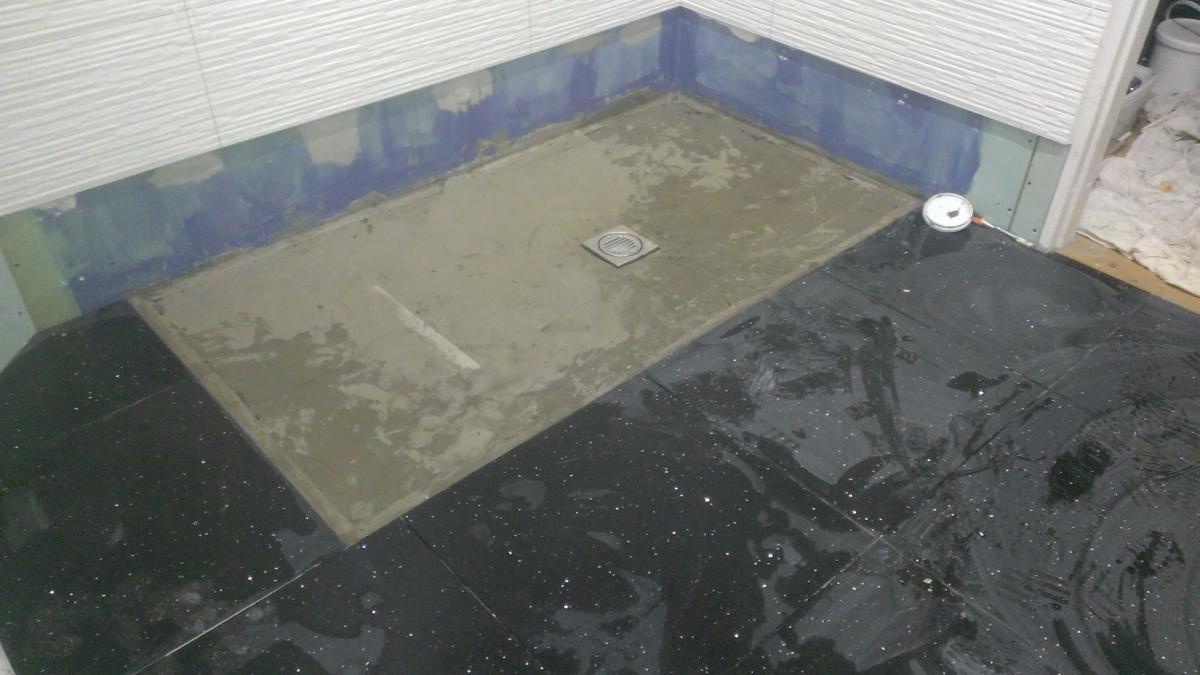

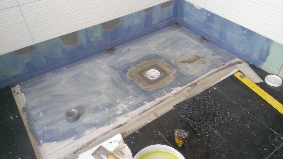

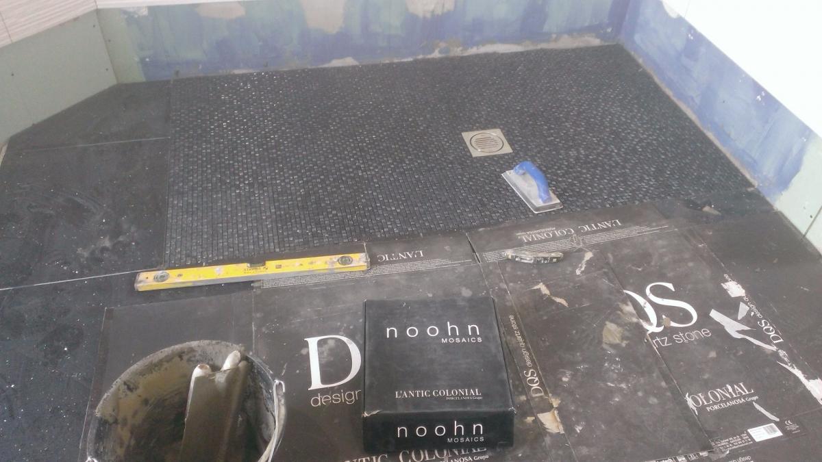

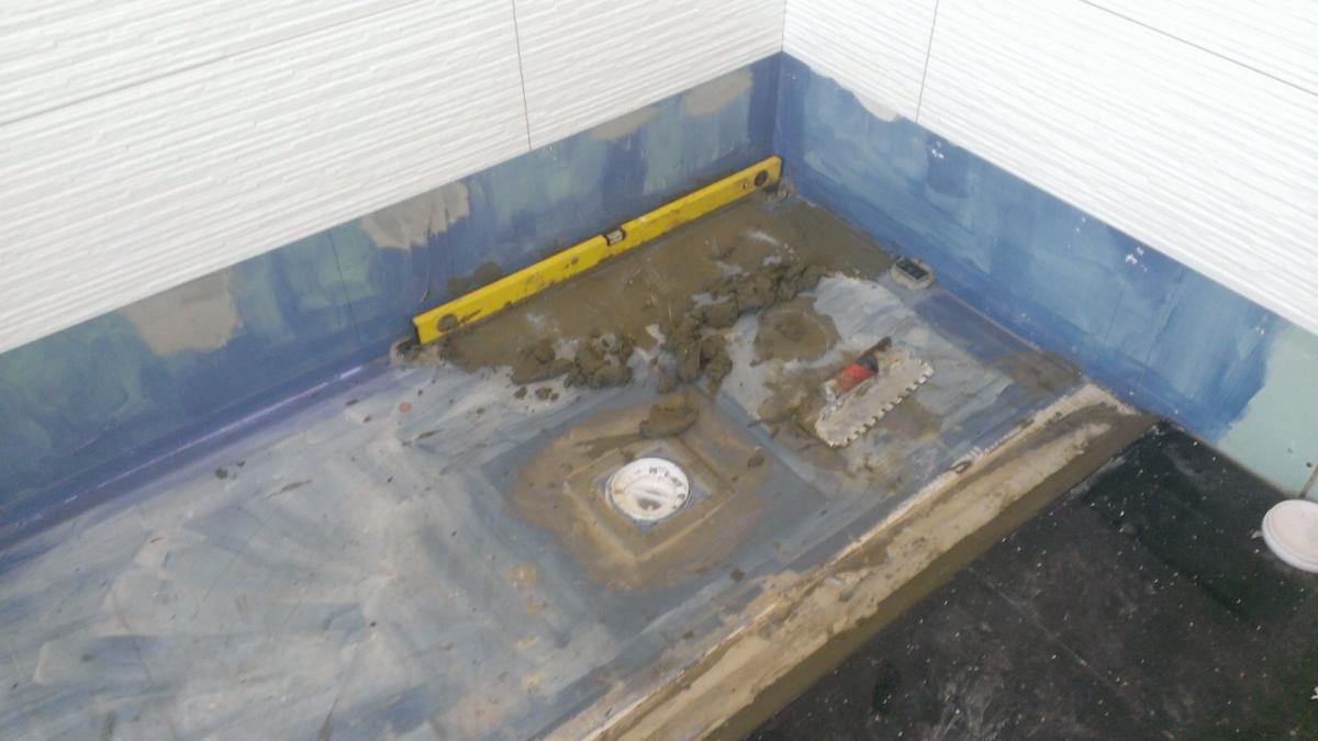

Mosaics do dot need to be enveloped if that's what you mean, they will mould to the fall as they are all broken and can move independently. However, you will need to use a much thinner bed of adhesive with mosaics or it could end up very messy, so you will need to screed the fall properly before you tile, I will try to attach some pics...
Mr Tiler
charlie1
Thanks mr t
Ok, to create a screed you need two things... Screed runners to form your screed.
to make a screed runner you need another two things, ... Dots
dots can be set using a laser, then rapid set between the dots and you have a screed runner, rapid set or sand cement or slc between the runners and you have a screed. What is a good screed... One big flat 'plane' to tile on
You you can make anything using this technique.

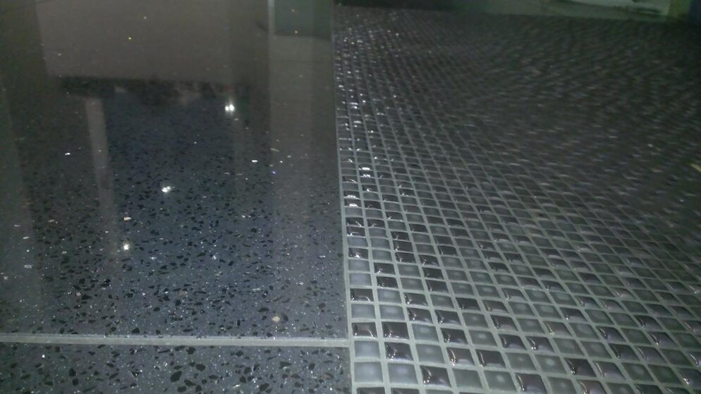

You you need to think of tiles not as tiles but large sections of tiles locked in to 'planes' , eg place a 2m straight edge on a tiles surface and all the way along the tiles will be in contact with the tile face.... Then these tiles are all on the same 'plane'. When you create a plane for let's say a floor you can break the plane of the tiles to do what you want, maybe loose height to get under a door for example or gain height to come level with another surface, all this is done by breaking the plane of the tiles, that's what your doing creating a fall in a wet room.
I don't expect you to grasp what I'm describing mr t but at least you are inquisitive enough to ask. I'm not on here all that often but I see more people giving you more credit for your enthusiasm, keep asking questions and listen to the right ones and I bet you will be doing work beyond your expectations. There are plenty of tutorials on youtube showing you the basics of screeding, once you practice and master it then the tiling world will be your oyster. Just remember "plane"
Mr Tiler
ive had to read this part 3 times and still havnt grasped it fully lol i do have a couple more questions before i sleep on it and thanks in advance mate very insightful...
1) firstly in you demo pics once you have screeded onto the former, is that a level surface or have you 'broken the plane' as you say?
2) and when you say breaking the plane im assuming you mean slowly sloping down from the original floor height as that is how it is in my head or do you mean level then drop level then drop like very long but small dropping steps (if that makes any sense what so ever lol) mind you i suppose that wouldnt work as it would create lippage.
thank you for taking the time bud :smilewinkgrin:
charlie1
Yes ive broken the plane. Field tiles are level then mosaics are sloping towards drain.
correct!
no problem mate
Charlie, many thanks, your advice invaluable:smilewinkgrin: I get the planes thing..dont have a lasr yet but guess a level will b ok...any tips on setting the drain level..what would u allow for adhesive. ..? 2/3mm? And 3mm notched trowel? And use float to press in...sorry so many questions just want to get it right..thankyou for your time..Lee
