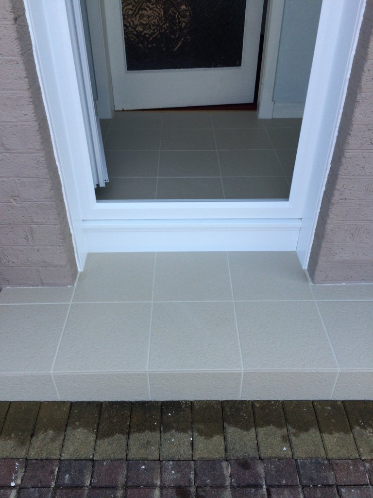

Done these last week Nero granite beige.
Only sealer I used was for the grout.
