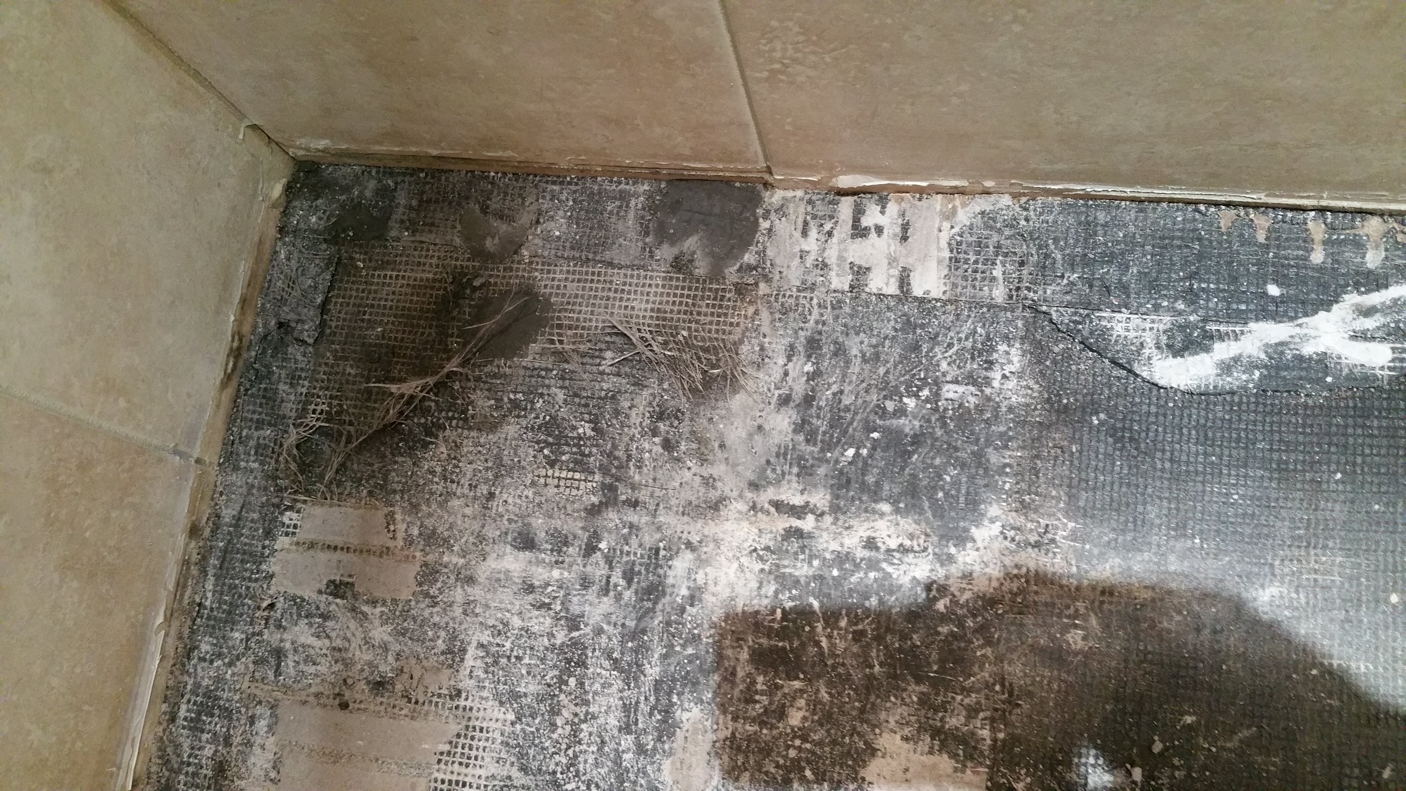

I am trying to fix some broken tiles in a couple of wet rooms in a customers house. When I took up the first few tiles they seem to be on some kind of rubber/ bitumen elastic membrane which I have never seen before. Have any of you seen this before and how should I go about fixing the new tiles? I have attached a couple of photos.
This membrane has been fitted directly to the chipboard and the tiles were loose. Some others have cracked as predicted as they were fixed directly to chipboard! Unbelieveably the customer has 6 bathrooms all tiled the same way and the hall is also tiled directly onto chipboard! The customer knows that the new tiles will crack as well eventually but just needs a serviceable short term solution.

We concentrate a bit too much on what it is. When the solution is the same.
If you want to tile in there, that needs to come out and you want to ply it, waterproof it, and tile it.
Doesn't matter too much what it is now its destroyed.

The black stuff is a cement based waterproofing coat. Such as ardex WPC.
Unfortunately there is no shirt term solution. If the waterproofing is compromised then it's gonna leak.
Certainly if it's on chipboard too.
If your client isn't looking to redo the wetroom then the only solution other than a rip out is to install a shower tray in the area. One with is on legs, breakout the floor to extend the waste.
Still bot a small job, but that wetarea if not sorted properly will force them to rip out sooner than they'd of hoped for.

I would agree - the only problem is that he has 4 wetrooms so big bucks - but maybe nice for me!
In the meantime though how can i fix tiles to that black stuff? Flexible adhesive like rapid set ?

Yeah Dan - I am only trying to do a short term fix - his other tiles were broken - because there is no sub floor or ply or ditra etc!
It's going to happen again if there isn't preparation too mate.

Thanks Bri - it looks like it could be Impey. I am just wondering what sort of primer i need for it - BAL APD or something else?
If you're winging it, just scrape it all off, sand it. Prime it and tile it.
But then what's the point of the thread you'd have done that anyway?
Surely if you show the customer it's going to happen again they'll want it done right? Which is cheaper long term?
