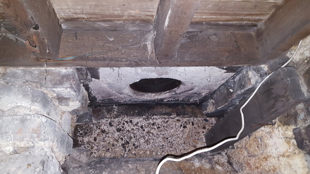

The section for the coal chute has been there since 1890 and is only around 3inches deep and then straight into the cellar.
Not sure what more we can do as it seems stable enough but the landscapers are reluctant to do anything to it andlooks as though it is wedged into the side walls for stability.
Removing that base would leave a massive deep hole into the cellar....
Chris101
Here is what it looks like underneath
