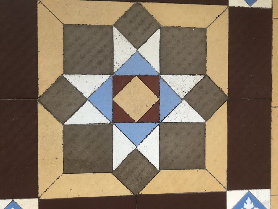

Dan - thank you so much for your reply. I don’t think it’s just on the surface as I’ve cleaned them a lot (my knees can testify to that) I attach a close up. Will definitely take your advice and try those two products. The wavy imprint seems to have been absorbed right into the tiles but I’m a bit scared of using anything that will penetrate in case it spoils the tiles so will definitely try in a corner first. Thank you. Here is the close up ..

Okay I see your point there. It does seem to be imbedded. Can you use a screwdriver or something to make a tiny scratch near a radiator or somewhere it won't be too obvious? Could do with seeing how much it has penetrated.
A good cleaner should be able to get most of it out, it'll need dissolve it though so I don't think the soapy ones are going to work you're going to need some chemicals on that.
The most serious of chemicals is going to be the brick acid type stuff: https://www.google.com/search?q=bri.....69i57j0l7.1319j0j7&sourceid=chrome&ie=UTF-8
But you'll need test it well first.
If they go dull that's not so bad as a sealer will bring them back up bright and clean, either shinny or matte you have the choice.
But you'll want to work up to that with lesser serious stuff.

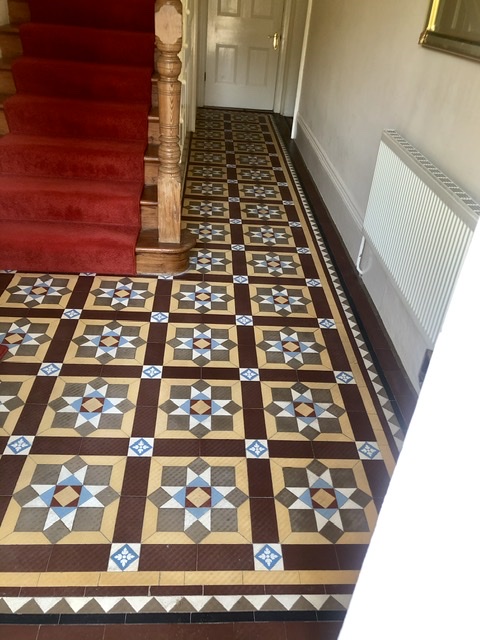

We see this problem a lot when restoring Victorian floors, the only we have found to resolve it is to use coarse burnishing pads on the floor, usually 50 grit followed by, 100 grit, then 200 grit pads.
