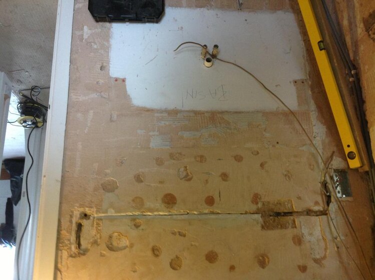

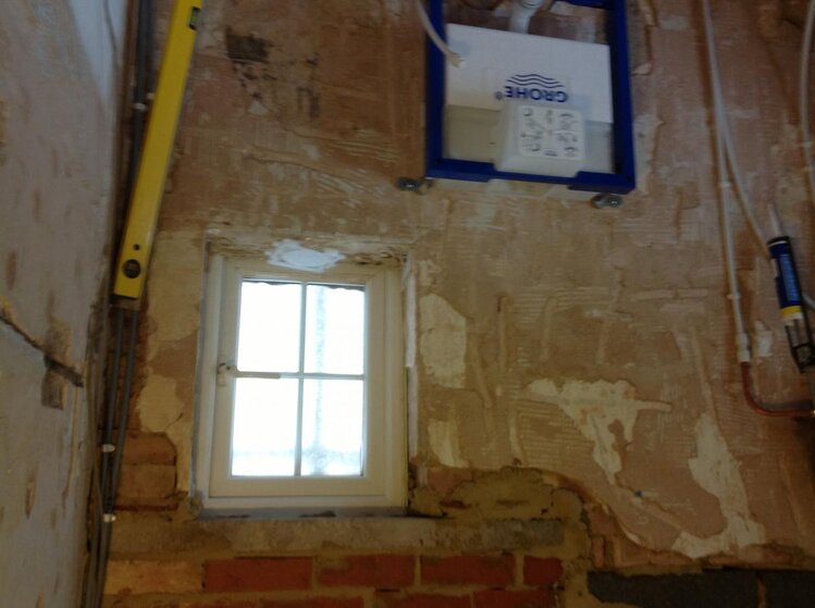

rj1884
Hi all. Thanks for your replies and conformation of what I thought. Whitebeam I meant its hardwall then a skimmed finish. This is one example of the wall that needs plastering.
