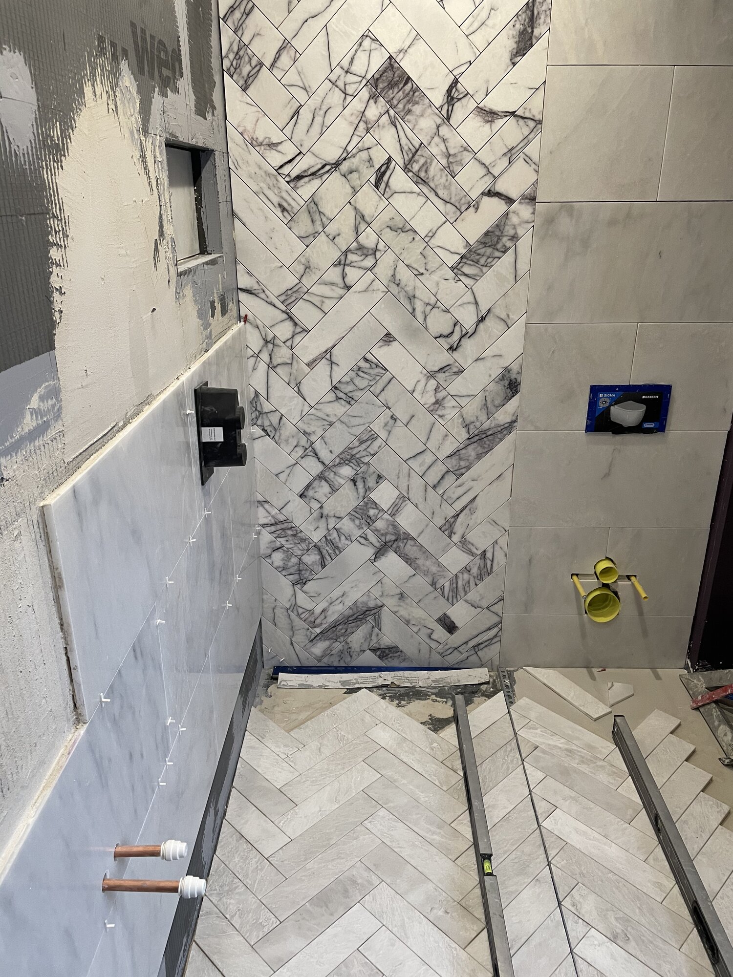

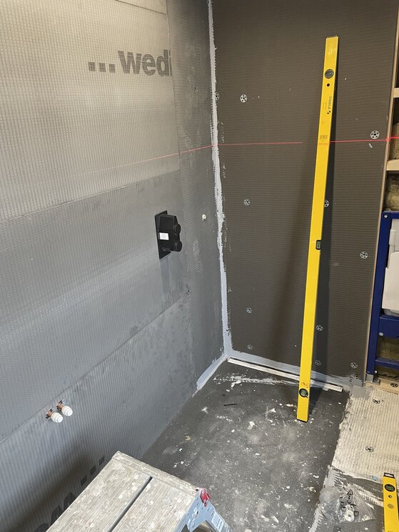

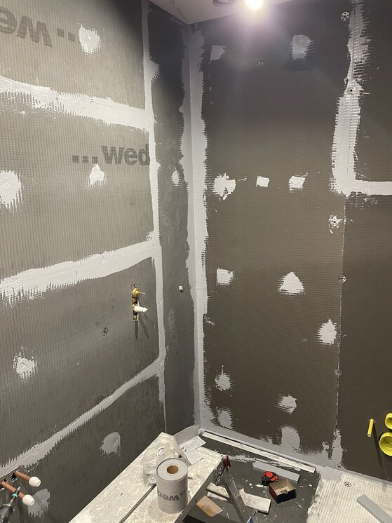

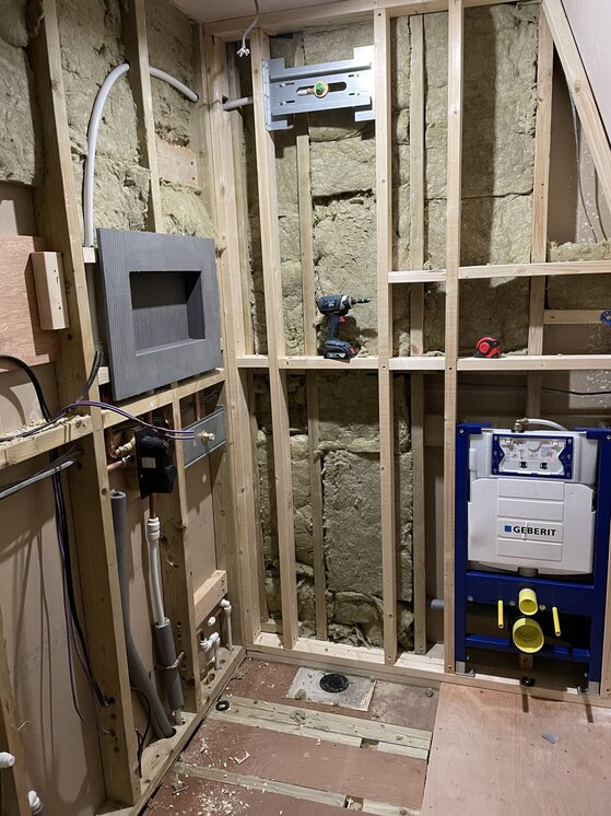

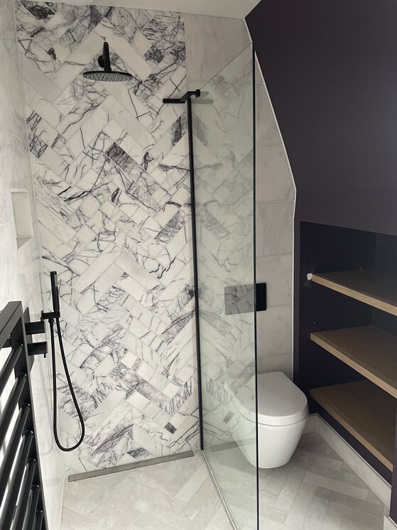

Hi, apologies, yes the install went well. Very easy to use, I went for a combination of the 610 and 520 in different areas in the end.
Tray was easy to install. My one comment for Wedi on this particular tray would be to suggest they make more sizes/make them more customisable in size to allow for specific site conditions.
I’ve attached some photos. Floor construction was 25mm ply screwed down every 100mm, Wedi 12mm boards, marble herringbone tile (from Mandarin Stone). Walls are 12mm Wedi board and (I think) 20mm on shower head wall to bring wall out flush with tray drain.
I did all the all construction, plumbing and wiring but left the tiling to Andrew O’Sullivan of AOS Tiling (who’s name I got from this forum). I would highly recommend Andrew as a great bloke and fantastic quality of product.
