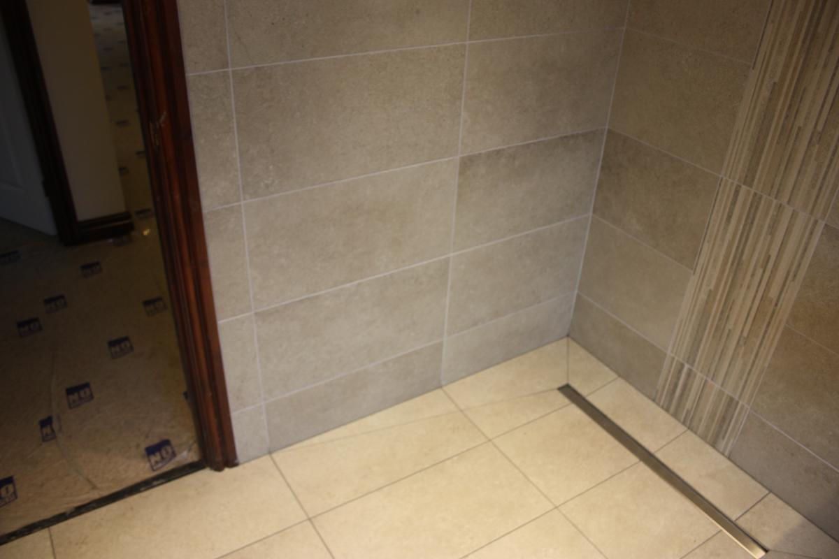

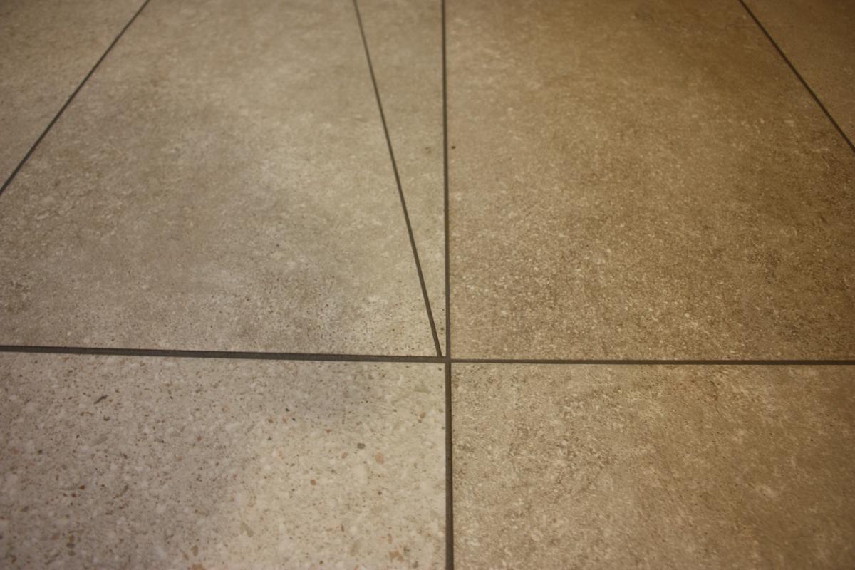

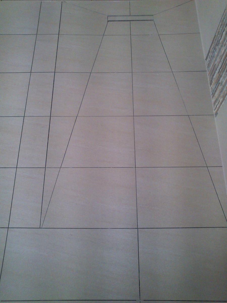

Has anyone tiled before, or even better have examples of a wet tray tiled with the above format.
Ive just finished setting the wet area tiles today. Although its come out well im not sure about the way different lines dart all over the place.
I set the room out rather than focusing on making the tray all symetrical. Its a cream tile and will be grouted in jasmine so the joints will be fairly well "seamless?"
Ian
This is before grout, I have a finished pic somewhere, I'll have to hunt it down.

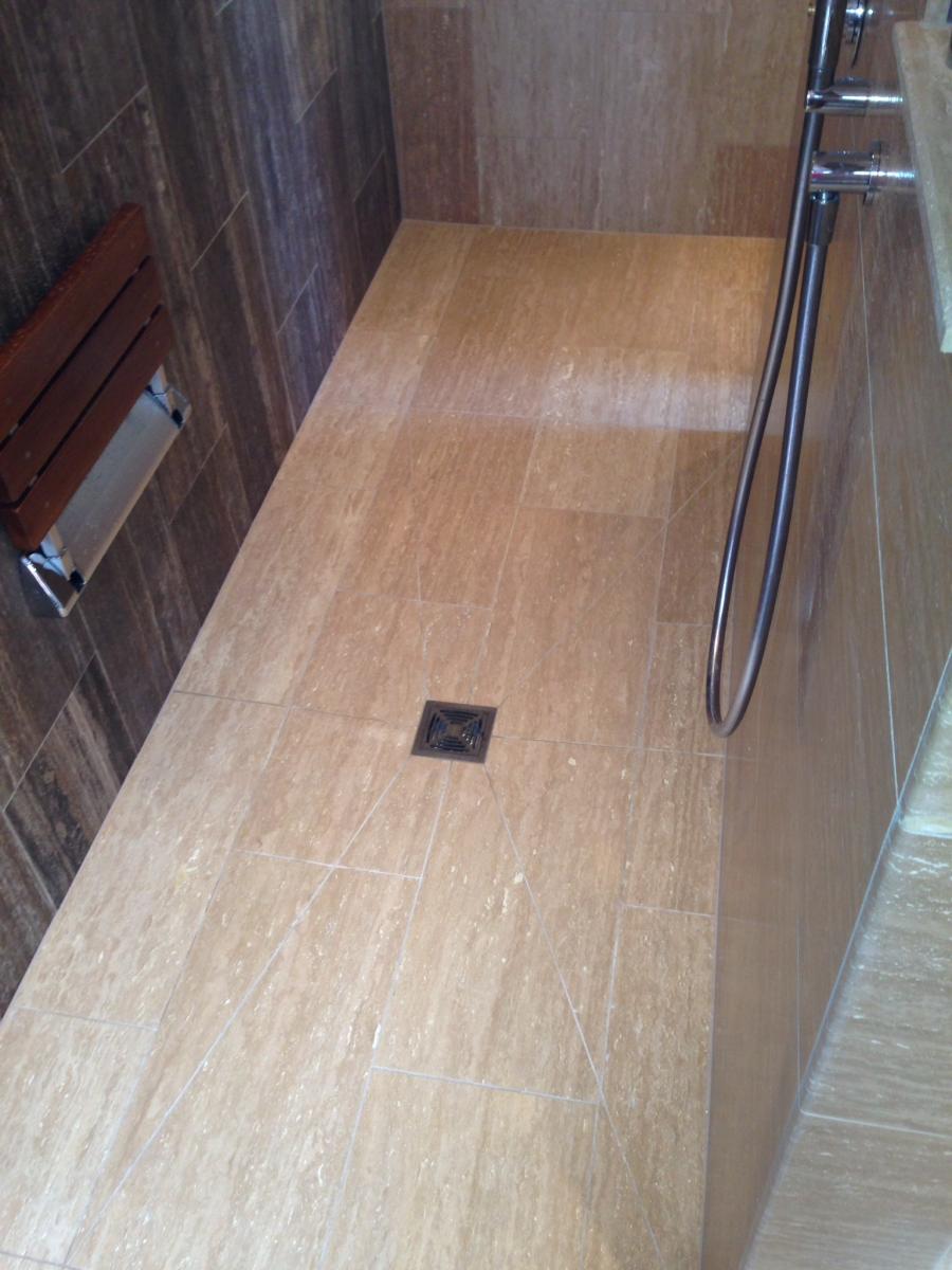

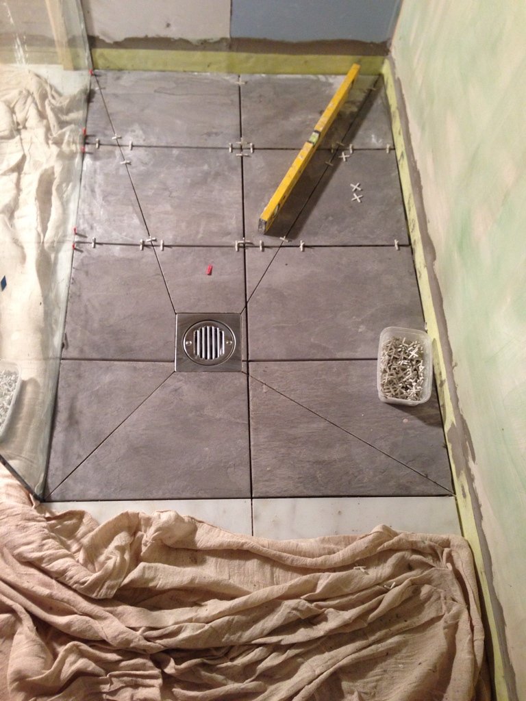

Here's another one, this is from my London job. The architect/interior designer insisted on everything being centred in this room, even though the wet tray had an offset drain (caused by joist positioning). Look at those silly cuts around the drain!!!!
I hate it when architects, or customers for that matter, dictate the setting out! You do your job, I'll do mine!!!
Ian
Does my head in too mate! What made me laugh the most was they had detailed drawings of where they wanted every tile placing but couldn't manage to order the correct amount! I had a quite heated discussion with her when she said I'd obviously wasted tiles, I replied by saying that on HER drawing there were 105 tiles and you've ordered 90! Some tiles were 40% waste due to centring, this hadn't been taken into account when ordering! This is what happens when people interfere with our job.

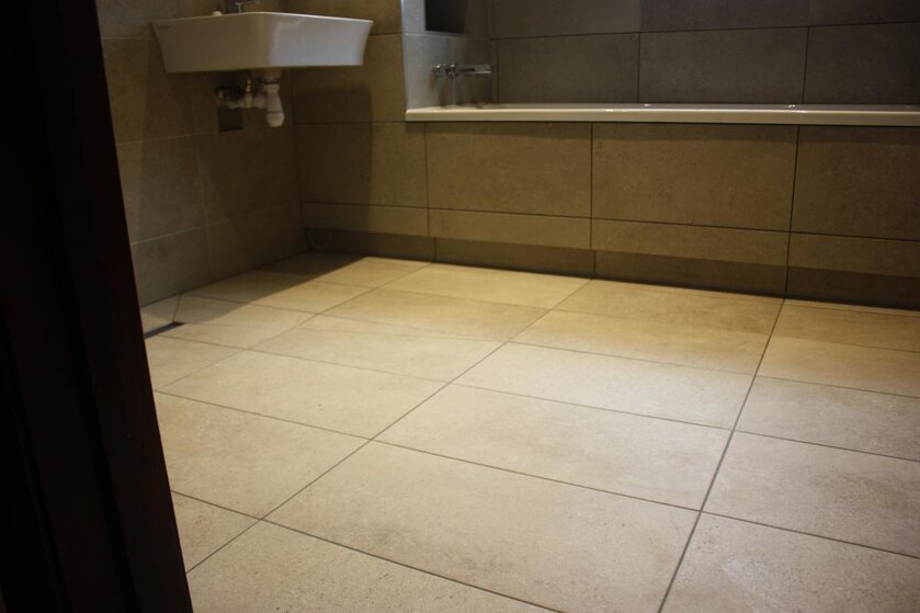

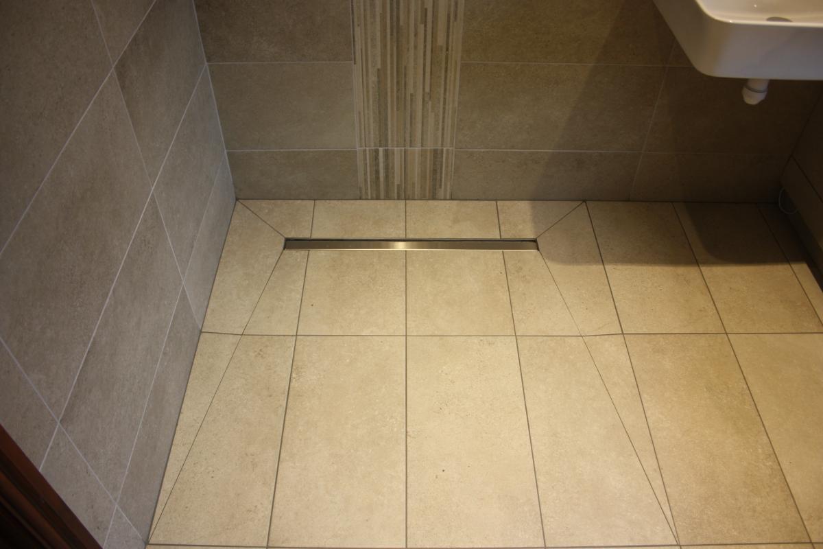

This is a linear drain with 600x300 tiles I've just finished.
This was made easy for tiling because I used a 1200x1200 tray
View attachment 58046 View attachment 58047
I've not done a linear drain yet, but I do like the look.. How do they compare, price wise, to your average former? Just curious, but what's the reason for the cut-back plinth on the bath? LED's?
Nice job by the way... ;)
Thanks Beans and well spotted with cut-back plinth, if you look at the pic you can see a wire for the strip lighting.
