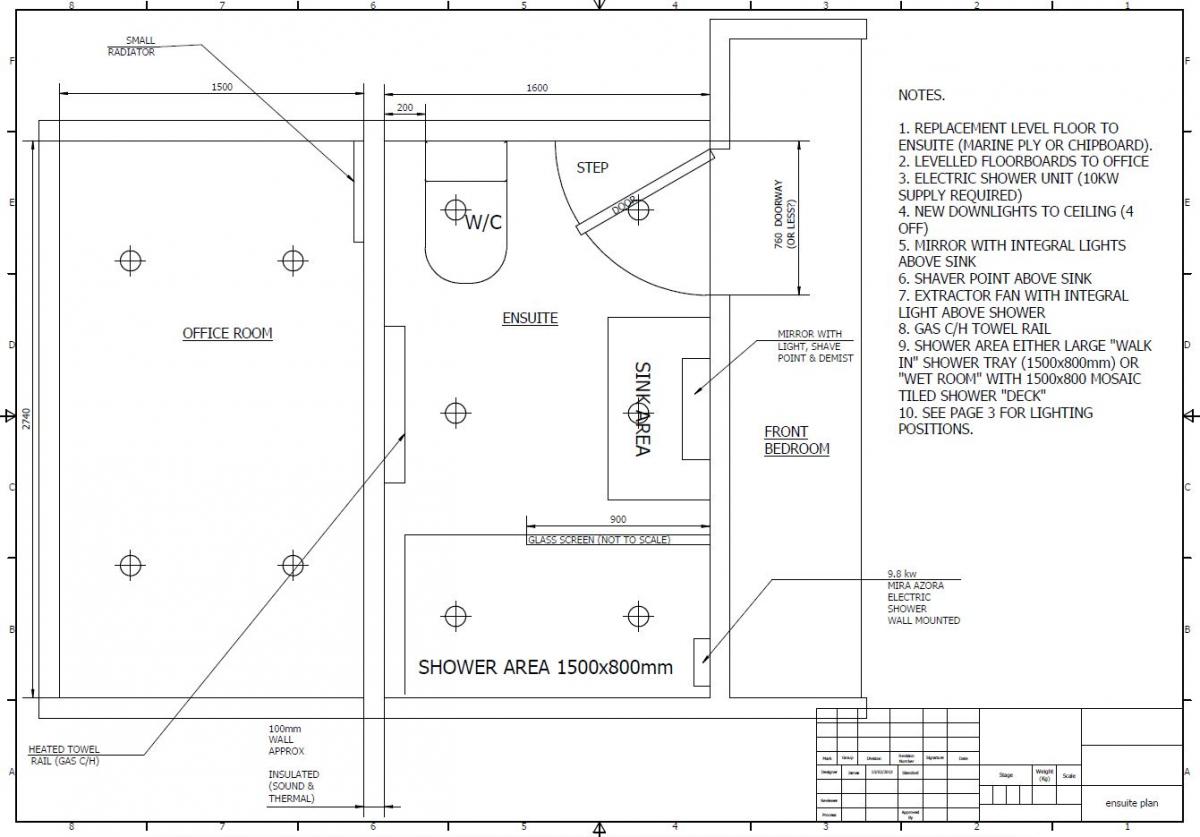

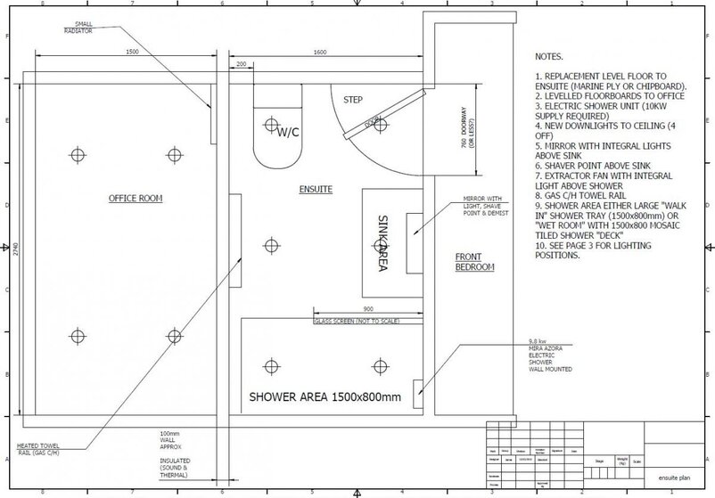

I'm sourcing the materials for an ensuite with wetroom style walk in shower.
Drawing here:
Current state here: (right of photo is the shower area, photo taken from the "office" into the ensuite, bedroom in background.
