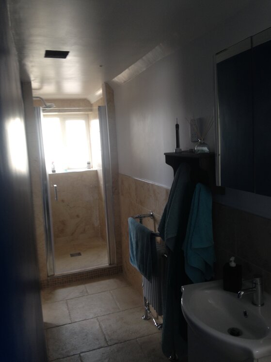

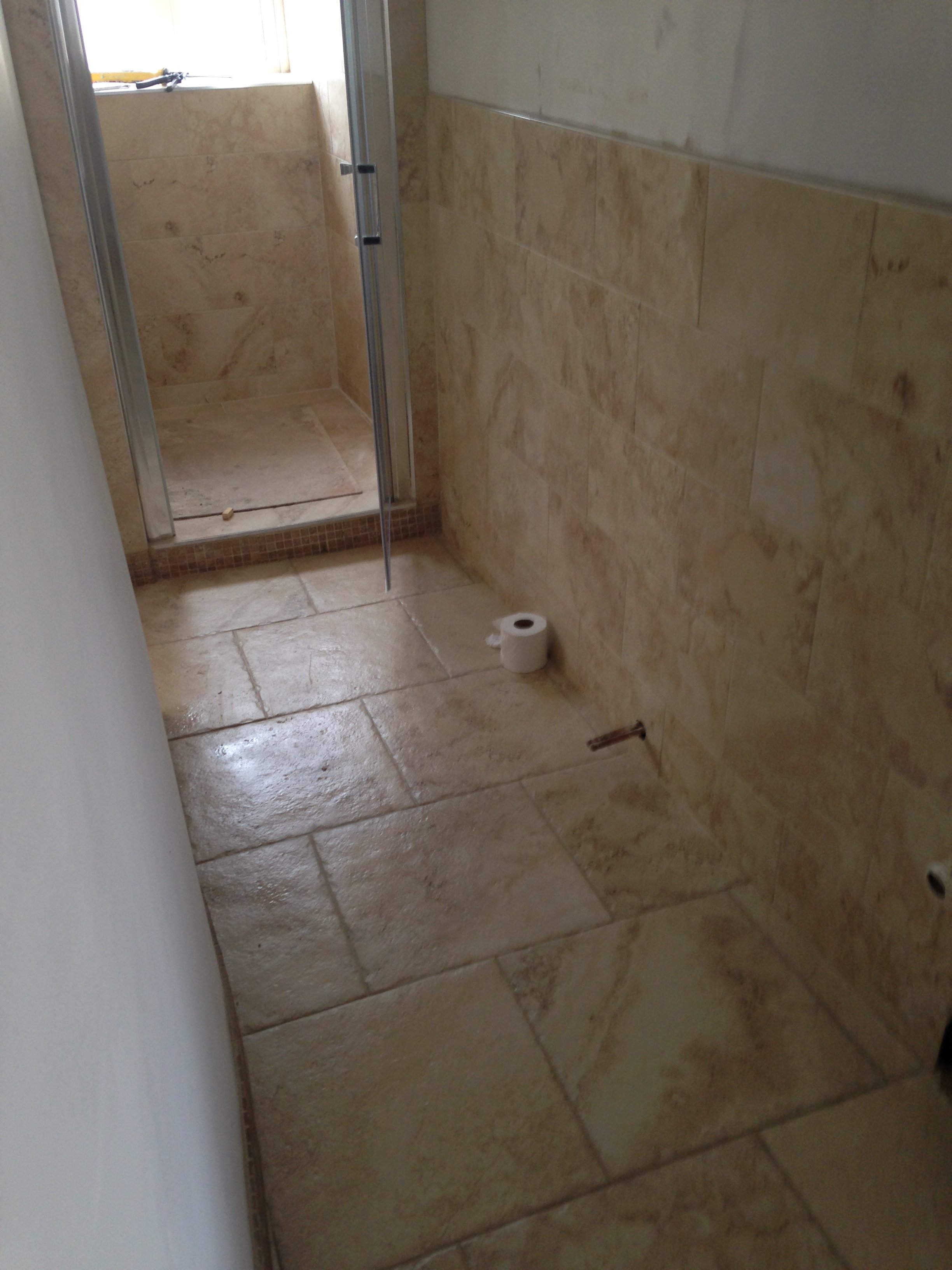

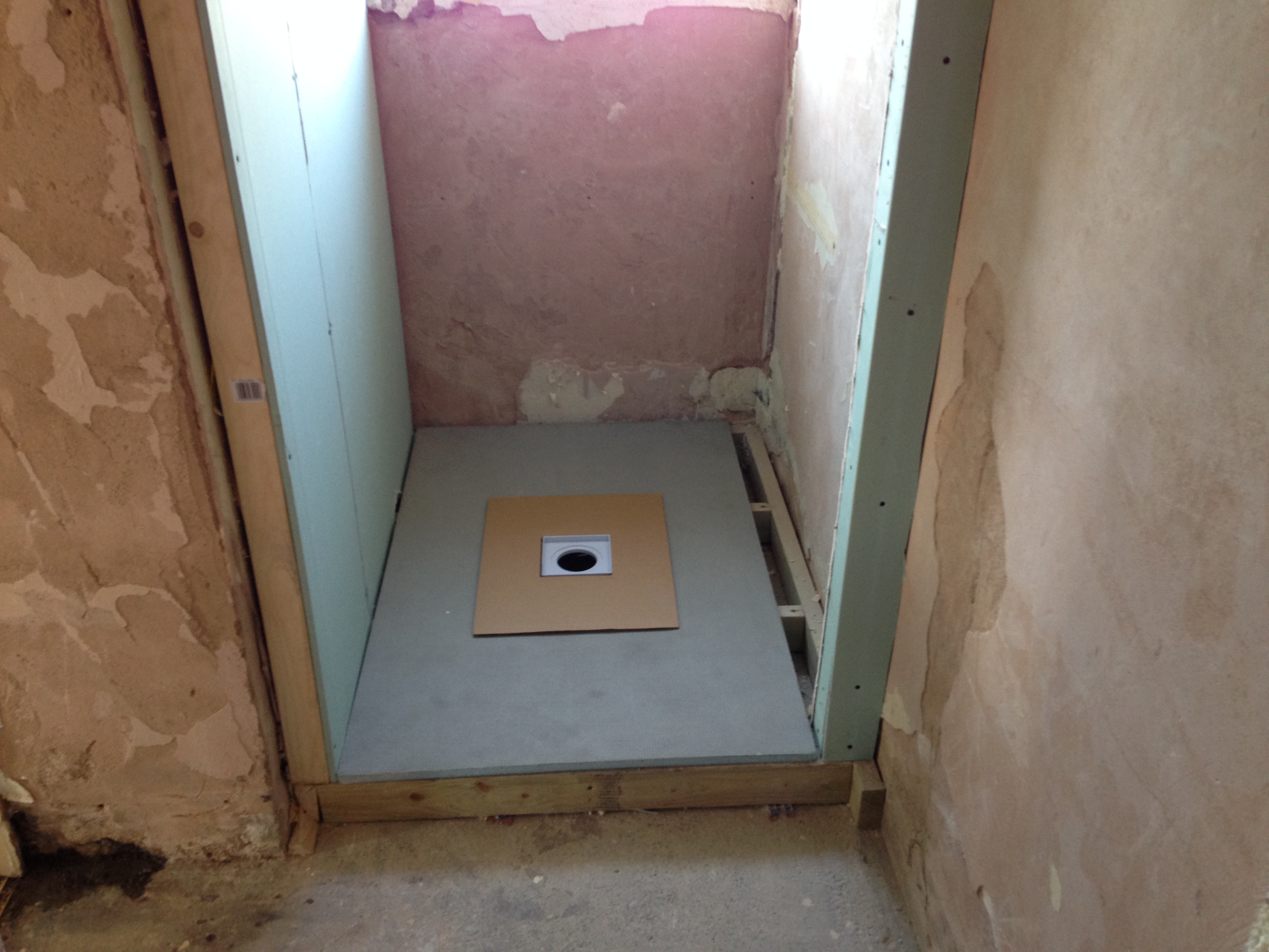

We are renovating our house and a year ago had a wet room flooring fitted to the shower area of our downstairs bathroom. It was fitted by a professional tiler and with a complete wet room kit. It was all fine until about a month ago when we noticed water creeping up through the grouting of floor next to the raised enclosure.
The tiles are travertine which we have since been advised can become porous over time. We have proved the drain and are confident it all the pipework is sound - the water is not a great deal, its just a small amount. If it was the drain/pipes, I'm sure there would be more!
We have also scraped out the sealant and re-sealed, this didn't work. So we removed all the grout and re-grouted with flexible grout and allowed sufficient time for it to dry. This didn't work so we brought a spray which claimed to put a waterproof layer over the surface of the tiles to prevent water ingress but tried to use the shower this morning and its still leaking.
I'm at the end of my patience and we are verging on having to take the flooring up to refit but wanted to see if anyone had any other suggestions of what the issue might be? I've attached some photo's of the various stages and again, it has been in for a year with no issues until now?

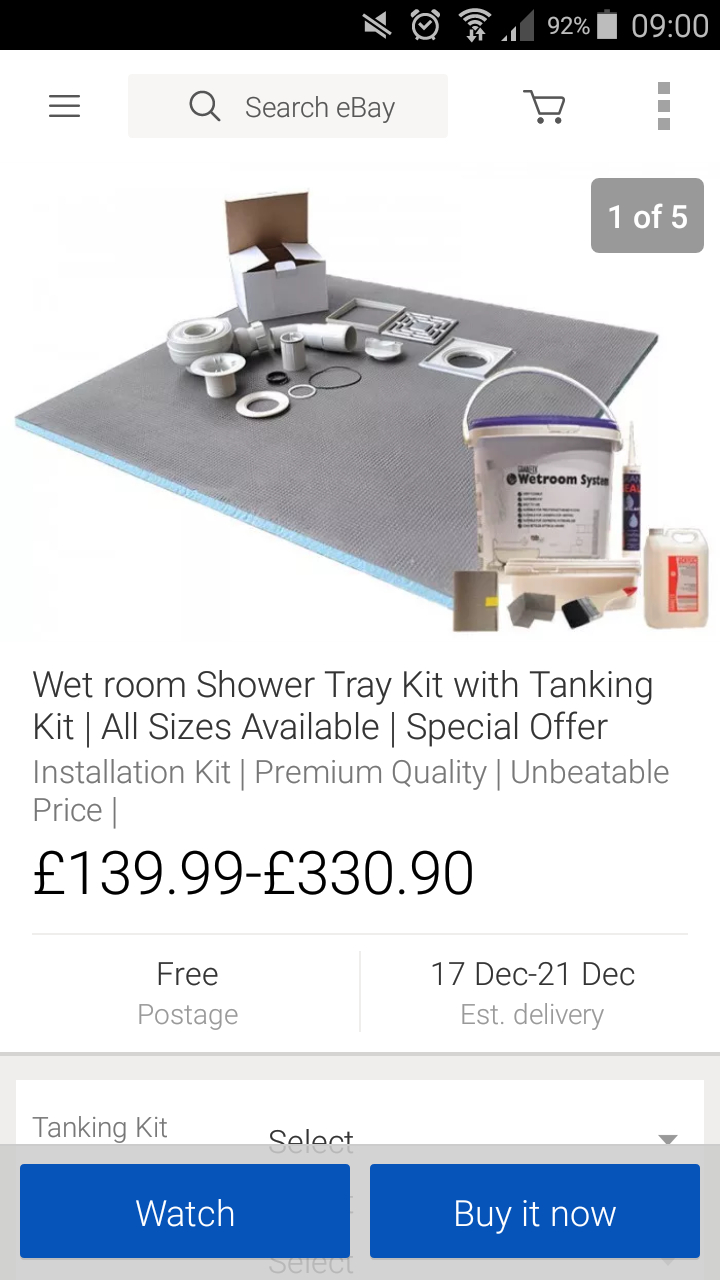

Could be so many things. Likely causes are poorly supported tray causing excessive movement and allowing water through. Possibly excessive movement around the waste, can cause leaks there. Photos of where the water is seeping up would be useful. Out of interest-do you know what brand the tray is and the 'wetroom kit'?
H
Holly Thwaites

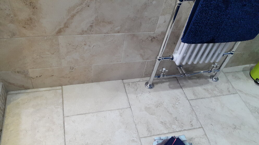

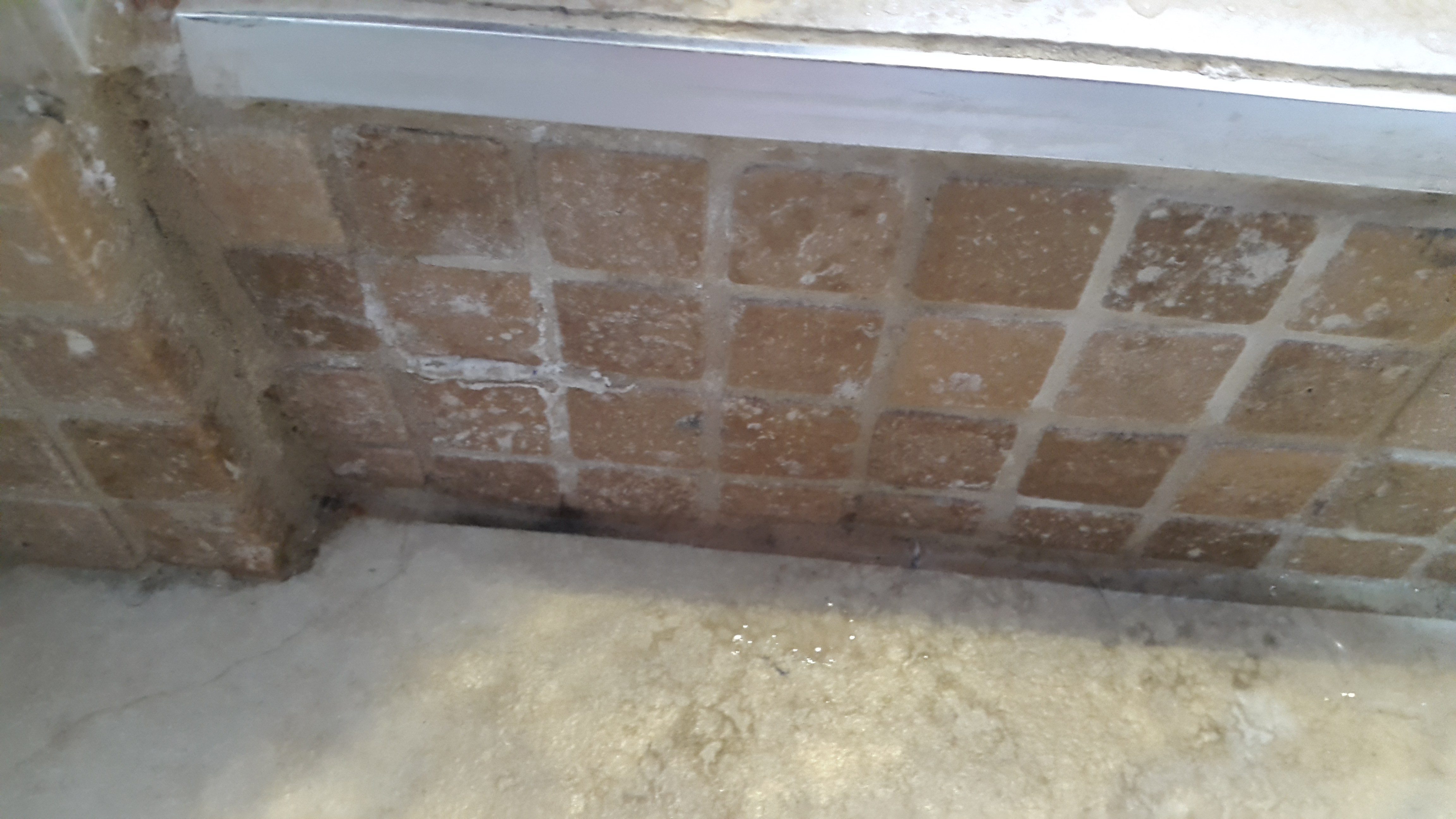

Hi, We can't remember exactly which kit we brought but its very similar to the attached screenshot if that helps. I've also attached some photos of the water. It definately doesn't come over the lip of the door whilst you're in the shower, and just to be on the safe side we fitted a strip of rubber seal to make sure that doesn't happen. We have watched it seep up through the grout on both the left and right of the door and along the bit between the floor and wall tiles along the right side - even as far up as the furthest radiator bit on the floor if you're in the shower too long!

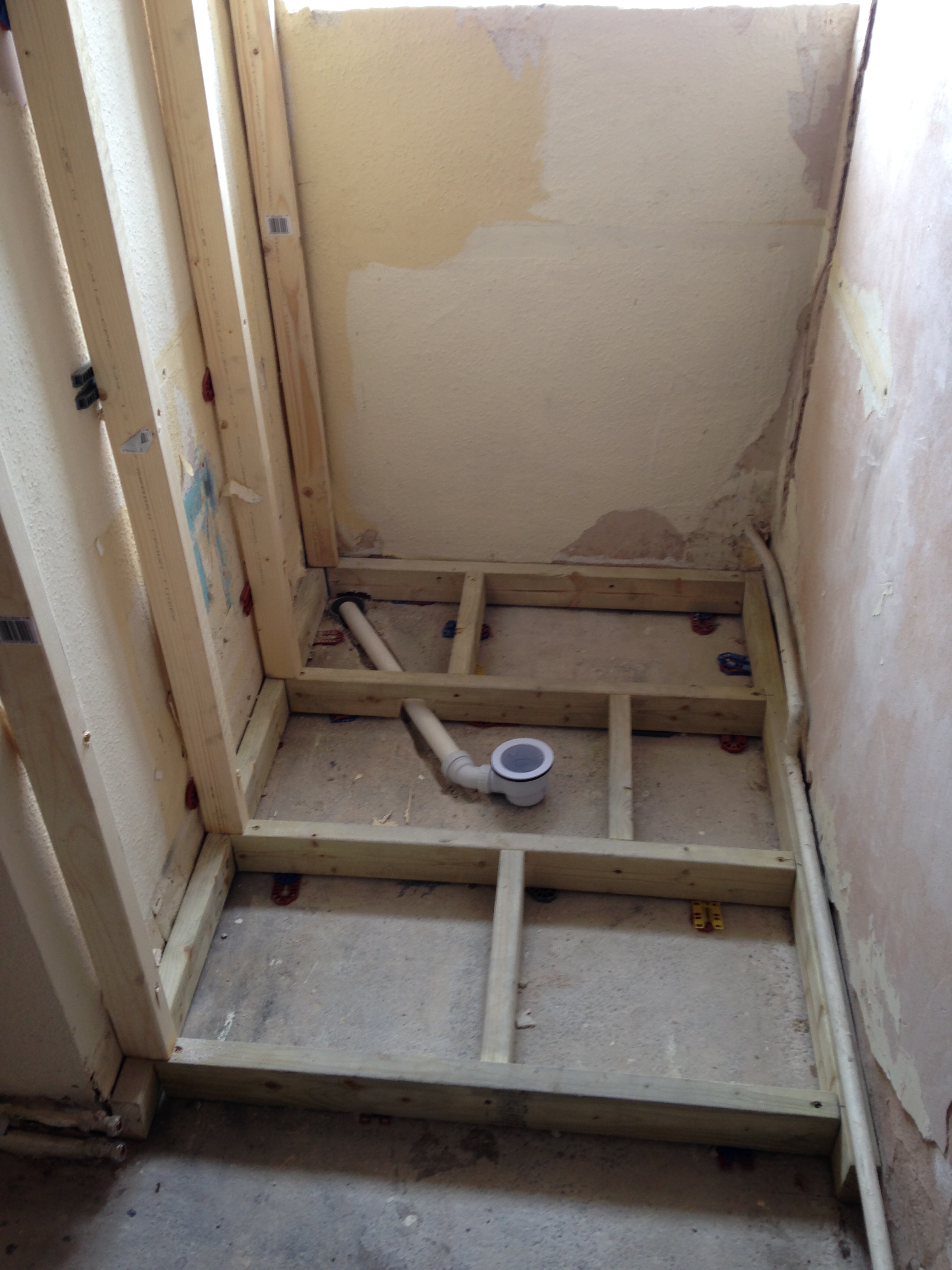

How about taking a tile off the front, drill a hole through the batton and use an inspection camera to have a nose around? If you don't know anyone with one you can get them pretty cheap from aldi now and again - might be a cheaper option to start with than a complete rip out.
SJPurdy
When I have fitted similar "insulation board" type shower tray formers the instructions stressed how important it is to make sure all the perimeter of the tray is supported by timber noggins and that the area around the waste outlet should also be supported by, at least, timber noggins. Maybe your board is a stronger type that doesn't need them or they were put in after the first picture. However if this was the problem then I think that you would have a reservoir of water trapped under the tray continually leaking rather than a leak that only occurs when using the shower.
When in use water can get into the shower door end channels/supports. For this reason it is often specified that the base of the shower door assembly is sealed on the outside but not on the inside; so that any water that gets into the door assembly can escape inwards towards the shower. If this area is the problem then it should b easier to check - with everything starting dry; use the shower with water splashing on to the door - an observer outside will be able to see water leaking through the door assembly.
