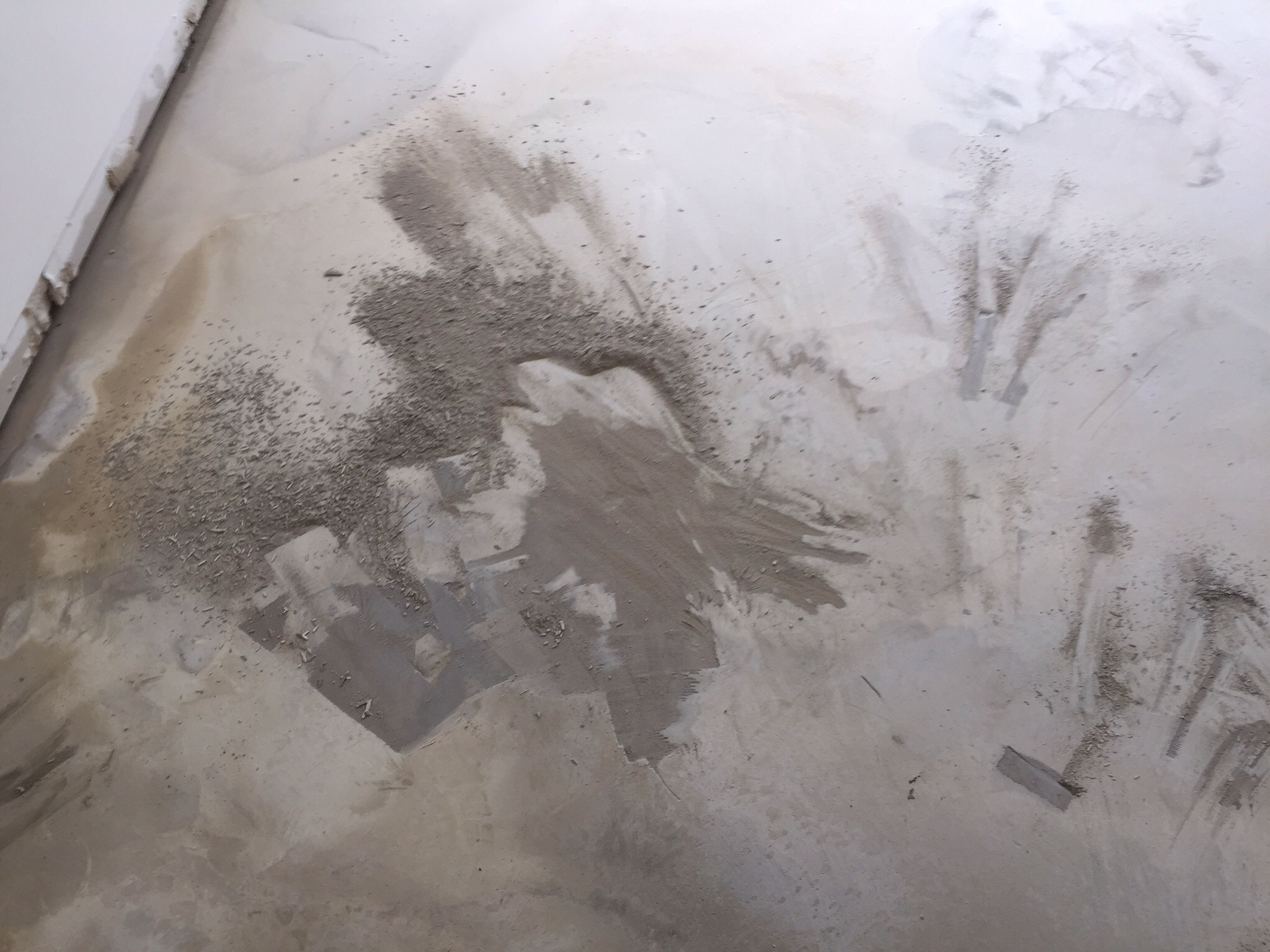

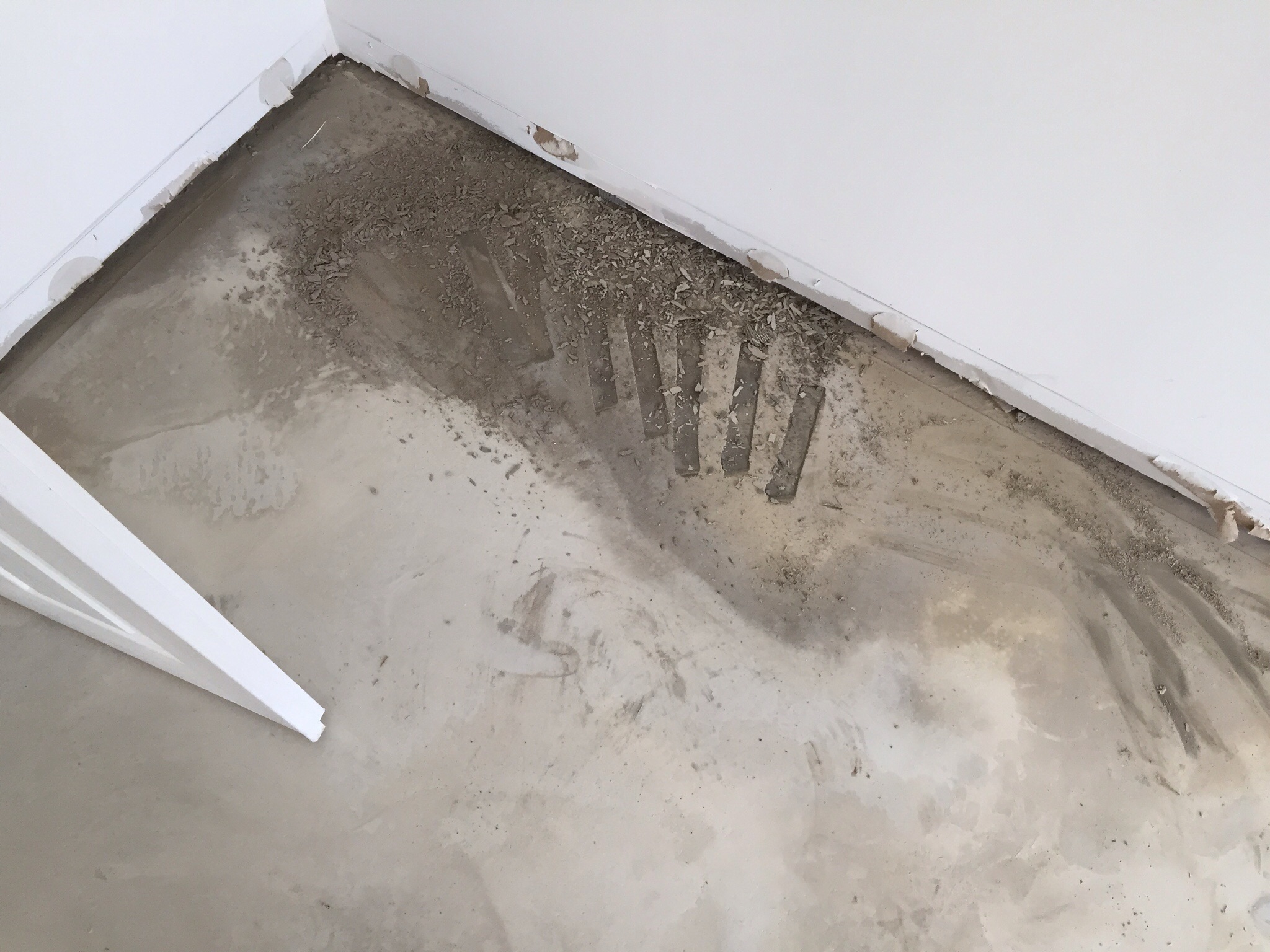

should of used tile master 30leveler there daveI've learnt to not let house builders level floors... It was mixed that wet , it didn't consolidate and just a powdery top as you can see and slimy where water was sat for over 3 days. View attachment 76218 View attachment 76219
