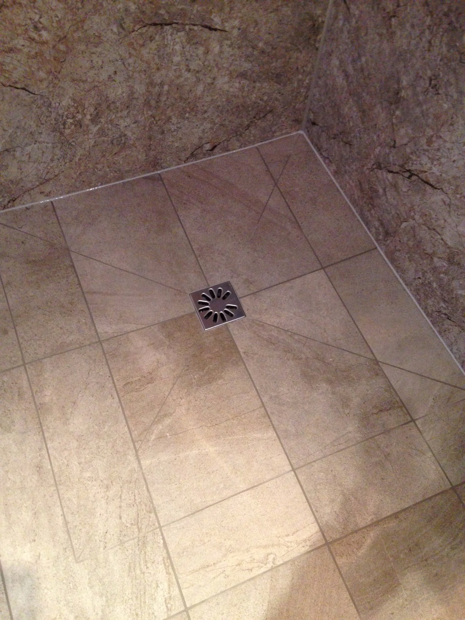

AndY mac
This one done on Thursday with grout 3000 natural grey. Grout was still fresh when pictured.
