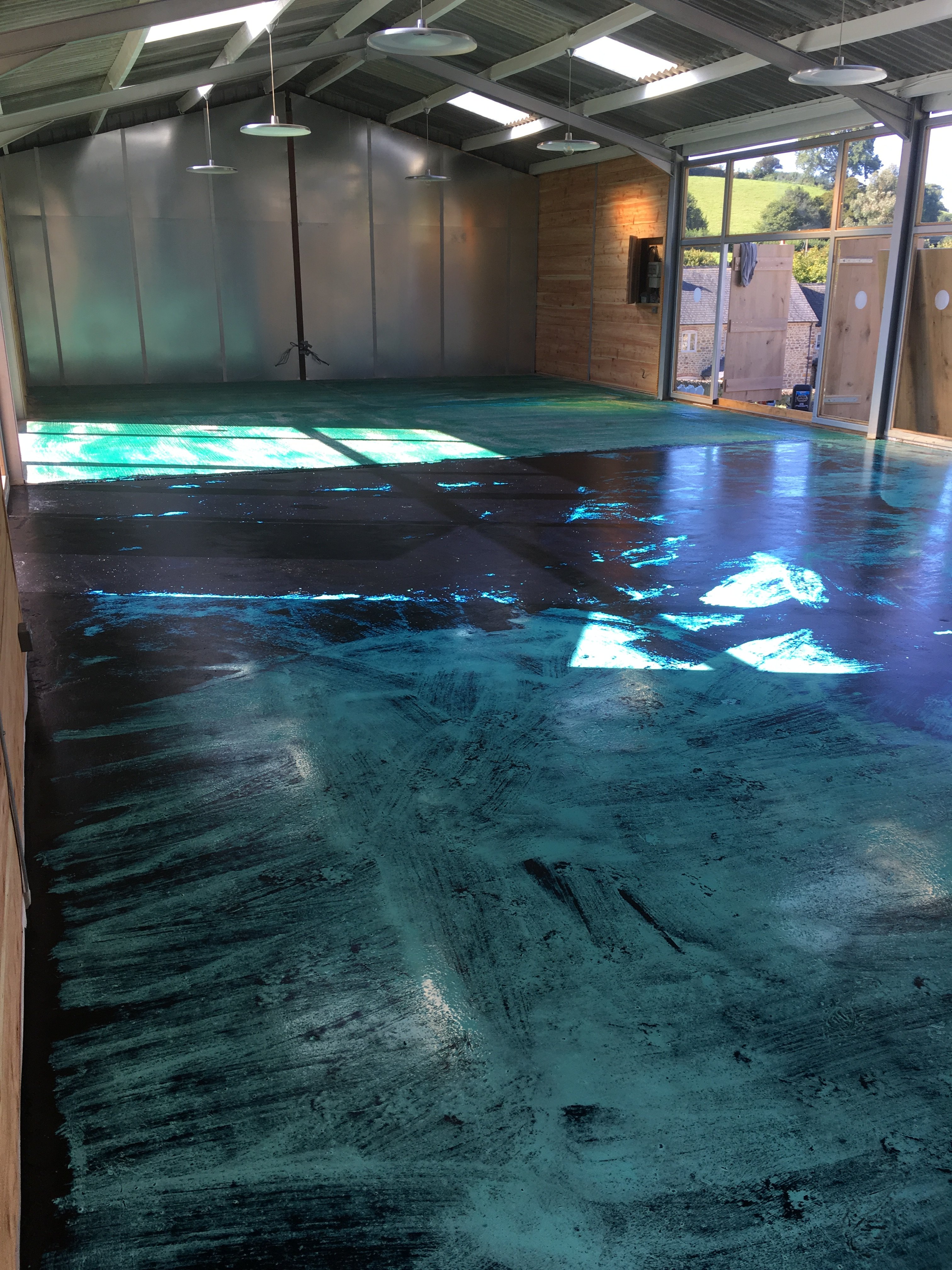

ive been asked to screed an existing concrete floor in a barn that will be used to host weddings and will receive a lot of heavy traffic , chairs, tables , bands ,high heels etc etc....the screed once I've laid it will be painted. I have seen that ardex k80 could be my weapon of choice, but I was just wondering if anyone has any more thoughts on what I could use or has any past experiences. I'm going to primeplus the floor beforehand or even go for the prime + grip. The area in question is about 175 sqmt.

Update to this thread got the barn floor screeded today, used levelflex from tilemaster. 100 bags ordered 95 used ! I'm knackered :confused:
