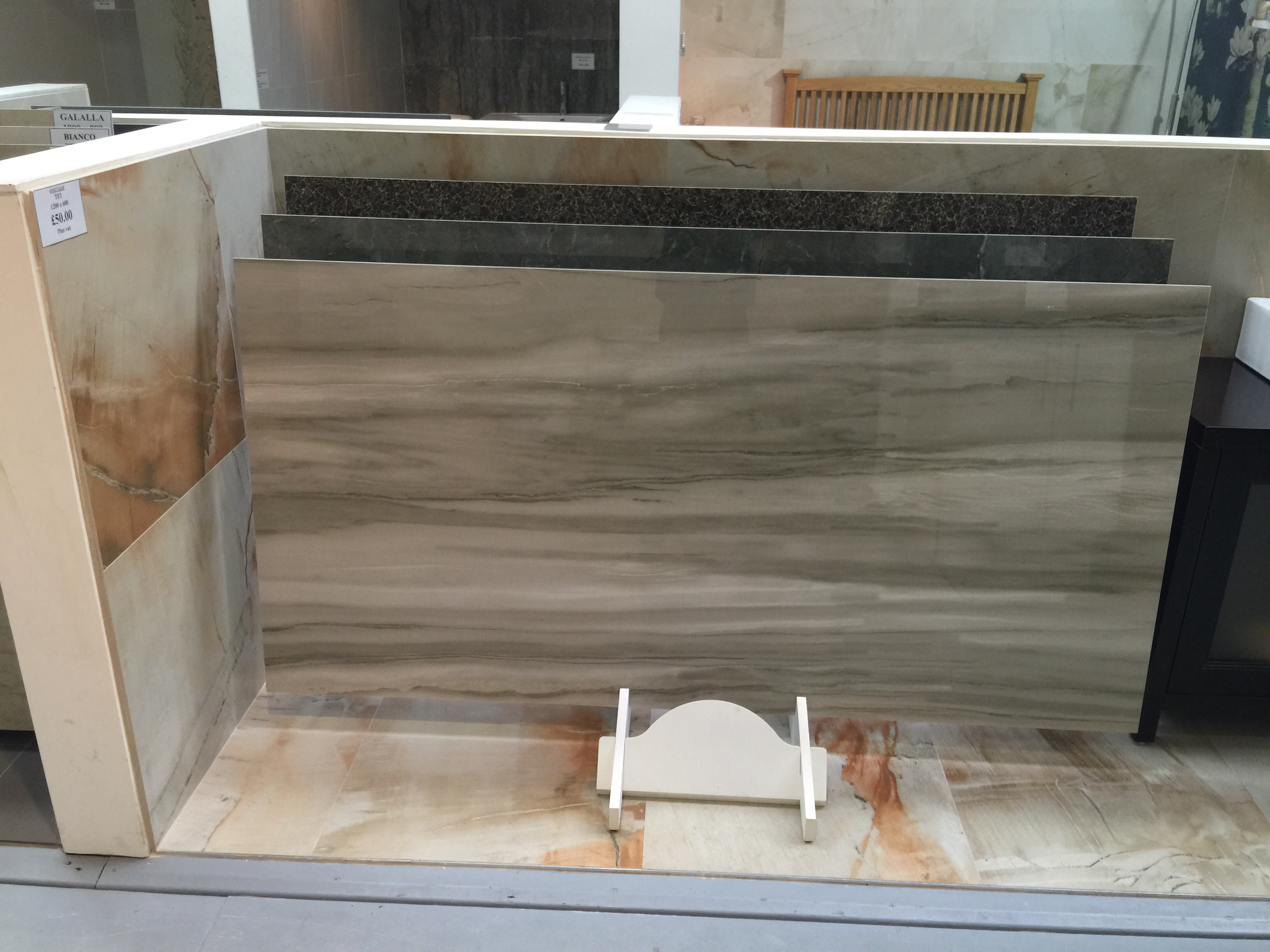

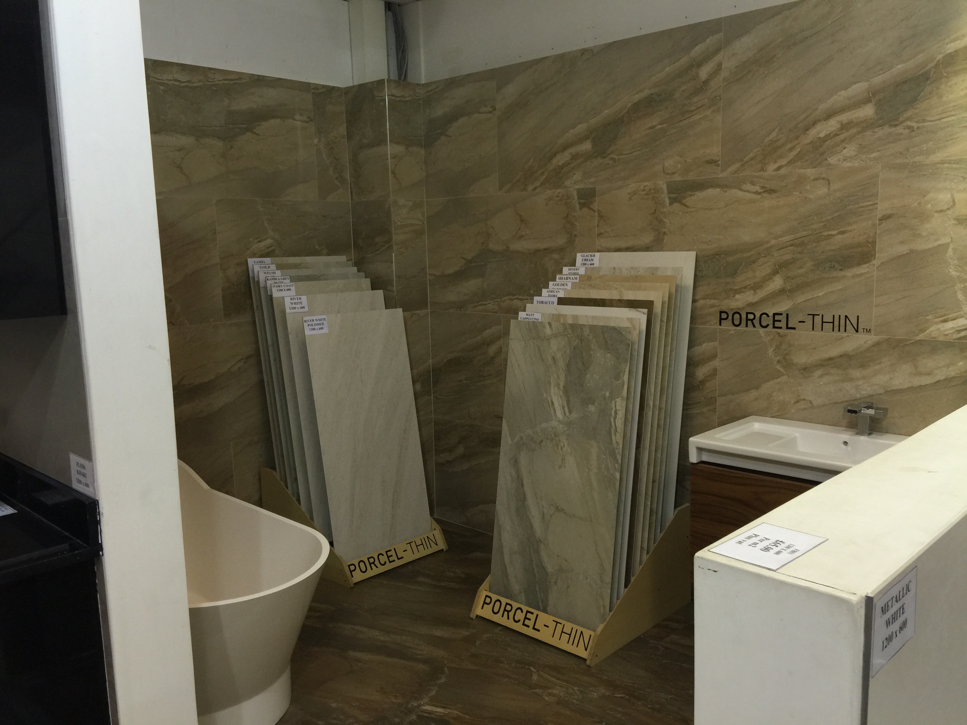

If you're genuinely concerned with weight issues, and are considering tiles as an alternative, why not choose a 3D printed Marble Porcelain-Thin?
The manufacturer is a member here and here is a couple of examples. Standard format is 1200x600, other sizes are available,
i.e 900x900 & 1800x900
.....and what's more they're only 4.8 & 5.5mm thick respectively
Then you could have Architrave's, skirtings and whatever else takes your fancy in the real marble, if that's to your taste.
This first image is just to put their size into perspective.

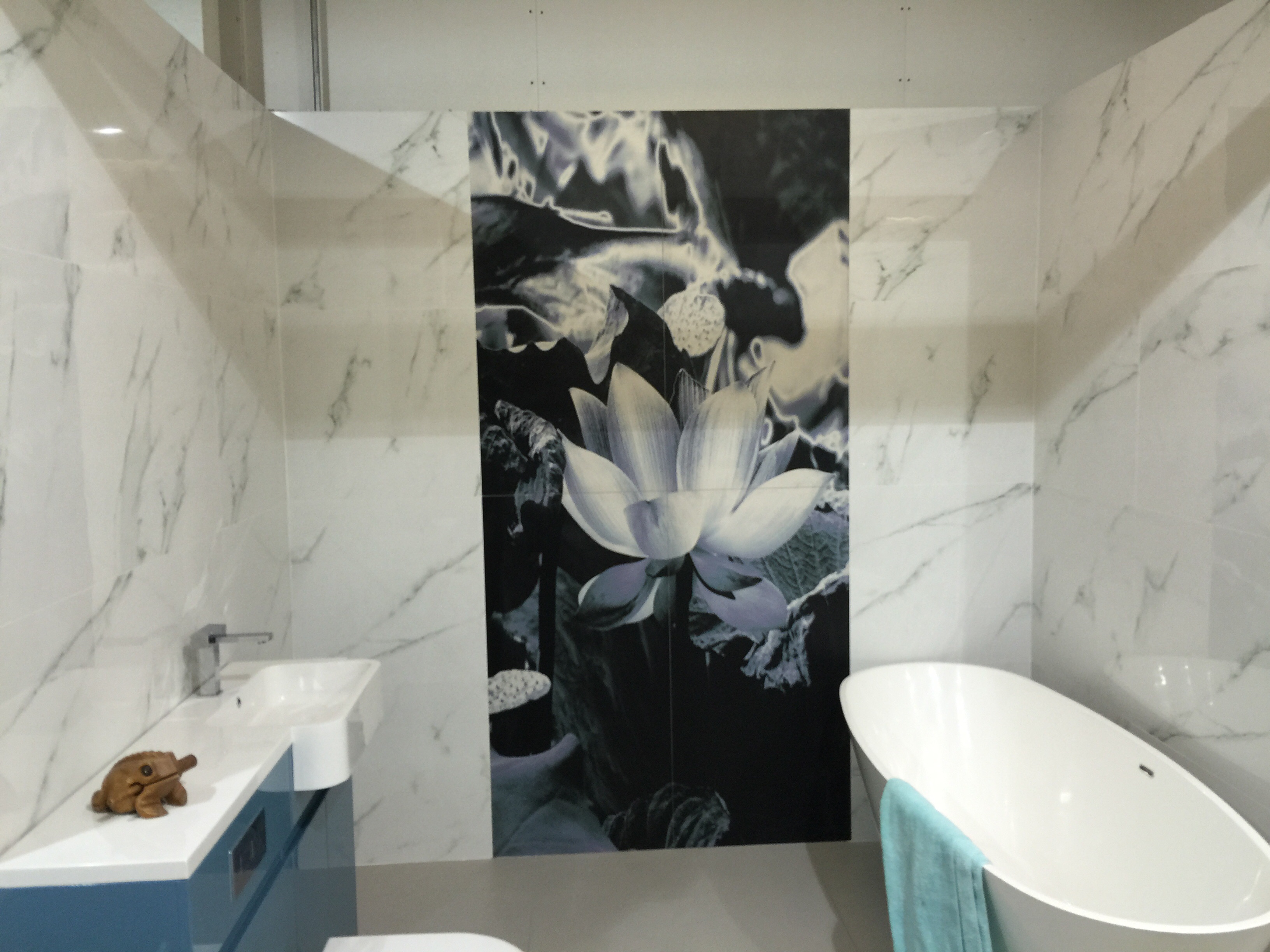

......and so it goes on, a massive selection of designs.
Of course the designs vary from what u see here to basic bold colours.
