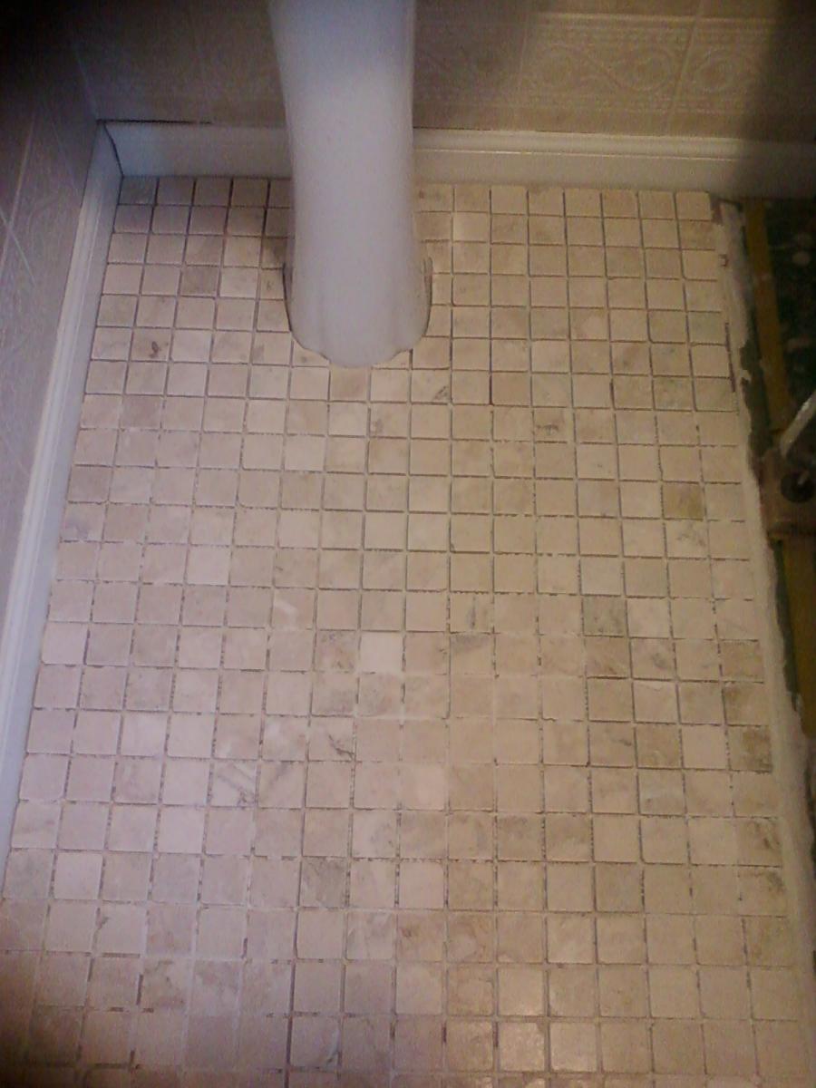

Oh I see.. You should post up some pics, it'd be interesting to see it coming together ;)
Here are my efforts so far, apart from a few tiles with a bit of lippage I am pretty pleased with the result. I guess a beige grout would be the way to go?
