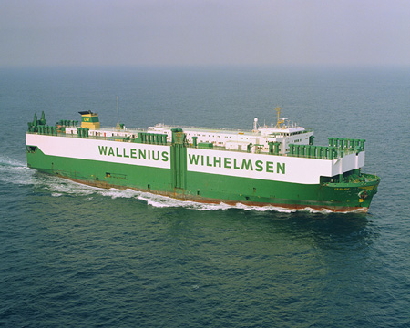

Thank you Dan, for opening the thread. Here is one of my referencies from one of my clients.
The work was anti-slip floor tiles in the kitchen, dining area and climated food storage room on a big ferry for ~ 5000 cars (no passengers). The ferry was in a dock for several repair works, the ground was new concrete screed on pressed glass mineral wool for isolation purpose and vibration noise reduction.
When the tiler intended to start, the responsable engineer explained that the concrete got cracks as the concrete maker included the wrong steel bars, too weak. No time left over to replace it as the ship has to leave the dock in 4 days. But as the kitchen equipment also needs to be set to its place and to get ready in function the netto time the tiler realy had was 2 days and ½ night.
The tiler took a decoupling matting type Panther QE 10 and sticked it to the cracked ground with my C2TE S1-adhesive Nordas WF 4, on the QE 10 he layed with the same adhesive the tiles and grouted with a flexible grouting.
It was only 180 m2, but due to the lack of time, the cracked ground, other works like tile cutting and getting everything on and off the ship (which is about 14 floor levels high) he had to work with 3 persons day & night. He made a good and fast job and kept the time, he got 7 more ships in contract to do it this way.
Best regards and hope to see your site difficulties story, Martin
