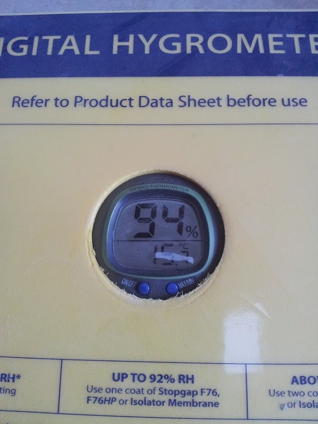

Firstly the Hygrometer was situated and left to acclimatise . I continued cutting the architraves off and then sand the floor.
After a while ( 3hours ish) the Hygrometer was switched on and a reading of 86% RH was given. I hoped this would drop as the day wore on. It did indeed and dropped to 83% by the time I left site. i was all ready to get laying Tuesday ( today ) but I wasn't expecting the Hygrometer to read 94% RH when I arrived this morning.
I have called the client and I guess he isn't having a good day either as "words" were exchanged and it wasn't pleasant ! Phrases like "cant you just do it" and "No other tiler made any comments", " I need to move in"....I explained why I could tile the floor in this condition and was met with the old " Just do it and if there are problems later I will deal with it then"... I explained that "If" there were any problems his first call would be to me and he would be demanding I sort it out. ....Now the thought of lifting 45m2 of porcelain, replacing the tiles and labour , the removal of plinths etc sound very expensive to me.
All the client is thinking about is moving in and he just wont listen to anything I either say or refer him to...ie the data sheet of N&C Gypfix or any details of Anhydrite screeds.
So the outcome is , I return to site tomorrow while he is there and take plenty of printed material. Tell him that I will only do it when it is ready.
With no heating in the house , I cant see it drying for a good while yet.
