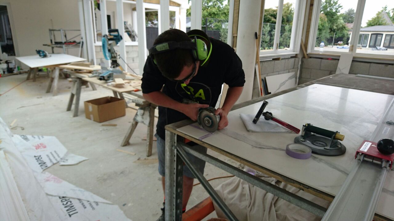

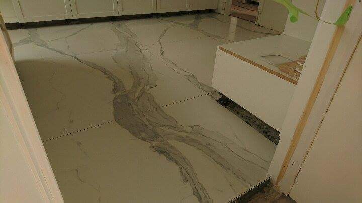

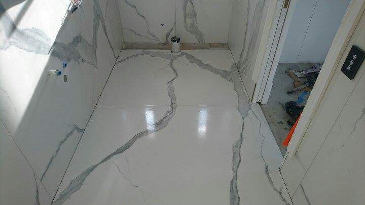

@3_fall is pretty good with huge tiles ;)
Apparently your adhesive choice and mixture is important. And perhaps using some kind of levelling system. You need to guarantee 100% coverage still. Which is very hard to do with such a large tile. Apparently doing a sloppier mix is the way to go.
But like I say, don't listen to me. :)
Italy
Yes I did! :p
