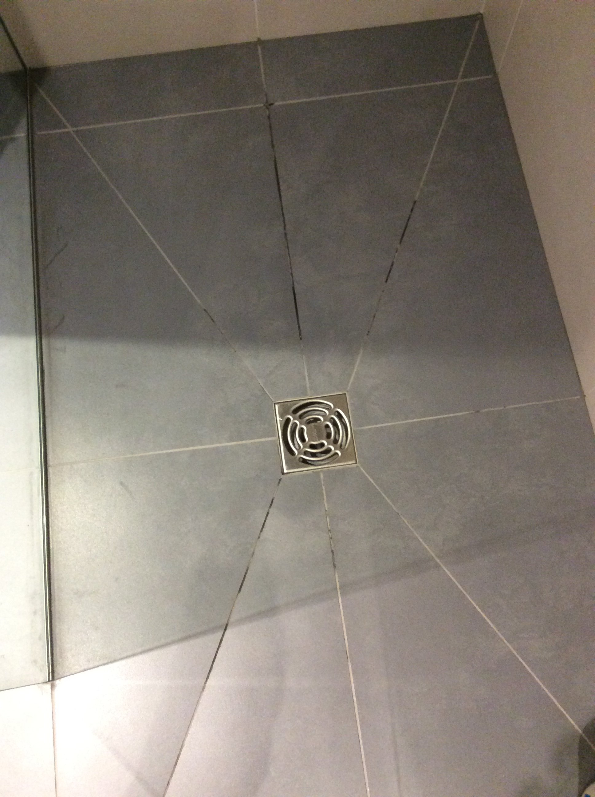

Hi there new to this forum and thread. I stumbled across it looking for answers to a similar problem with areas of my grout in a new wet area. Did you ever find out the cause of the leak?? About to tell my builder to carry out checks on the plumbing in the cavity wall. The wet areas are patchy but spreading. They occurred within a week of using the shower and have gradually got worse over the past 2 months.
They are damp ( builder used a damp meter to read) but not drying out even with ufh on. The problem is slowly getting worse. The picture shows area 10 hours after shower last used

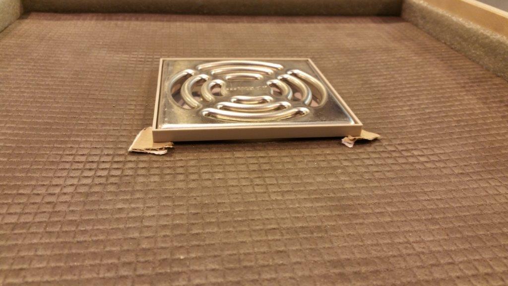

I've seen this before on certain trays which don't have weep holes or any way to allow the water in the adhesive bed to escape down the drain.
If you accept that water WILL remain below the tiles in the adhesive bed, then if that water cannot escape and be replaced by fresh water, bacteria will breed in the adhesive and lead to grout discolouration and ultimately - cement break-down.
I remember most recently a marmox-type tray which most definitely didn't have any means of allowing the sub-tile water to drain. It looked like this: A little upstand all the way around the drain.
Easy enough to tile up to, but how does the water escape?!

Very sorry to hear that you are having the same problems as us (I am assuming that you have read my very long thread!). In fact, I have just updated it and have some (perhaps) encouraging news. It seems that the water that was trapped under our tiles has finally (after 6 months) dispersed, and that no further water seems to be getting under the tiles in the shower area now that we have re-grouted with epoxy and put a good Silicon seal along the shower screen.
I am sure your builder will inspect the grout carefully, and I would imagine they will find some areas where water is seeping through. As long as you are convinced that the grout is not cracking because the tiles are moving (in which case they will have to be taken up and re-laid) then I would suggest asking them to re-grout with epoxy. Just be aware that you may, like us, have several months ahead where you get wet patches beyond the shower screen while the water dries out.

Well they removed the grout today and then reported back that it was dry underneath the first few mms of "wet" grout. No evidence of moisture under the tiles at all. The top layers of grout did appear to be somewhat soft in the wet looking areas.
No leaks apparent from the plumbing.
They have re-grouted with the same mapei grout and advised me to keep them posted when we start using the shower again. I will post again with results

it's water stuck under the tiles!
these type of trays trap it against the drain assembly. if this type of drain is used, best to use epoxy grout and Silicon around the drain.
i guarantee if this tray is used more than once a day, it will get worse....

the only ones i've seen which drain sub-surface water are schluter's ditra-drain.
it's a problem with design which is only just starting to become apparent in the UK.
Most manufacturers have a head in the sand attitude unfortunately.
The US and Aus have sussed it long ago though.
