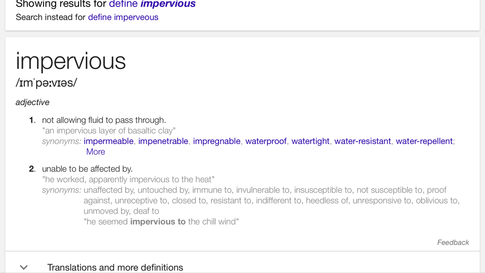

First of all: WATERPROOF vs WATER-RESISTANT
I honestly want to bang my head against a wall when this comes up.
1) Waterproof means water cannot get past the board.
2) Water-resistant means ONLY that water will not damage the board's integrity.
BUT - water can still soak through the board to the background.
