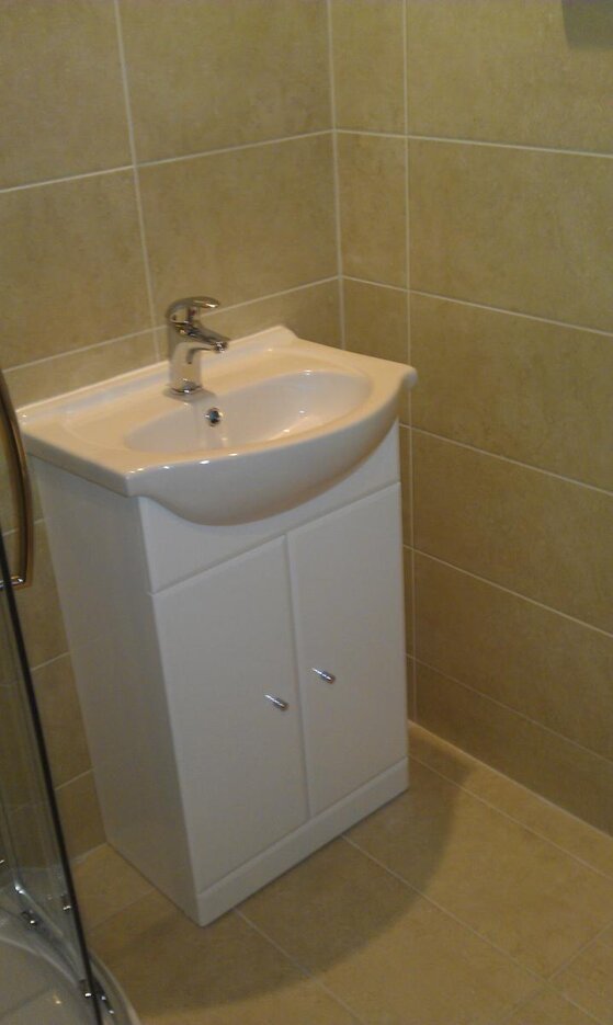

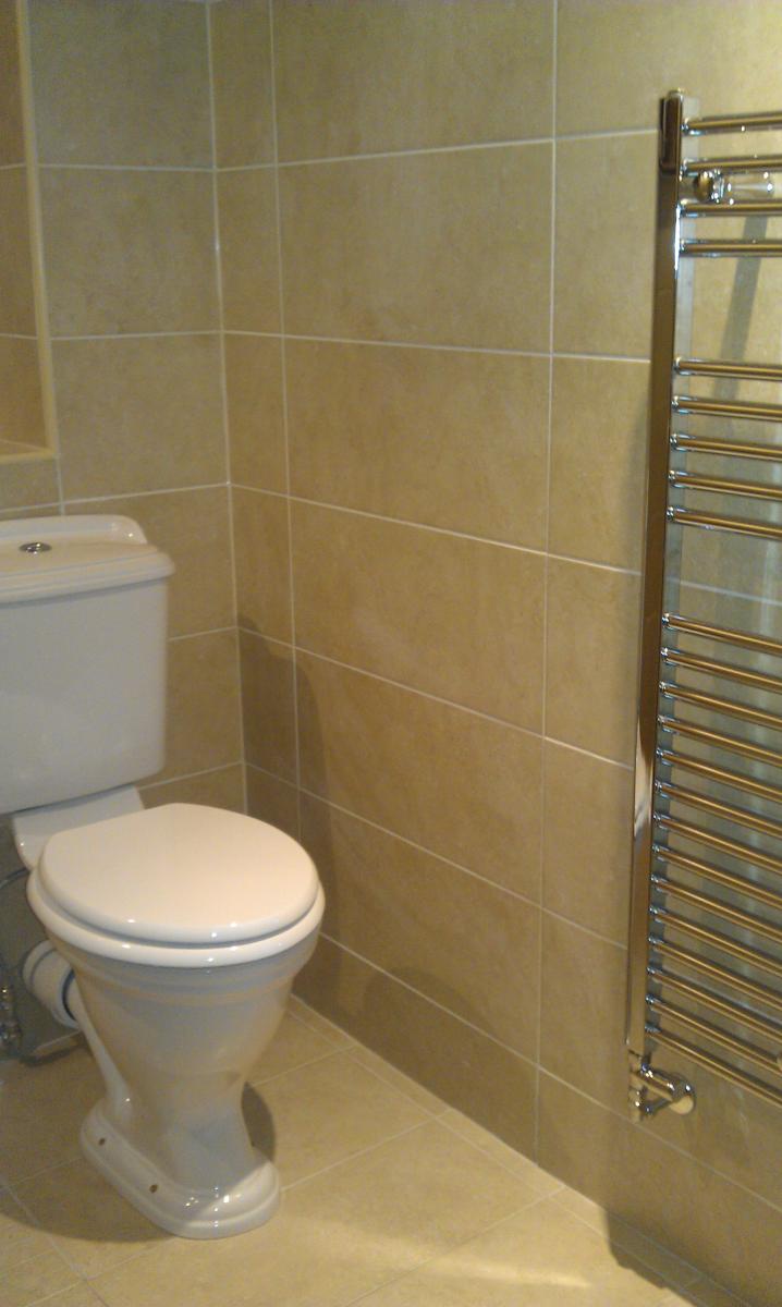

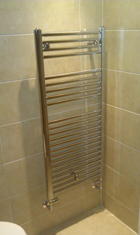

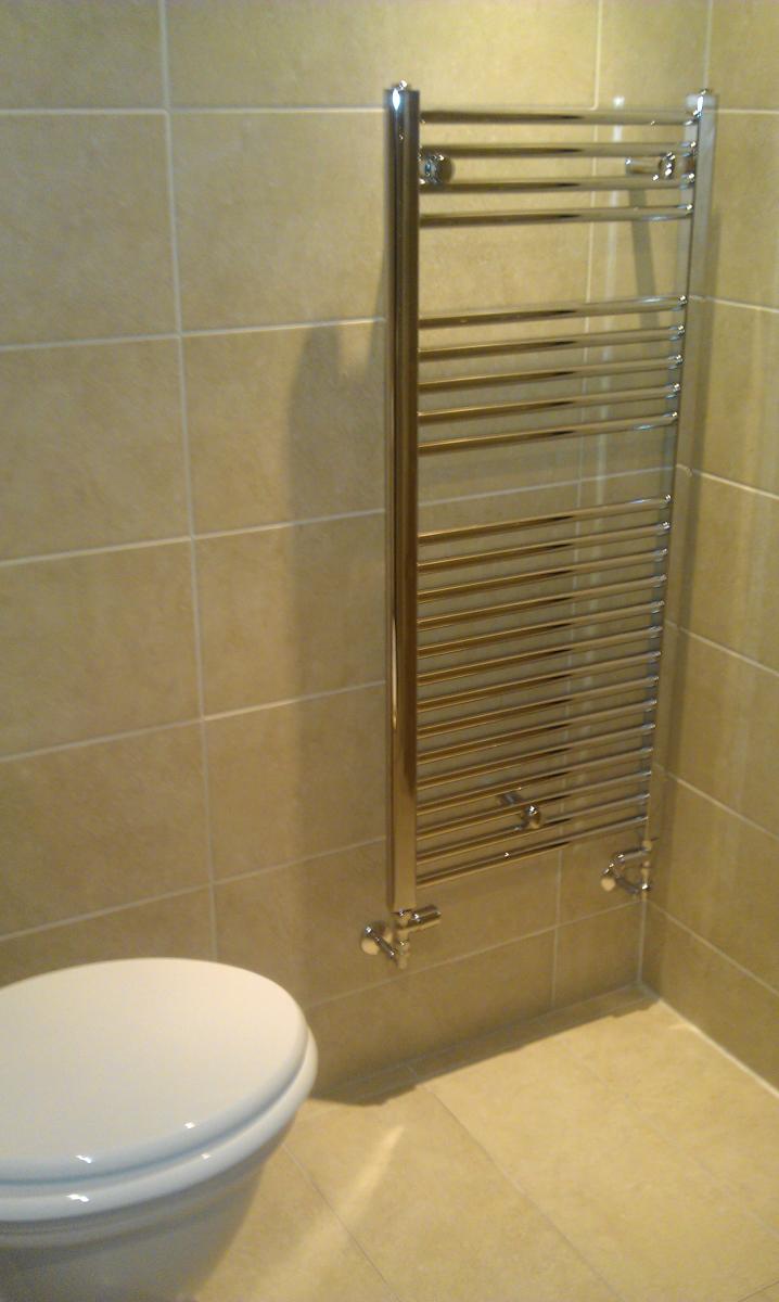

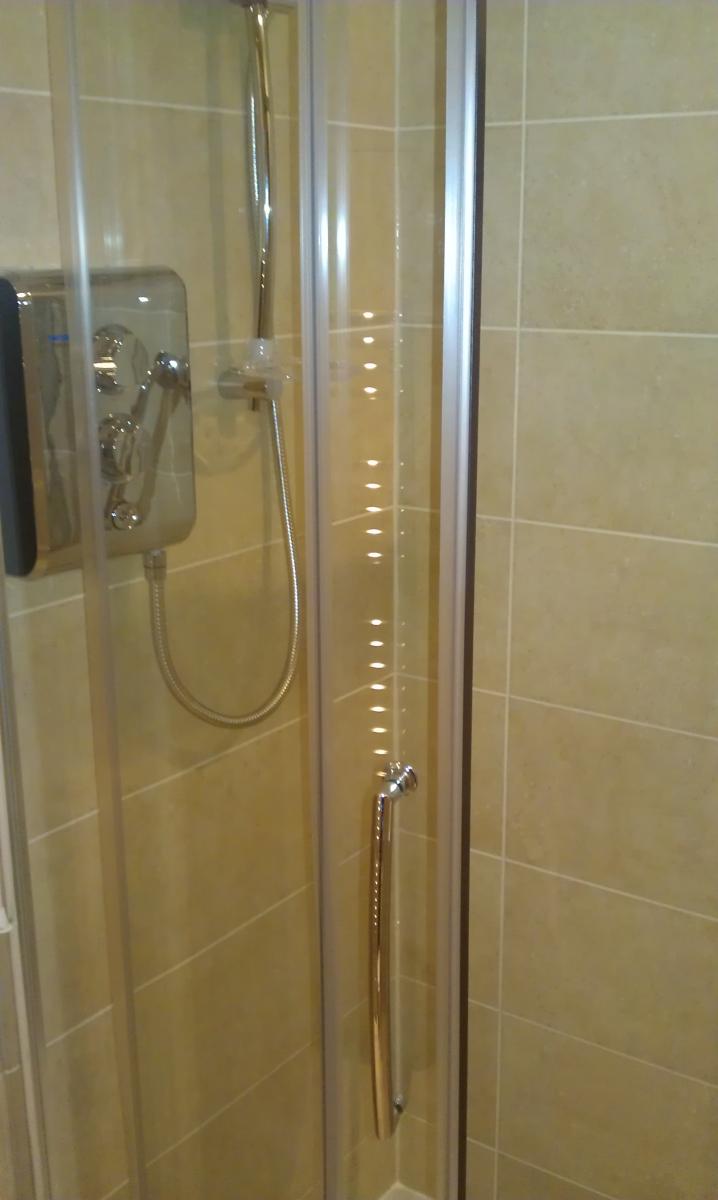

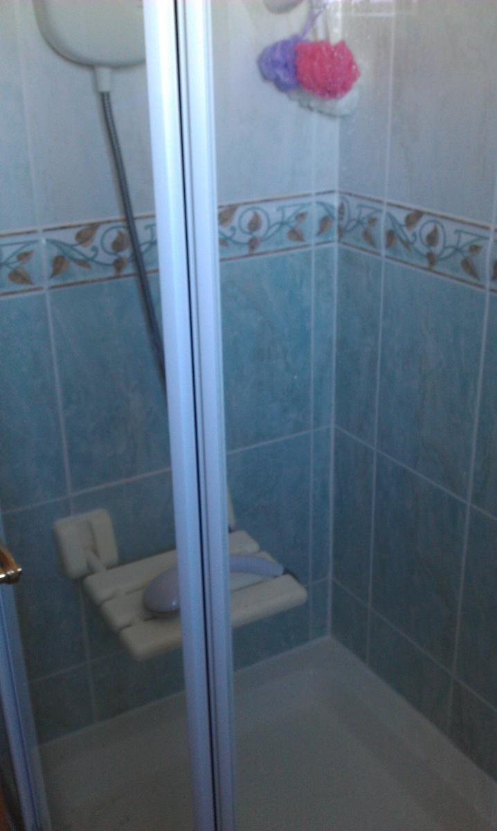

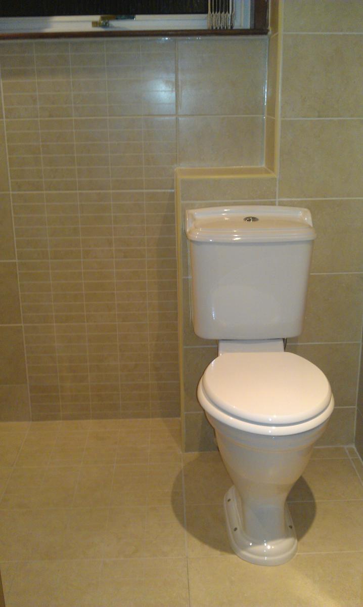

Here's some pics from my first tiling job after I completed my 2 weeks course at NETT(UK Trades). Stripped everything back to stud partitions and re-sheeted with water resistand gyproc.
This was primed with BAL SBR primer and the shower walls were tanked using BAL Waterproofing kit.
Used cement bagged adhesive with 8mm trowel and then used BAL ivory grout.
I had never tiled in my life before my course and it is the in-laws bathroom and was a 'thank you' job to give me some practice...I even managed a 3 way mitre
Would like to hear the feedback from you more experienced tilers on here if you would have done anything different....setting out,materials used etc.
